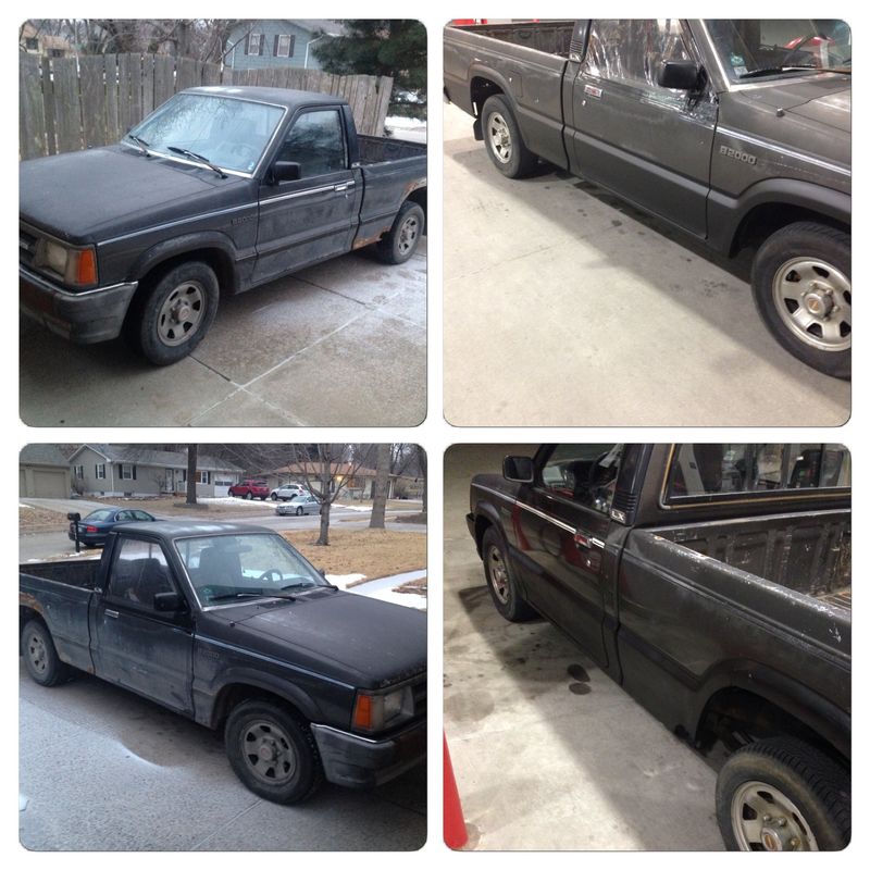

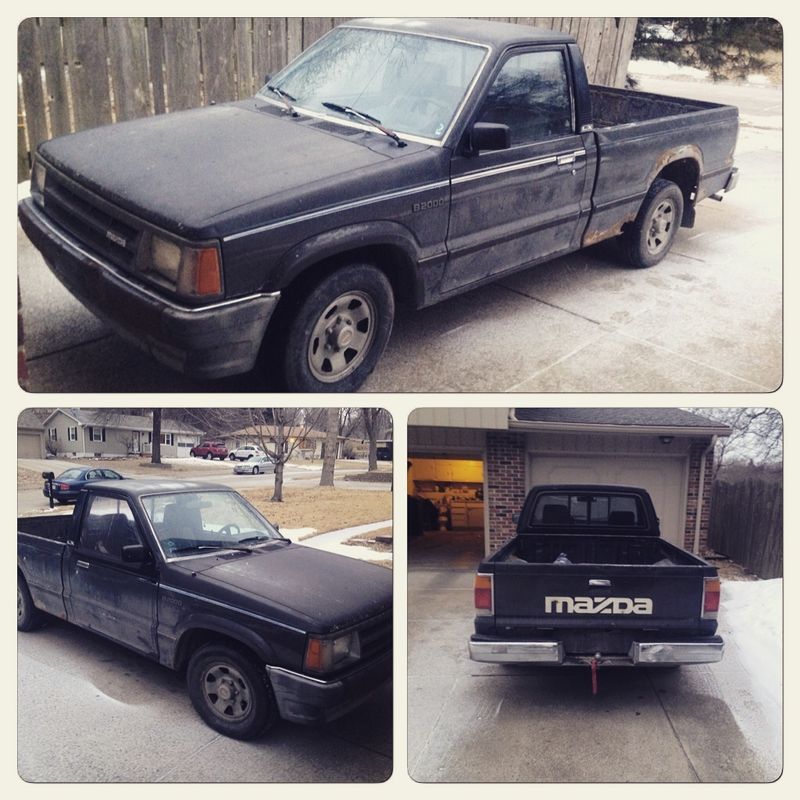

Just picked up a 1986 Mazda B2000 LX Short bed with 175k miles on the 2.0 engine. Its a beater, in fairly rough shape, corrosion and lack of vehicle maintenance has taken its toll that is clear. The engine sounds decent and the clutch and shifter feel alright and the frame doesnt appear to be structurally compromised just some major rust bustin and prevention for me to do.
In the process of degreasing and cleaning up the engine and undercarriage currently and giving it the service maintenance its been neglected for so long. Not sure it was ever washed lol.
Needs a passenger window + regulator, Gas tank (if i cant repair), interior seats, (prolly just cover them), ill "ospho" the frame and undercoat it, then fiberglass the rust holes on the body and cut out rotted sections of the bed to weld in some new bed panels and cheap bed spray, Ill top it off with a good old never fail rattle can spray job and it'll be the perfect little parts hauler/winter driver to keep my other ride off the salty corrosive roads of the Midwest. Purchased at $600 I'm not lookin to make it anything but solid and mechanically functional in the smallest budget possible. Ill prolly budget $400 max but hopefully stay below that while fixin it up a bit.
Wondering if there are any specific problem areas I should focus on and look for? Oil leaks from multiple locations but i need to clean the undercarriage to get a better picture of what I'm working with.

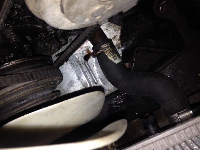

Well I cleaned her up and put it back together. Temp gauge didn't work I noticed when I drove it home after buying and found it wasn't plugged in. Cleaned it up a bit got it working. Radiator hose on top was really soft no pressure at all after running it for a awhile and when messing with my heater knob to try and get heat blowin it fell in....just blows cold air. Should I go with a new thermostat next it should open up and pressurize the top hose after 10-15 min of idle I would think but I'm no auto mechanic. Dunno if I should pick up a new thermostat next or what? I also found traces of oil in my coolant reservoir. I drained the radiator and put new in and I'll get it tested to see if it's a head gasket thing or not I think. Hopefully not but I've seen in here that that is a common issue.
somoteitbe's avatar
somoteitbe
well, got tester for exhaust gases in my anti freeze, accidentally sucked antifreeze into it so had to wash it out and drain more, thermostat seems like its refusing to open so picked up a new one rated at 180 degrees cuz saw a post on here i believe earlier that suggested the 180 degree ones over the 195 since these engines have a tendancey to over heat. After it all cools down a bit ill go tear into it and hopefully get a negative test on the exhaust gas in anti freeze.

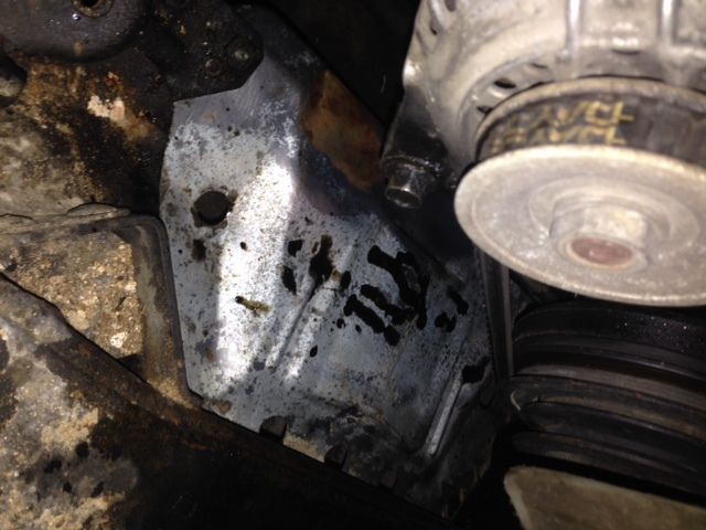

also noticed a leak coming from what looks like the timing housing havent crawled under her yet but glad i scrubbed the skid pan clean and did a good de greasing so i can confirm its coming from there.
my question is if the leak is coming from the timing housing is that a simple fix or is it just as serious and in depth as a head gasket change?
There is also an oil spot below bottom rad hose too dunno where that would come from either...got me concerned... any advise or help is greatly appreciated! i dont want to get in over my head
