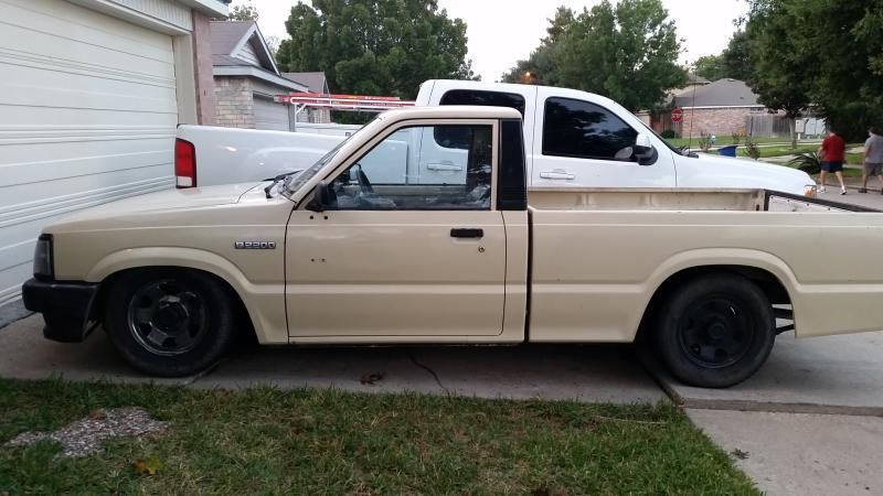

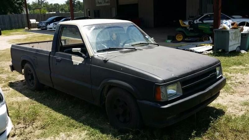

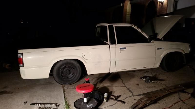

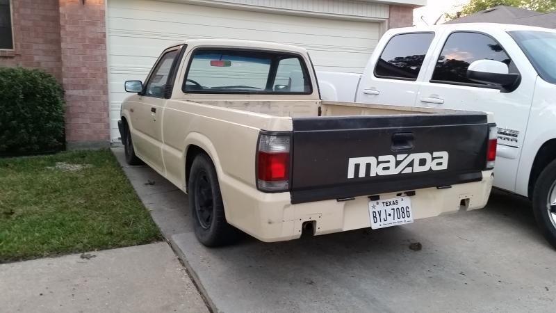

Here is what I started with.

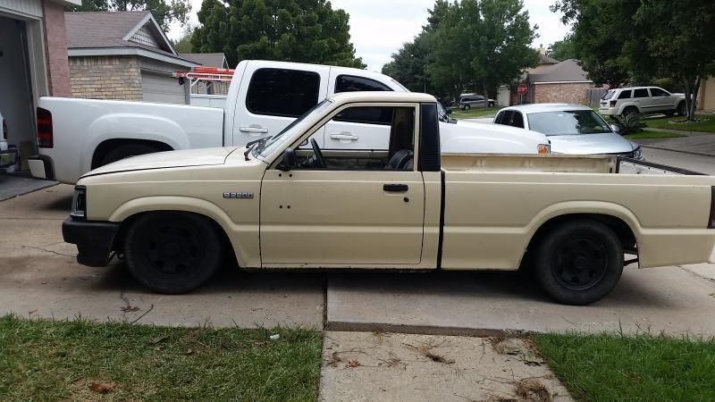

And as she sits now

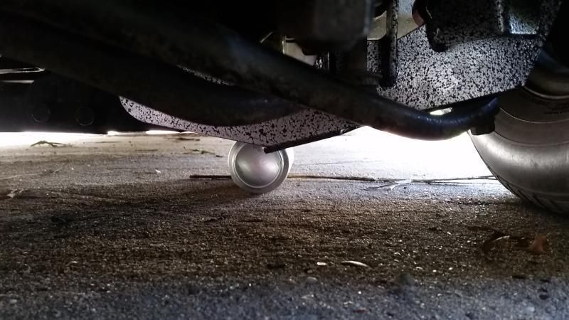

To be honest, I haven't driven on them yet. I chose control arms over spindles because I knew I wanted to run 15-16" wheels and with the spindles, you'll need to run at least a 17" wheel to clear it. After I put them on, the truck is so low that the stock tire is wedged against the wheel well, and it literally won't move. I also "flipped" the ball joint when I did them so I have massive amounts of negative camber.
I realize the picture are terrible, but Here is a before and after.
