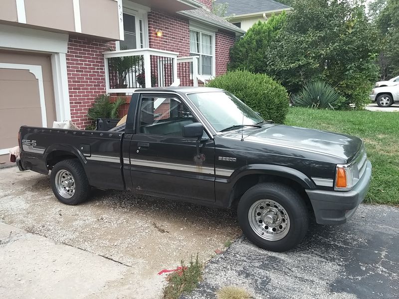

Herr it is
low_life77's avatar
low_life77
Nice man diggin the wheels! Truck looks good needs a little body work but whose doesn't? Lol You could pull that bed side out pretty easy instead of replacing the whole bed but that's up to you.
stevew84
Thanks haha the body is decent. No real dents or big rust spots just some surface crap. I plan in stripping and paint anyway so its cool.

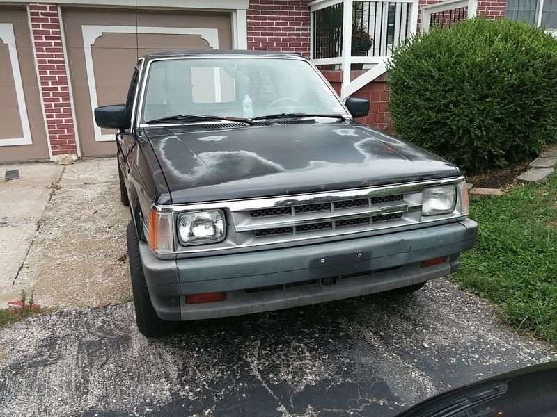

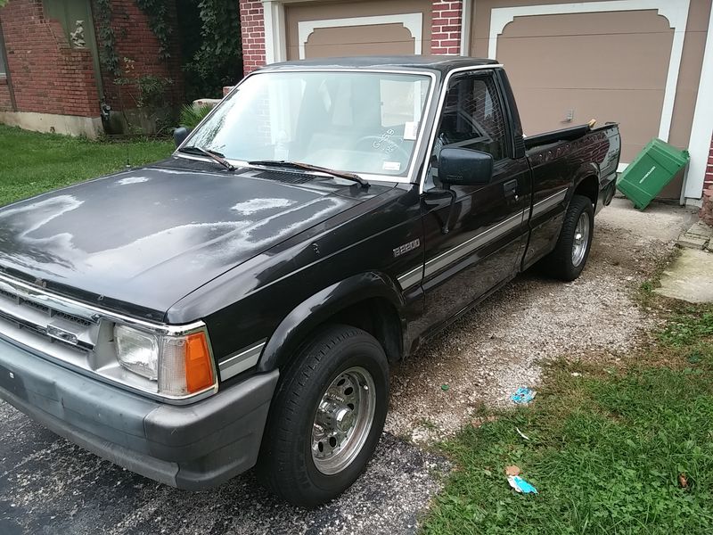

stevew84
Some more.
