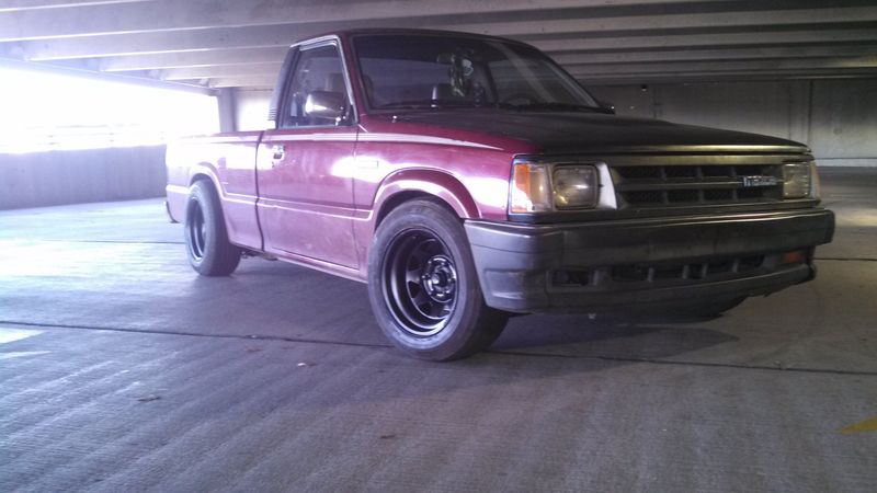

Hey guys! And thanks for reading I'm new to the forum thing and I need some help ive got a 93 b2200 with the original 2.2 that has basically no rings the carb is horrible and makes fuel efficiency a joke and it has no power! I like to drift but now I'm limited to when it rains as I'm sure some of you are I'm a young southern guy on a tight budget who needs power! I am pretty sure there are no good upgrades to the 2.2 that make much power without costing an arm and a leg am I wrong?
