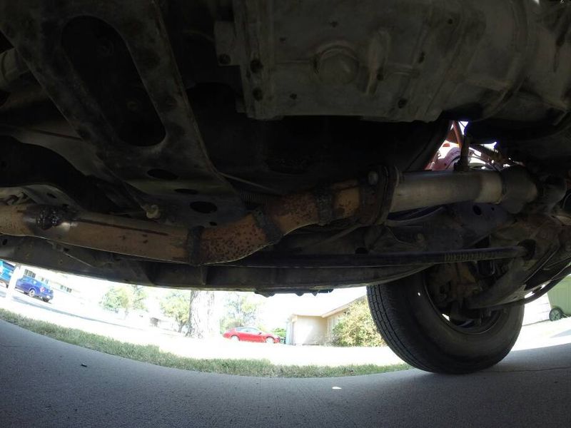

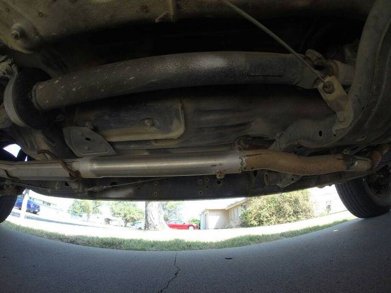

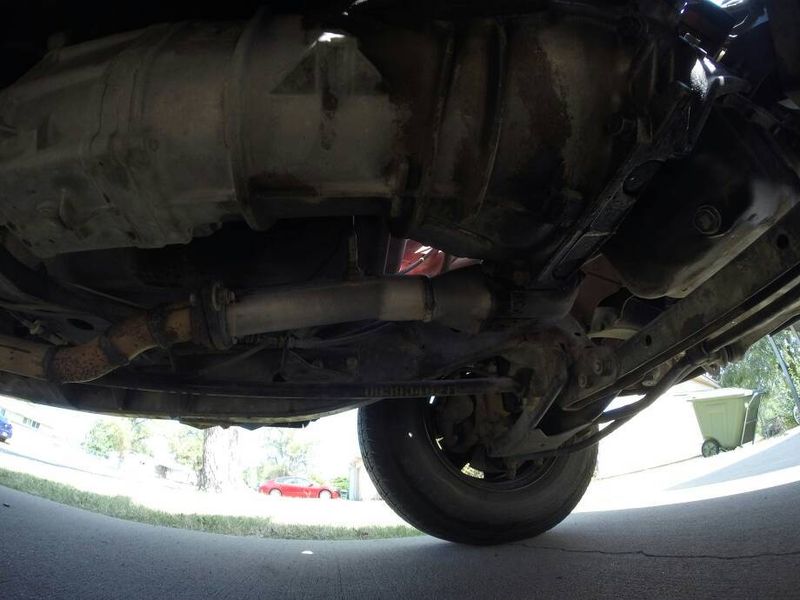

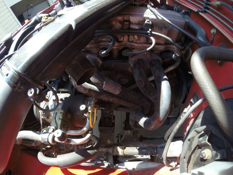

I'm running pacesetter with stock exhaust. I removed the secondary cat as well though. Had to take a few curved pieces of exhaust pipe and weld together to make it all line up without hitting anything. Like the cross-member.
dangersoulylow
any pics of installs?
dynomike's avatar
dynomike
Welded the header collector pipe to the header. Didn't like the whole clamp idea.
Series of bends welded in place to get a nice fit without bind. And without hitting on the cross member.
Second catalytic converter removed with pipe welded in place.
