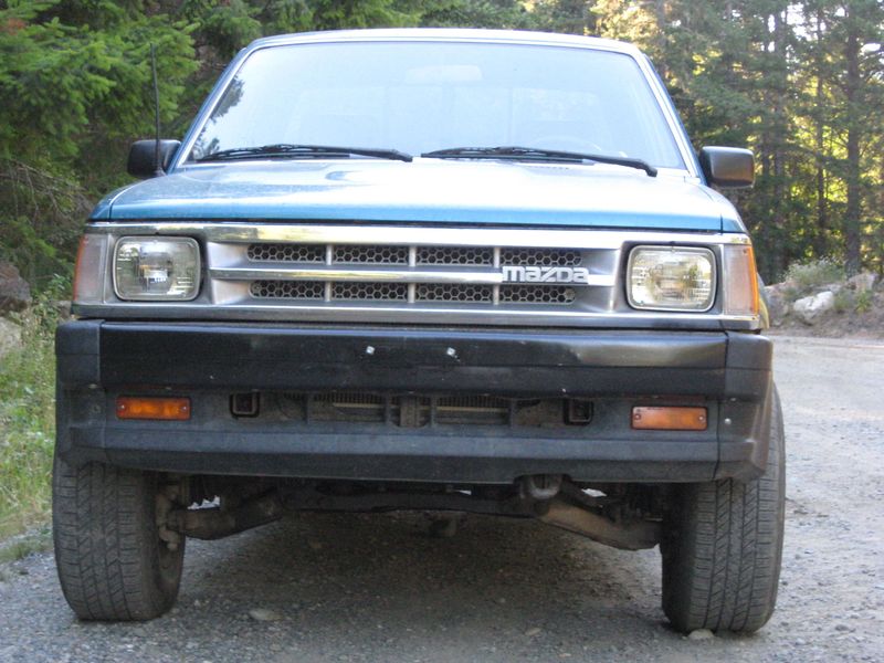

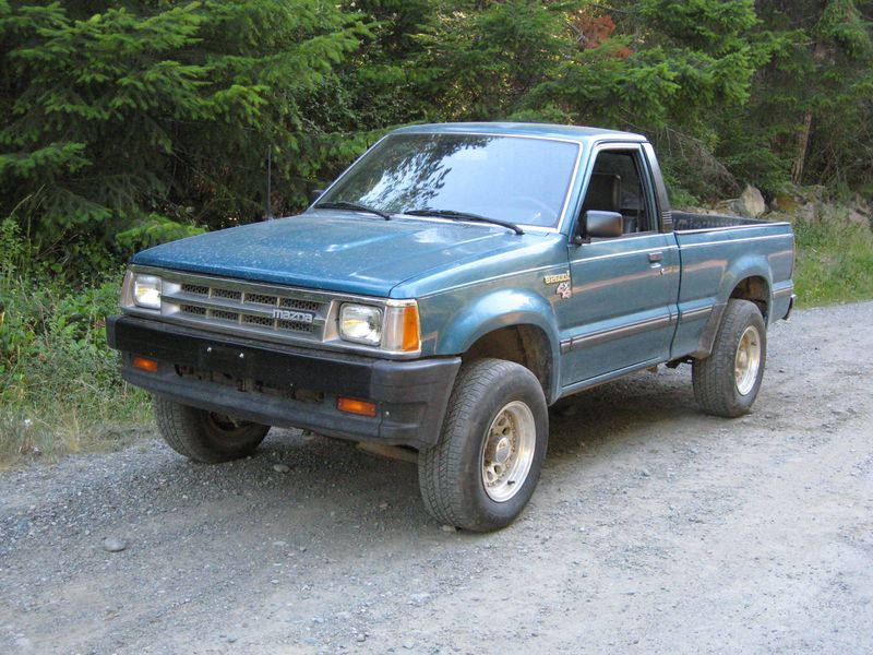

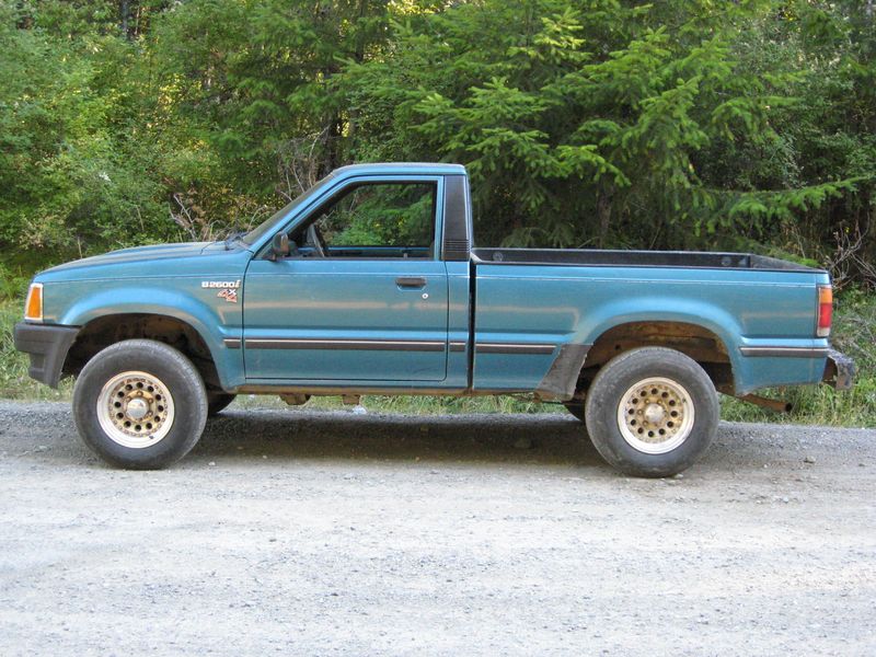

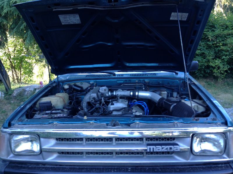

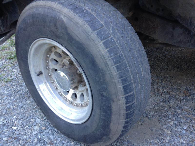

Yup, your absolutely right Scotch, I replaced both molded hoses at the back of the head, also: thermostat, radiator and cap (had a dry green trail running down the from the neck.), alt/water pump belt (like new), plugs, wires. There was a little tag with the new head that said your "old head cracked for a reason and your new head will crack under the same operating conditions". Got me really thinking about what caused this thing to crack. Lack of maintenance, leaky rad cap...low coolant aahhh.... computer failing caused fuel injectors to fire only for three cylinders causing it to over heat. I believe it was all of the above. Runs good now except for a rapping sound at higher rpm, around 3100 under load, no missing, will hold speed nicely, just loud. I thought it might be the balance chain. It reminded me of a dry hla but not constant. I tightened up the chain, adjuster is almost at max now. The chain was really loose. I'll test drive tomorrow, and let you know. Bare with me on the pics. It doesn't like some them and won't upload. Here's engine compartment and tires I'm running now. I got to retake full body picture, won't upload. later
mountaintopjdog
Here's a few more pics. Oh and figured out the sound I was hearing. Timing was out. Set the timing, little engine purrs now
