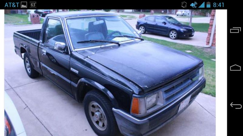

Hey everyone. Just stopping in to say hi. Just picked up a 1990 B2200. Currently not running. Hopefully I figure out what it's problem is soon.

I started checking compression, 30, 50, 70, 50 were the results. Radiator was dry, I found a broken hose under the intake. I figure atleast a head gasket, look at the valves, and I might as well throw in some rings while I am there since it isnt that much more work to drop the pan on one of these.
Unfortunately I dont know much of the history besides the guy I bought from was tired of messinig with it. He thought it wasnt getting fuel, but I verified the fuel pump is priming and the carb is getting fuel. It is highly tempting to pull the carb off and throw a weber on there just to get rid of all those dang vacuum lines.
