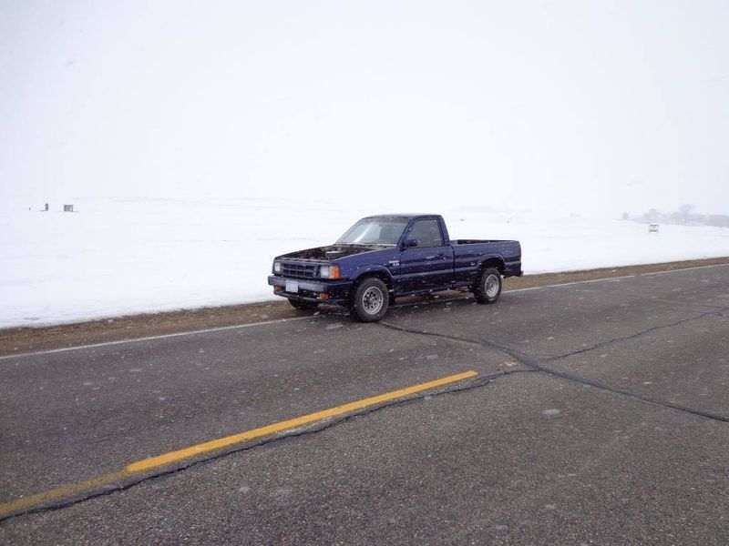

Just wanted to say hi to everyone. I joined about a month ago seeing what people had done to their trucks. Now I am willing to help as I can to others that are looking to put a ford small block in their truck. My dream is to make mine a autocross or drag truck but yet still be able to use it as an actual truck, haul a boat, bike, whatever. But today 4 years ago, my baby was born... I heard its firsts revs of its 5.0 engine today at about 6.30am. My buddy and I started this project on Jan 1st and it was driving May 1st. Its came a long way since then and still continues to change. I am looking forward to posting many more pictures (as soon as I can figure out the picture loader.)
Thanks for looking!

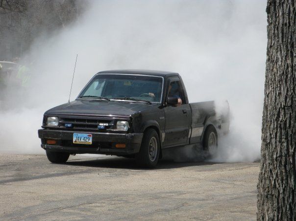

Oh and a preview of what she used to look like

are those South dakota plates?
chevellex69
close. Minnesota plates actually. Bought it from my friend who is from North Dakota.
