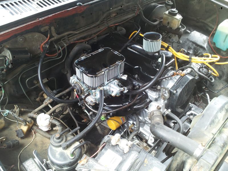

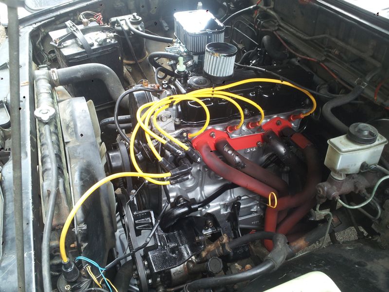

pabartelt's avatar
pabartelt
here are some pictures of the engine after cleaning and painting with the new header and weber.
