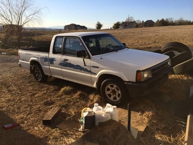

well I went and picked up my truck today. 1992 b2200 extended cab. good body and chassis/frame. the timing belt went on the motor so the motor needs to be replaced. I gotta pull the motor next week. might do a rebuild if possible if not then something else is going in there. I have to get the stickers off , clean the truck real good and see what direction im going to go. definitely going to have to throw some wheels on. the truck is screaming for a drop or some bags. here is a picture of the truck. more to come with progress.

Whoa - contrary to some written information, these B2200 engines are NOT interference engines, so maybe you just need to replace the timing belt (and maybe tensioners, etc.).
And my '88 has those same wheels, and I've had it 19.5 years, nothing wrong with them. Truck looks nice, how many miles on it, and hows the interior?

hi Cusser thanks for stopping by and informing me. I was unsure if they were valve interference or not (I didn't look it up yet). the guy I bought the truck from said he bought it to basically do what you explained and the belt tensioner etc. but when his mechanic got in there there was some other issues.(possible bent valves? might need a new head)
maybe the guy that was doing the work for him didn't know what he was doing. ill take a look of whats going on in there if i can get away with doing minimal that would be great. i never would turn my back on a good engine. but if its a total loss i have a few ideas of what im looking to achieve with this truck.. and on the wheels you are right they function properly and look good. im just looking for a little bit bigger of a rim maybe 17 -18 inch.
