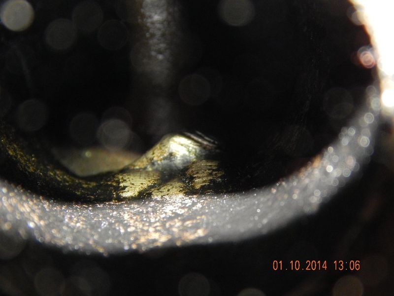

Thanks! Here's the start: Cylinder #3 had a water leak into the chamber and serious loss of pressure when I preformed a leak rate (~50%). Loss of pressure was into the cooling system. Here is the crack I would later find:
Tim
tidentenn
here's a image looking into #3 exhaust port and the fix that was made years ago:

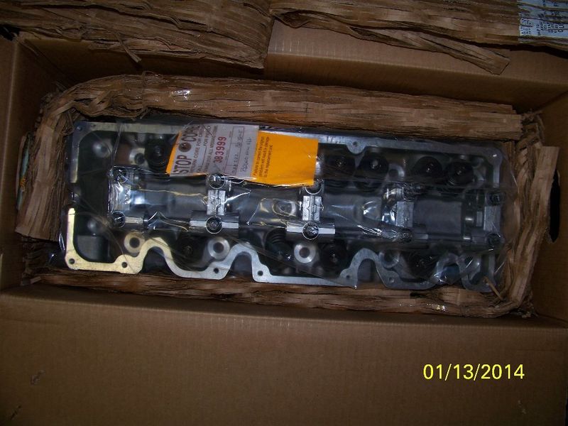

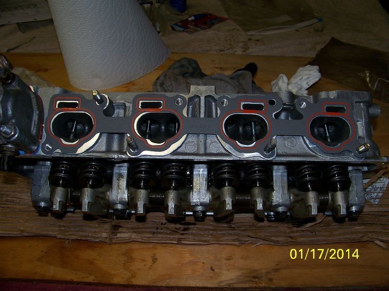

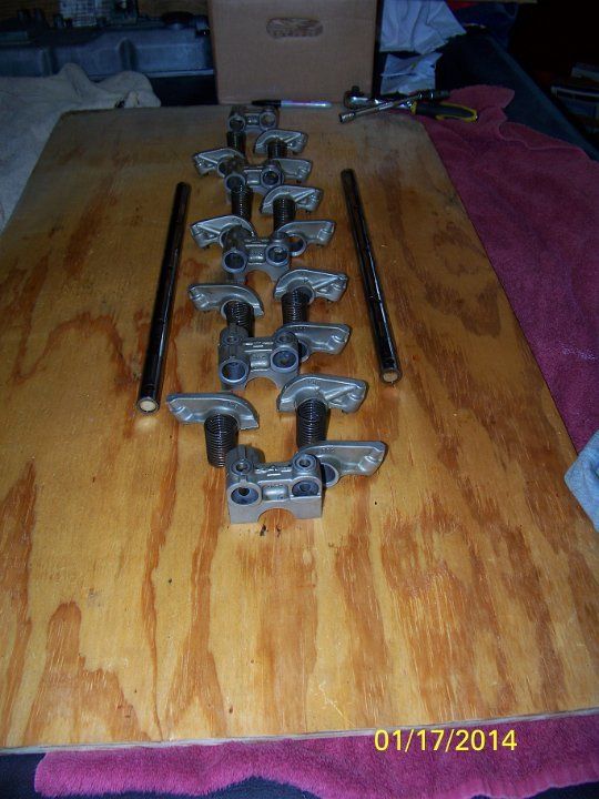

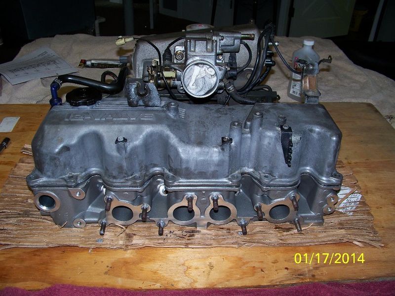

So, ordered a new head assembled it using the old cam, rockers, and rockers shafts. Reading to go back on waiting for the water hoses. I even ordered the ignition wire clips while I was at it.
B2600i Head Project
assembly this coming week!

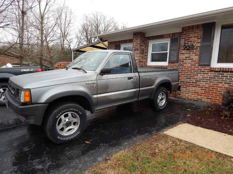

Got the truck squared away driven it several hundred miles now. Knock on wood, but she runs better than ever, very smooth idle and instant start-up. Here are some pics and link to video. Thanks. Tim.
