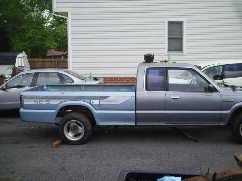

I have already done this conversion if you need some advice on how to go about it.
mymmeryloss's avatar
mymmeryloss
That looks good!
