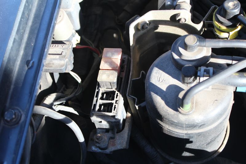

There were two relays next to the driverside door. this one had 4 wires so i assumed it was fuel relay. maybe it is and is solid state or something?? not a regular coil and switch relay for sure..
kylesj6033
So is your truck a electronic fuel pump? If so just put a jumper in for time being in that relay and listen for the pump to kick on. In the picture you posted I dont see a mechanical one but then again the picture doesnt show a good angle on the placement of it. There is a good source of knowledge here if you can get people to respond to your forum. Most of them assume you havent searched.

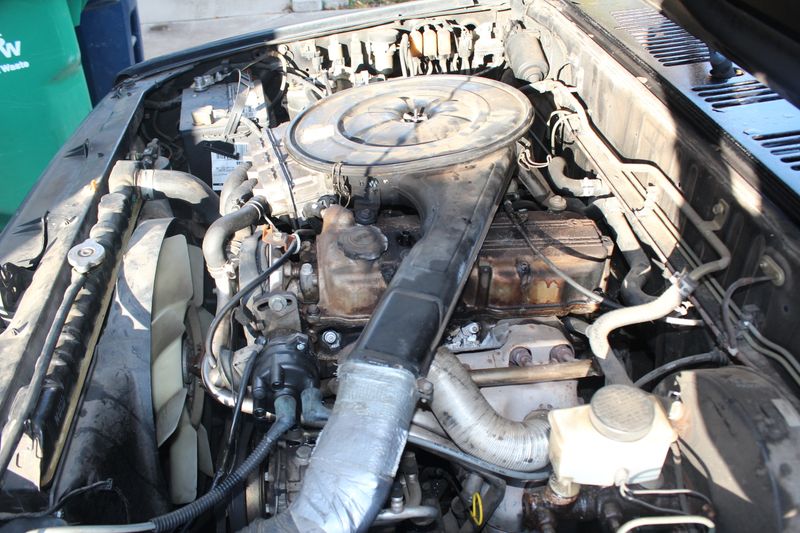

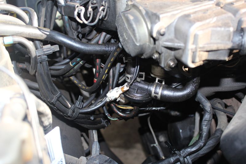

ive searched a bit definately. Working on my honda is way easier via the internet bc there are tons more info and diy walkthru guides on pretty much everything (im sure there is for the mazdas too, i just havent found them as easily yet). ive rebuilt my civic motor, replaced bearing inside my civ's tranny, installed rear disc brakes, done a/c stuff, seats, stereo... i have a little ability, ive just never worked on a carb before nor a mazda. here are a few more pics i took of the bay, so maybe yall can tell if it is mech or electrical fuel pump.
***much thanks guys for the help so far! and sorry for the huge mega pics... is there an easy way to make them smaller or what size should i try to make any further ones for uploading?

Ok and your first picture is of the fuse block. My truck looks completely different from yours as mine has been converted but those are Master fuzes. Sorry if the name is wrong as Im not exatly sure of the name but those are fuzes anyways. I think its a manual fuel pump. Someone else who has that carb give some input.
If its a manual fuel pump the possibility of it being out is slim but not impossible. The manual fuel pump is on passenger side of motor by the firewall up under the air cleaner assembly. There will be 2 bolts holding it in place with a small spacer.
