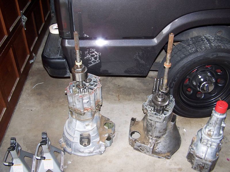

This is the only pic I could find of when I did it. They are both RX7 trannnys but one is from a 1st gen RX7 and had almost the same gear ration as the one in my B. I used the one with the big weight on the output shaft.
