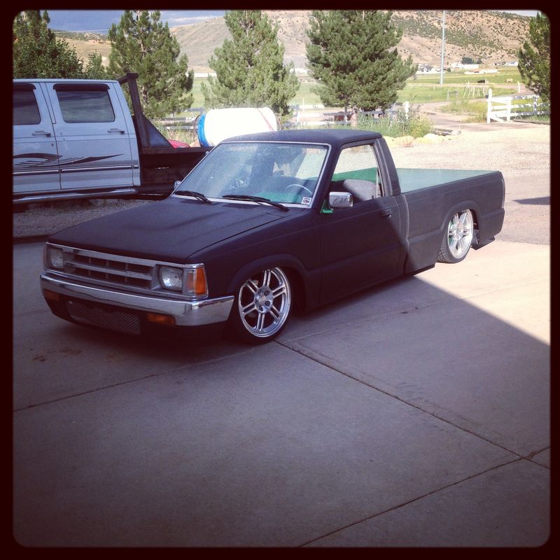

Hey guys, I'm new to the forum (obviously) and new to the B-series scene. I've done my fair share of research on mini trucks and air ride and finally bought my first one. It was on the cover of Mini Truckin in 2001 and has done more sitting under a cover then it has got drove. 98xxx miles. When I picked it up it ran great and drove great as well. I drove it an hour and 45 minutes home only to try to fire it up to pull it in the garage and it wouldn't start. I knew it needed a new starter so I banged on the starter and finally got it to crank over enough to fire. But then it didn't want to go in gear. I finally got it in gear and it started creeping forward with the clutch pedal to the floor. So I tapped the brakes and it killed it. I had to leave town right after that but I'm worried it is something major. I'm hoping its just a clutch and starter, not the rear main or slave or anything else. Could anyone give me some assistance? Thanks guys. Pics soon to come

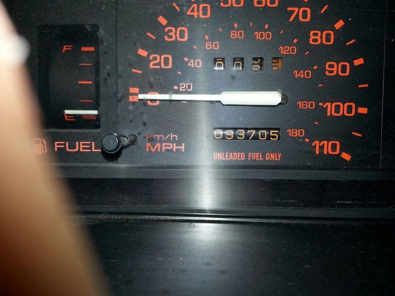

Thanks guys. So is it safe to say the clutch might still be good? I'd really like to get it going so I can drive it more before snow flies. I was also wondering if anyone has ever done a gauge swap or knew of someone that made a new set of gauges or a face plate for these trucks?

As far as the gauge swap my base model B2200 had no tach, I swapped it with a B2600i gauge cluster and it looks like yours might have had the same thing done to it (very common). Having said that I wound the miles down on mine to match the correct milage (its possible that the person who swapped yours may have left it or wound it too far?) not saying your B isn't correct in having under 100,000 miles on it or questioning the credibility of the seller, but just be weary of the possibility. There is no way to tell if that was the dash your B came with (at least I don't know of one), and judging from the 2600i bubble hood it's possible that the person made a wrecking yard run and came up on a 2600i doner car.*I know I did

That B looks sick though and very clean. Seems like a good buy, welcome to the scene! MORE PICS PLEASE!

Thanks space monk! And I do believe it is original, because the story goes as this;
Someone had too much money and bought the truck and had a shop do the work in California (it used to be the hack shack), it was a trailer queen for quite some time and on the cover of mini truckin in 01. It then sat under a cover for a while, it wa parked beside an rv and the cover ripped and the reflection off the rv ruined the body work on the drivers side handle. Then he backed into it with the hitch of his truck and the guy I bought it from replaced the doors, hood, and the drivers side fender. I could tell you even more about the truck that I was told, but this is getting lengthy haha and pictures should be up tonight. I'm on my phone and its a pain in the ass.

You've got an awesome B on your hands. Should bring you years of looks and jaw drops. I for one am not a fan of shaved door handles but to each his own, right (for a custom bag and body it's fine though). I also lifted my B unlike most. Mainly because I had my 88 fc rx7 lowered at the time (hydroplaned it into a pole a few years back , and my B was my daily, still is actually. 10 years I've had her. I seem to fix it every time I break the shit out of her. Good luck with everything and get ready to fall in love with your B.
