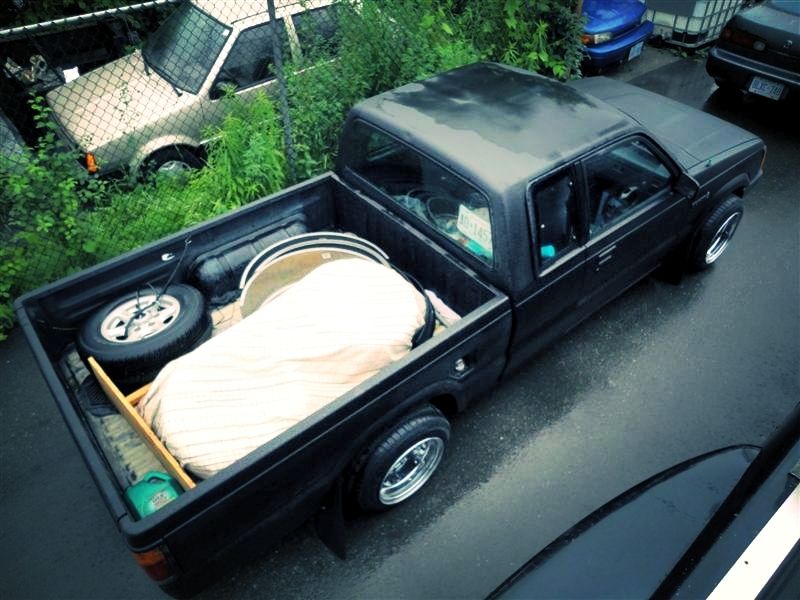

what's up bscene. i've been lurking, and now have finally starting wrenching on my latest project.

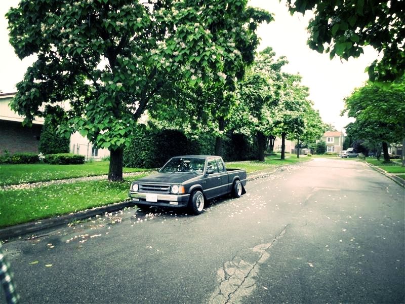

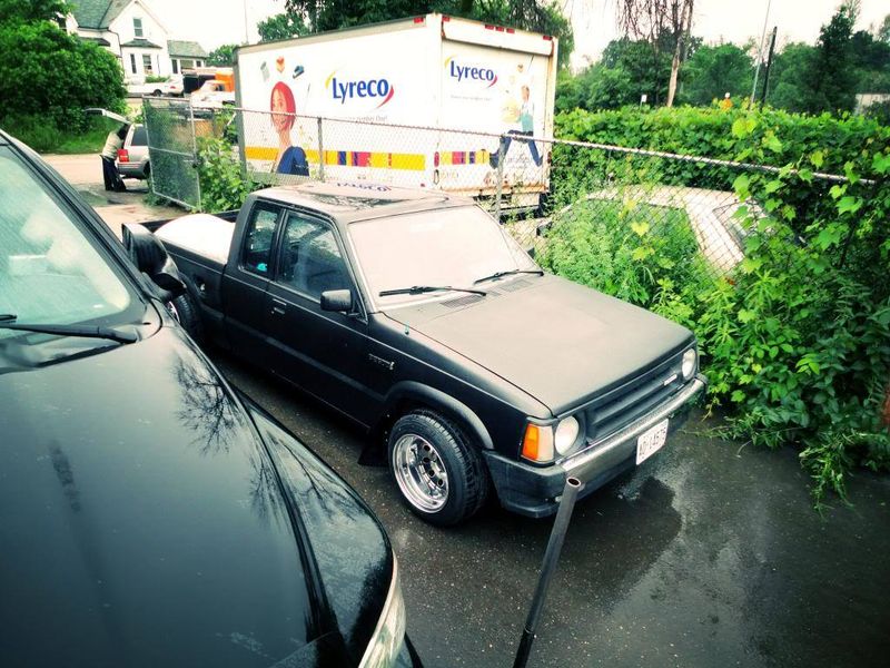

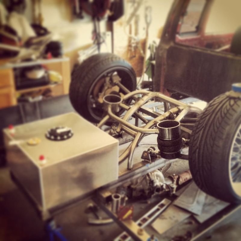

i'm looking to achieve the stance look; and am looking at suspension and camber solutions. has anyone completely gutted the torsion bars and thrown in coilovers? can the rear wheels be cambered? will i have to install[weld] an IRS-Frankenstein from another RWD vehicle?

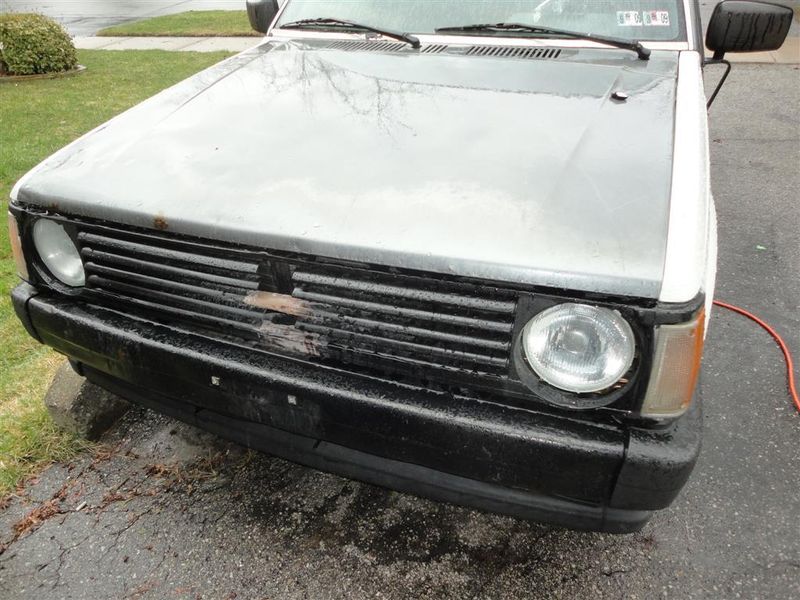

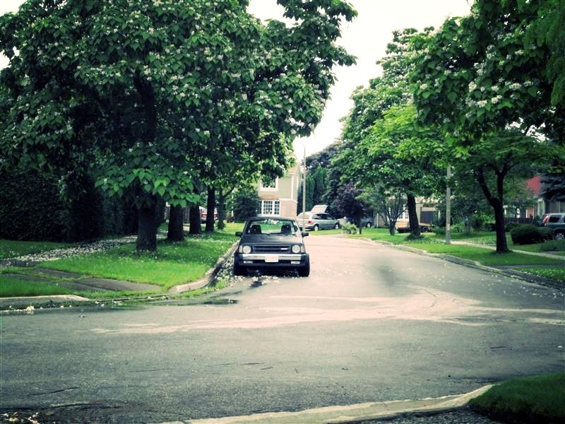

i'm currently running 15X10s on 225/50/15s with a very mild stretch and pretty aggressive poke. for those of you who noticed; i've fitted mk1 golf roundeye headlights in; and the corresponding grille pieces. i want to eventually put a mk1 complete badgeless grille...

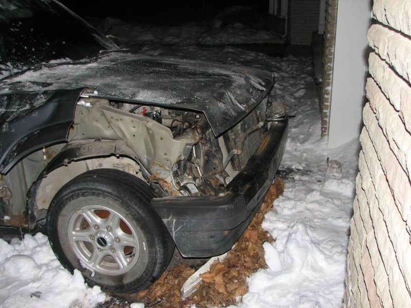

how she started; extremely mashed.

Welcome to the Bscene! I was in the 416 a couple of weeks ago for the music festival at Yonge-Dundas Square. Yes you will have to go with an irs if you want the rear to camber. You can get plenty of camber out of the front with the torsion bar suspension but will eat up tires.

Camber in the rear? Shit. A ford 8.8 irs setup will do the trick

I got the 8.8 from a ford thunderbird

Yes u will have to have the yoke welded on the driveline and balanced.

first off. i'm liking your truck. what size rims/tires are you running? most ppl really dislike the mexipoke thing; but hey... to each his own, i prefer em' way out than sucked all the way in...

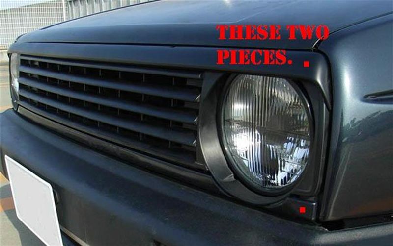

re: converting to round headlights. it's still a work in progress; but i didn't really like how some people sunk round headlights into the square openings of the stock grille. i felt it needed a bezel or something to complete the look, and couldn't get my hands on any C-10 [or similar old school chevy truck] lights to do the job.
i opted for some vw mk2 golf headlights; which have mounting plates as well. i recently scored some chrome bezels [inners and outers] from an old porsche 944 at the scrapyard; i plan to retrofit those pieces in as well.

+pair of round headlights [vw ones are good, because they have the mounting hardware and use H4 bulbs]
+vw grille [i'm still looking for a badgeless mk1 grille to complete the look, my body guy butchered mine.]

my truck was smashed in; so everything was slightly off. i'm sure if your nose is straight; you'll be able to use 99% of the existing holes.
