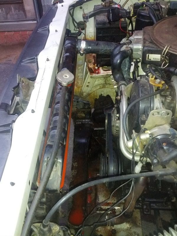

Update: I'm in the final throws of removing the belt driven radiator fan and going electric.
Why? Because it releases 1-2HP and drops 3lbs from the engine.
Shopping list (helps if the HB 929 was released in your market)
* Radiator fan from HB
* Thermostat housing from HB
* Upper alternator bracket from HB, mine's from a Turbo
* Normally open thermo switch M16 x 1.5 like Tridon TFS139
* Normally open relay with a bracket
* 750mm V-belt for alternator
* Wire, terminals, tape and fuse
* Optional and probably a good idea to upgrade your alternator
I've completed the wiring and have been waiting for the upper alternator bracket before doing all of the mechanical stuff. This weekend should see the job done if the rain stays away.

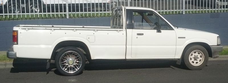

Well this morning I went to go and pickup some bits for todays project and found a flat tyre. I recently picked up some 17x7 WEDS from Yahoo japan so I put some air in the flat and had new rear tyres fitted...
NEEDS LOWERED
I then started to do the electric fan conversion and after swapping out the engine brackets, buying another fan belt because I lost the old one I found that the radiator so this is my progress.
