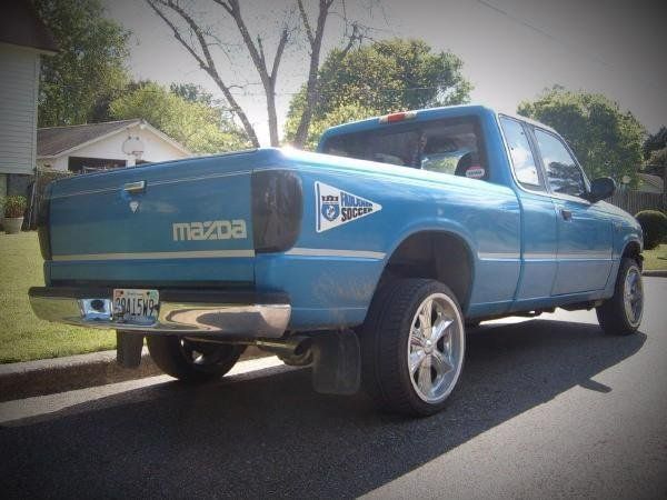

Hello, I am a brand new member and hoping this place will bring me some people to point me in the right direction in modifying my 94 Mazda B4000 LE extended cab
I am looking to lower it but have never lowered a truck. is it complicated? what is the easiest and cheapest way to lower it? also looking for some companies to buy from. Im far from being a grease monkey but willing to try.

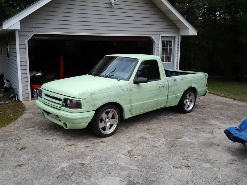

This is the same drop on a Ranger

The front suspension looks like what I posted, it uses an i-beam type suspension. For the rear you would use the brackets included in the kit to flip the axel on top of the leaf springs.

Awesome thank you. I am definetly interested in a kit for under $400. and that will essentially lower the front and back? I have (with the help of friends) put lowering springs on a car. its the rear suspension that looks intimidating. and yes I would like to order a kit that has all the essential parts and with the help of some buddies, I will knock it out over a weekend. Do you know what size rims and tires are on that Ranger? My goal is to get rid of the gap. I have 18s on low pros right now and as you can see its quite a large gap.

That Ranger has 18x8s on 245/40/R18 Tires. I think you get rid of the gap with that kit but its hard to tell with out a side shot.
