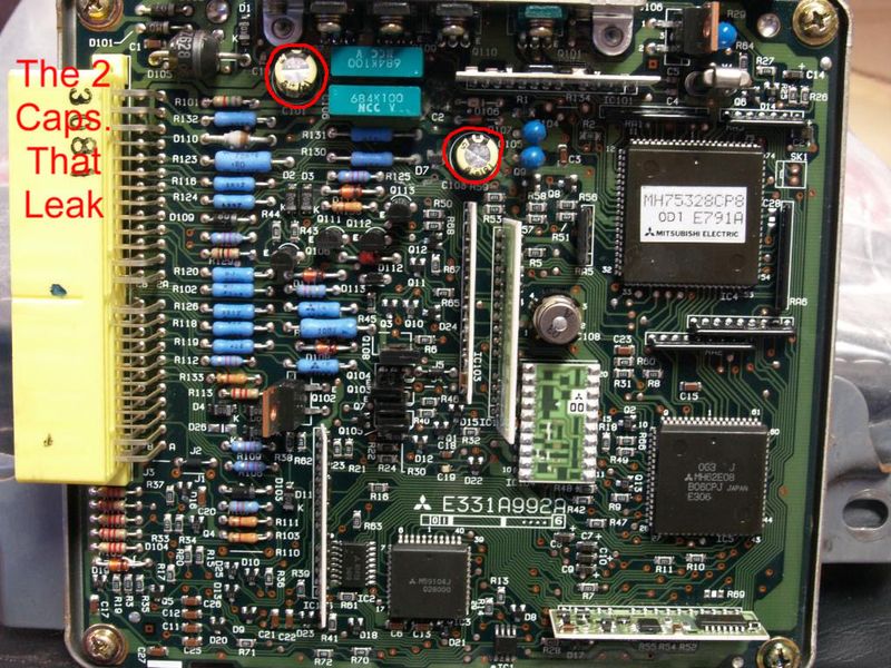

And since it's a b2600 stumbling on acceleration
Courtesy of our dear Earl from:
rodburner
Thanks Jenko. Yes,I saw Earl's pictures and that is where I started. I popped the cover and saw nothing but a nice clean board,just like the pic above.Could the corrosion,if any,be on the bottom side of the board? Being 57,my first thought was the fuel filter,since the truck runs like a top,with the stumbles coming and going at 2500rpm or less,usually.
