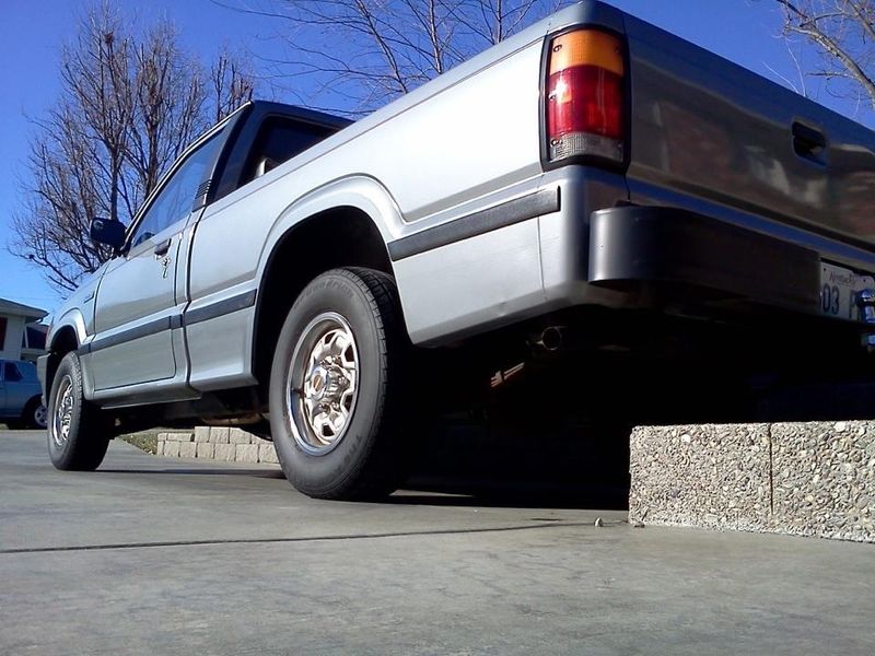

This is my 1990 Mazda b2200, I'm planning on putting on my gm 8 hole wheels and lowering it with lowering control arms, and blocks in Rear.
mazdafvr
looks pritty clean man. you can lower the front of your truck for FREE! lol just to throw it out there incase u didnt know

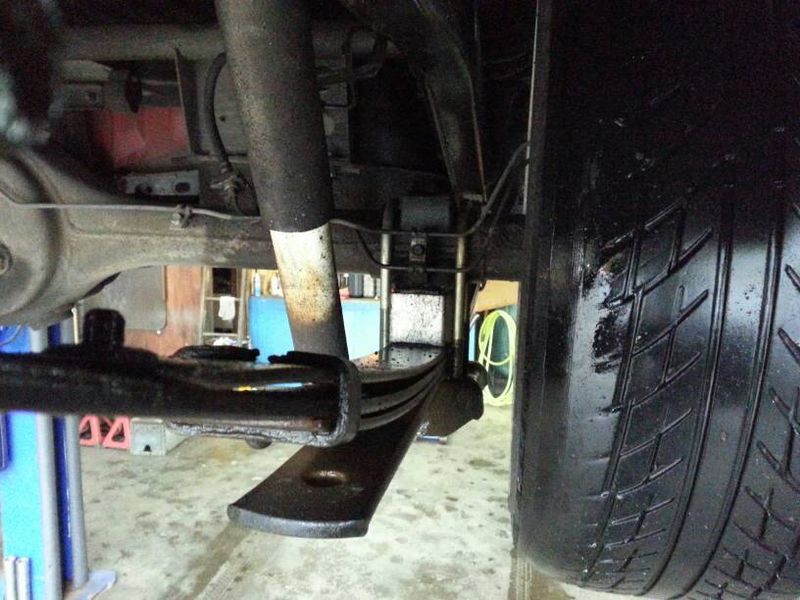

If you can afford the drop spindles for the front, I would go that route. Doing torsions to lower all the way cause bad camber angles (not super noticeable by eye). I have an alignment machine and it's enough to eat tires on the inside. This was a front tire after about a year or so...

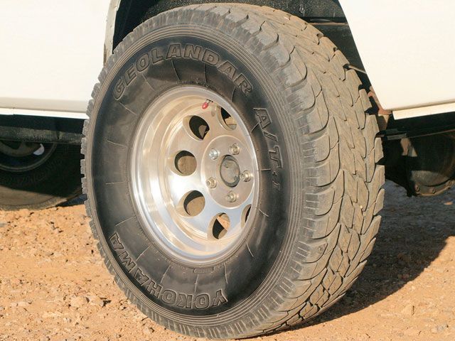

Actually they are the stock wheel off a 06-12 chevy silverado or gmc
jaboody's avatar
jaboody
These are what I'm talking about
