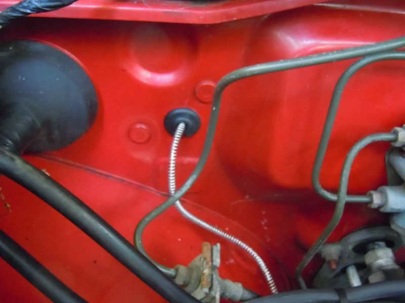

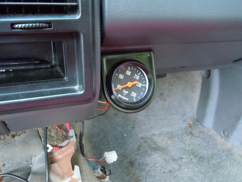

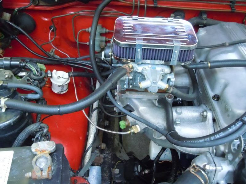

First thing I would do is install a $20 aftermarket temperature gauge so you know exactly how hot the engine is getting. It could just be a whacked out factory temp. gauge and if so, a new temp. gauge will let you know. You don't really need to permanently install it, just hook it up so you can watch it as you drive the truck.
There are a couple of screwed-in plugs on the side of the aluminum intake so you can remove one of them and install the sensor bulb in that hole.
Here's how my B2200 is.......
