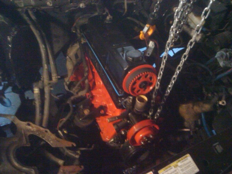

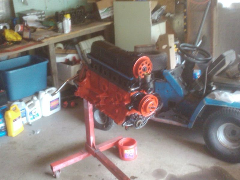

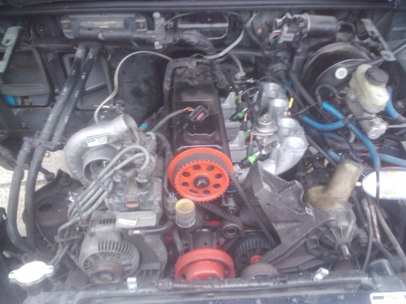

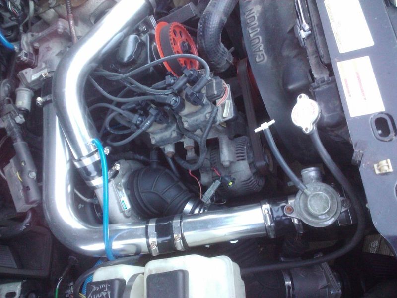

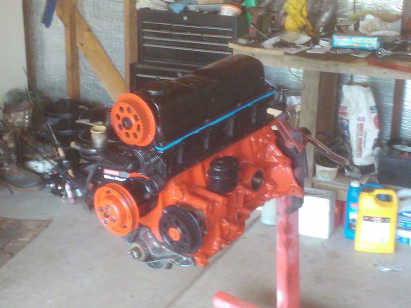

Few views of the holset
rlr023
Those are most of the pics I took while doing the motor. But basically the setup is a 96 ranger motor with forged 8.5:1 internals, new crank, 1035 felpro headgasket, 42lbs ford racing injectors, stock ranger roller head/cam, ported lower and upper intake mani, e3 exhaust mani, holset hx35w, 2.5" downpipe with 3" exhaust from downpipe Back, 2.5" intercooler tubing, 1g dsm crushed bov, sky redline intercooler, man. Boost controller, sniper tune,etc lol
