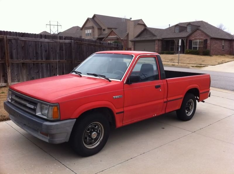

Lowering it and replacing the valve seals this weekend. Has 176K Miles on the clock. Picked it up for $200.00 since it didn't run. Just a clogged catalytic converter. Runs like a champ now, just smokes bad... soon to be remedied.
Here's a pick of the little dude!

Hope the valve seals replacement fixes your smoke issue. My B2200 required new rings at 183K miles as well as the cylinder head rebuild.

Welcome to the site, looks like a good clean B to start with.

I have an 89 that looks a lot like yours as well! I'm putting my money on rings.......I think you'll find that the seals will help some but the bulk of the smoke is from the worn/clogged oil control rings......after nearly 200,000 miles they just need to be replaced. You can re-use the pistons and just clean them good before you install the new rings and you'll get another 100,000 out of it more than likely.
Good luck, and keep us posted on the results....lookin' good!

Red like mine. Nice ! Let us know how the work goes and don't forget to share some pictures of your progress. You should be able to get all the answers you need on it right here.

Price is crazy good for a truck that straight looking.With time,and tlc it will be a nicer b for sure.I like red (sunrise) is the paint name.Mine is the same just cabplus style.Cool truck
