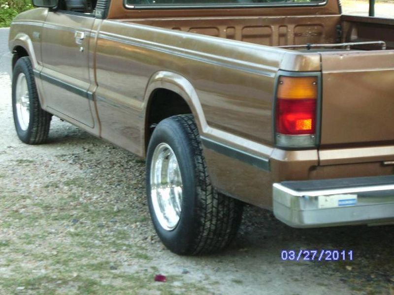

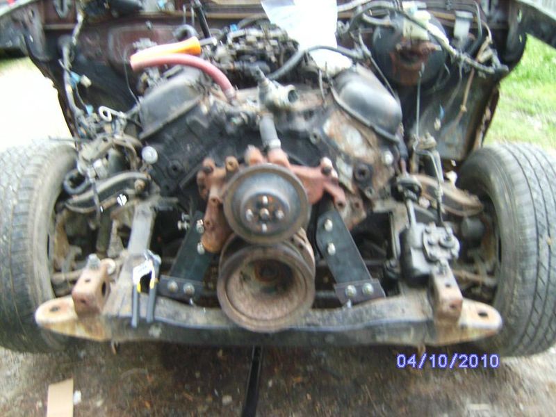

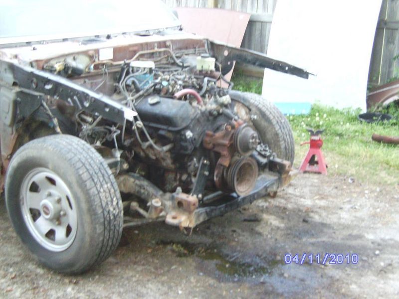

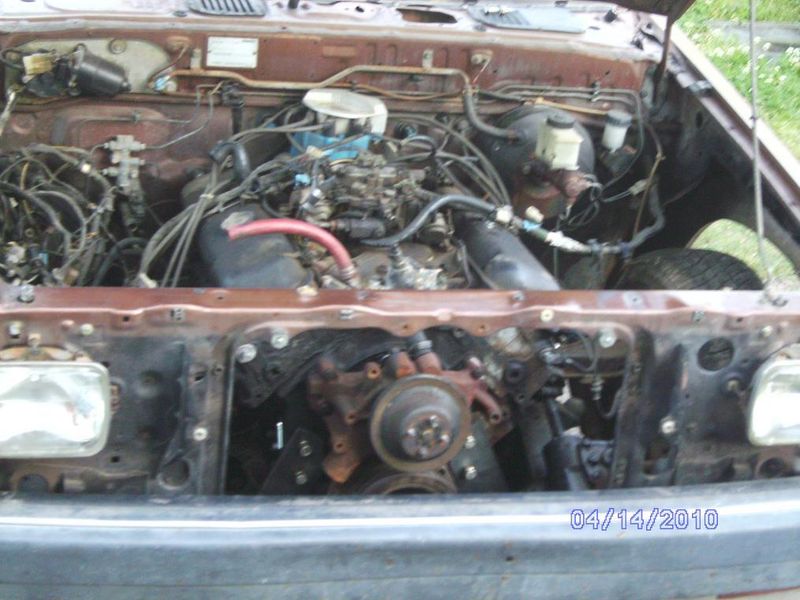

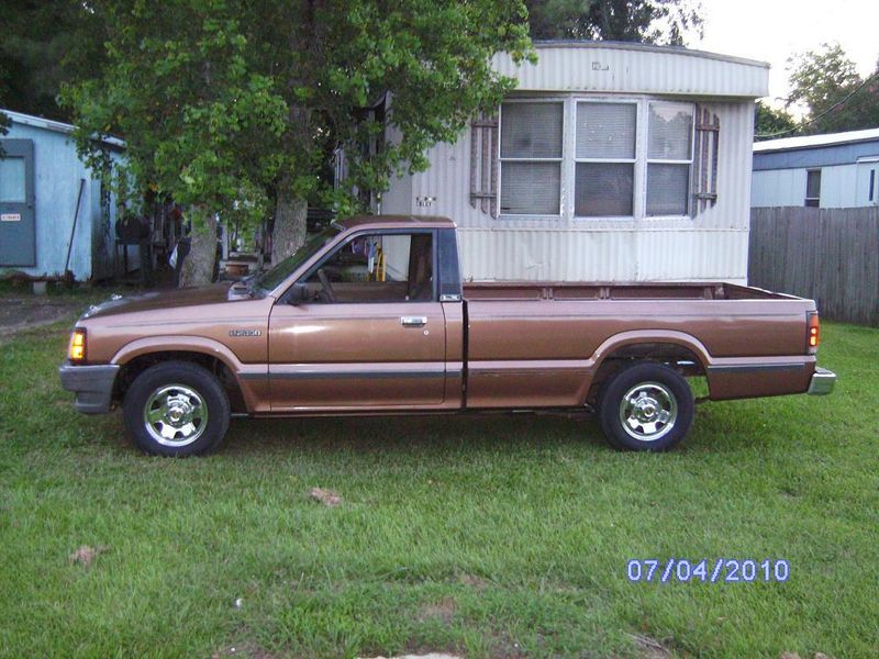

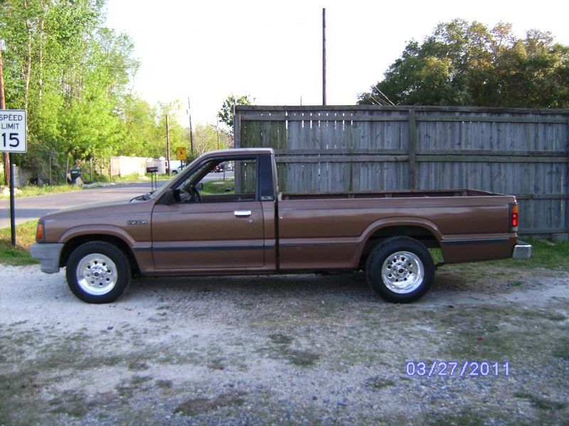

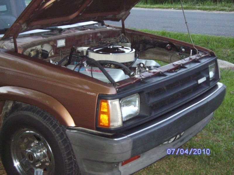

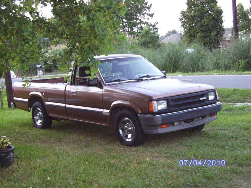

hey i'm al, i have a 1986 mazda b2000 truck with a 454 chevy eng. 400 turbo trans. i'm trying to figure out how i can convert 6 lugs to 5 lugs on the front end so i can install weld drag lite rims?
let's see some pics of that beast!

just use the help tab at the top of the page and it will tell you how to post some up, or Baha will tell you lol. and nice bet that 454 was a pain in the ass to get in there.

Here are the images I was trying to send, I had to change picture hosts

look in the tech area, there is a tread in there about doing the 5lug swap,after reading it its not that hard to do..must on here have done it at one point in time.....redrilling or swaping toyota spindles is the 2 ways its done mostly
