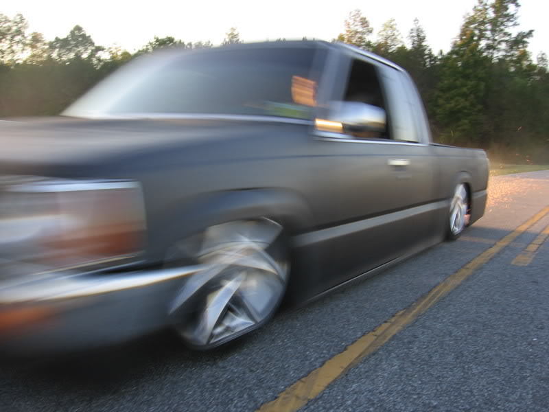

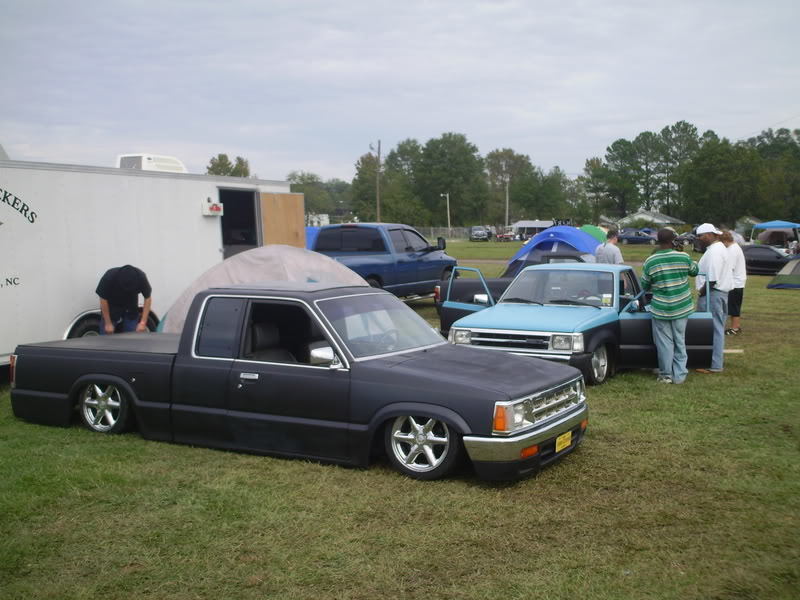

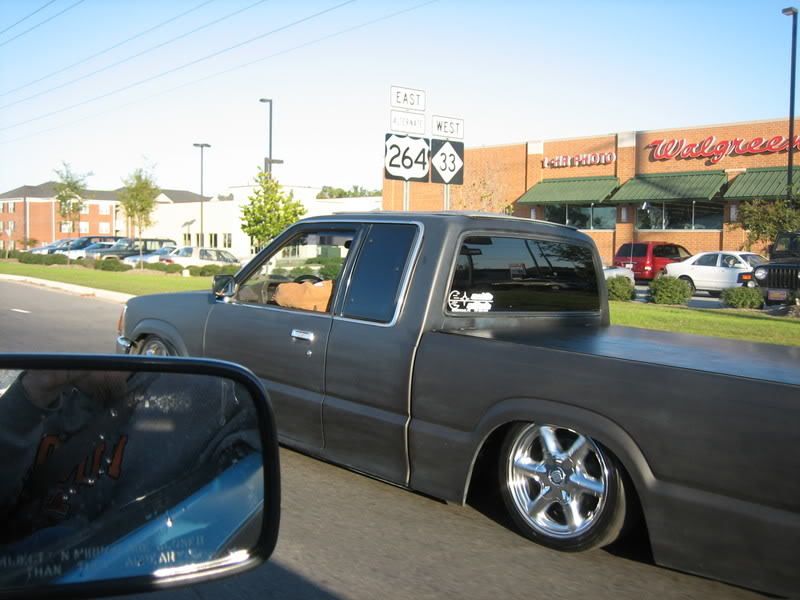

These are 205/40/16s on my old 92 b2600i
barrybs2600
thanks now i know it will not be very hard to do and i like the way 205/40s look thanks
