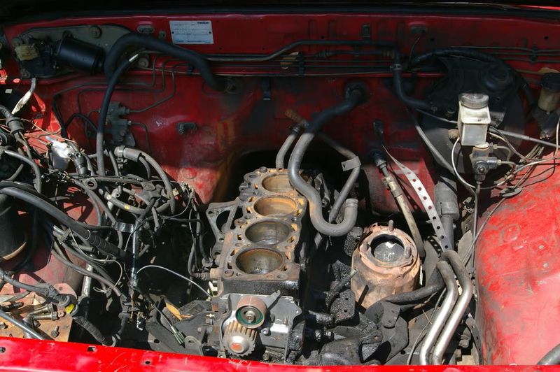

Hey what's up saw this forum on another site. I have an 87 not sure if its a 2 or 2.2 (engine is in pieces) paid three hundred for it and plan on rebuilding the motor for a reliable daily.

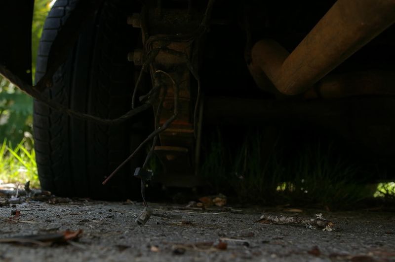

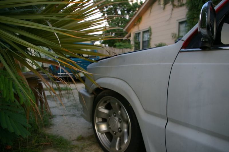

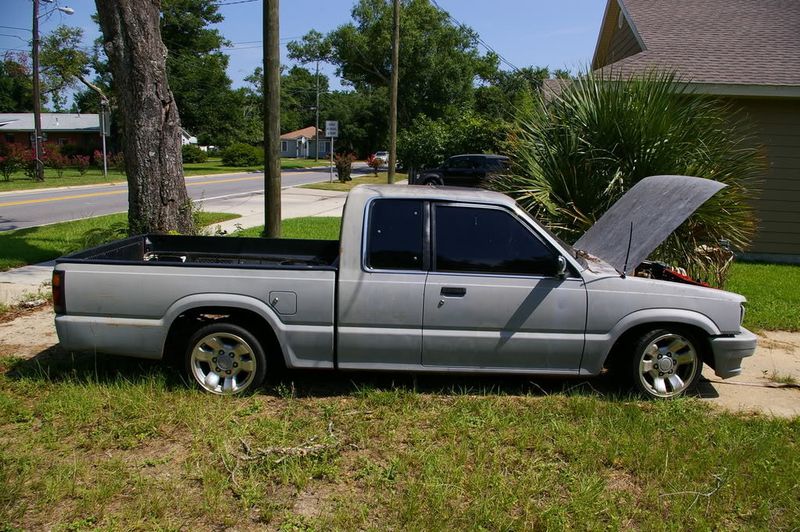

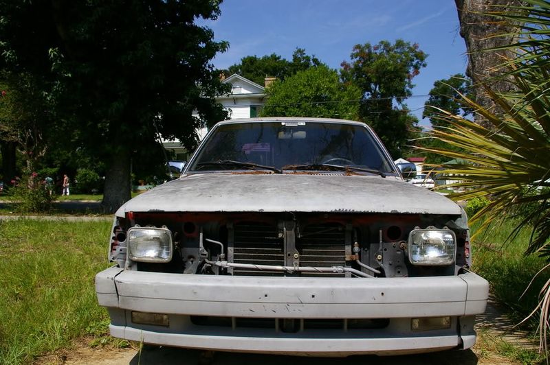

here's some pics..
its lowered... just not sure how much
oh and one question, any way to keep the leaf springs from dragging on the ground? i Like the stance, but bumps suck
would mono leafing help any?

Welcome.Always been a big fan of those yota wheels.Looks good so far.

monoleafing will only soften up the leaf pack and when you hit a bump it will hit frame hard... id say get ride of all but the main and the short one....

camshaft/timing belt upper cover. If its got a smooth, round bubble in the center, its a 2.0. If it has vertical ribs, it's a 2.2.
