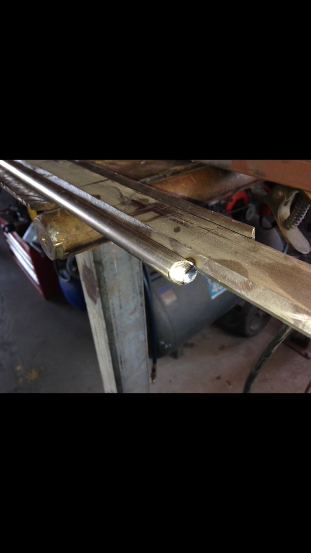

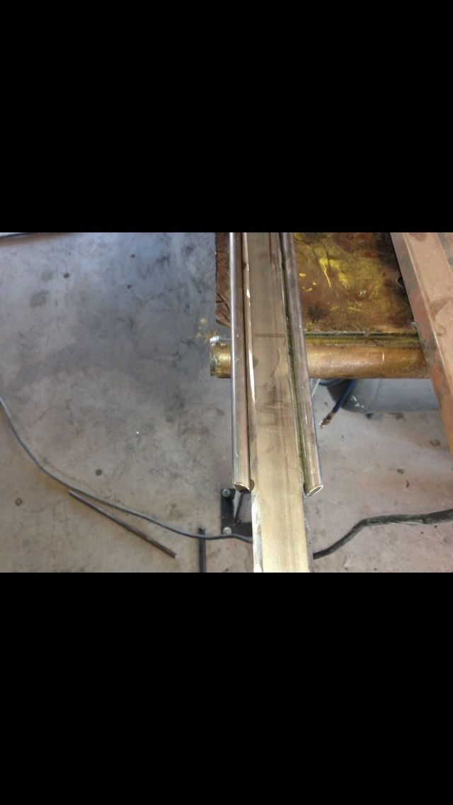

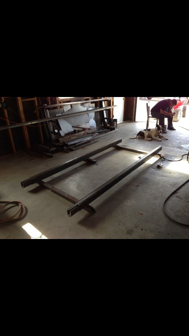

So finally got to start this weekend have all the final ideas on paper and made a test pies to confirm my math. But just got my new phone today so no pics yet. But I was successful in making 4 1/2" x 2 1/2" tube and it came out sweet looking. I'm a picky guy so I wanted the round edge of the tube but couldn't find the size I wanted so instead of welding four plates together and sanding the edge to weakness I found a way to make it with round stock takes twice as many welds but I'd rather have the reliability. So next weekend I'll see if I can get some pic for any of you who might actually wanna see my build thanks

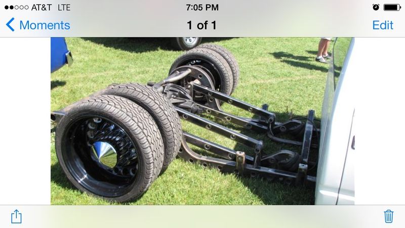

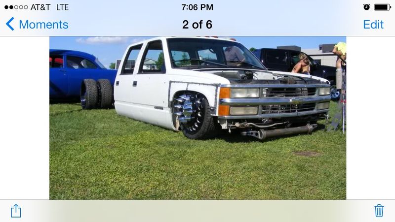

I like the short bed idea

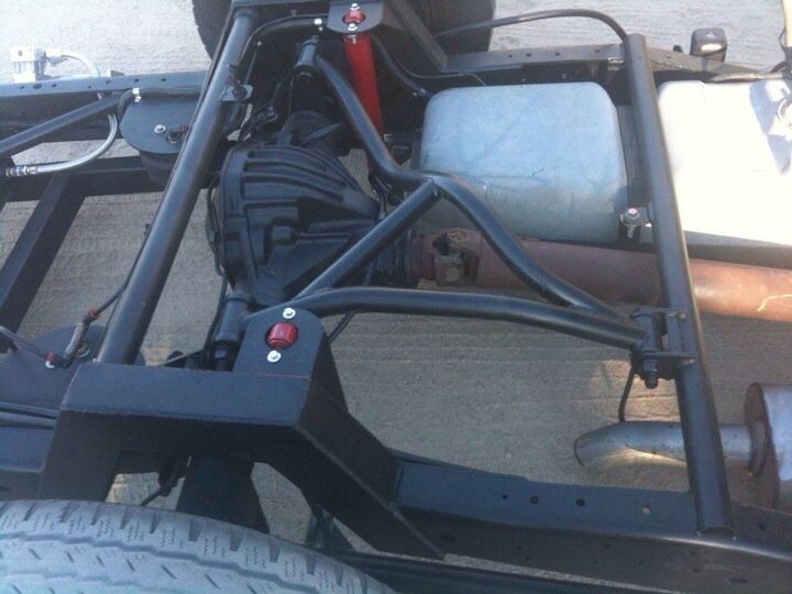

exoticiron

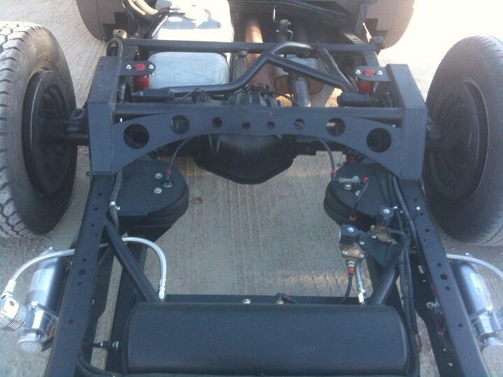

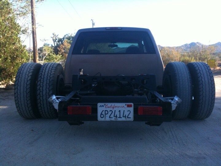

What I'm going for

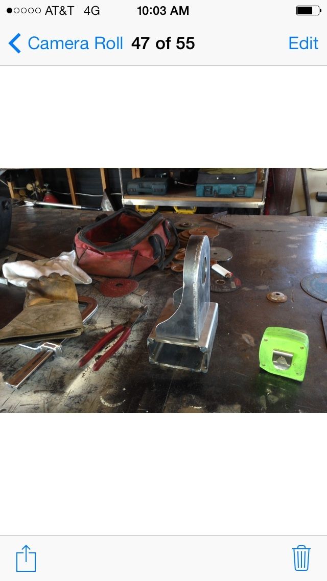

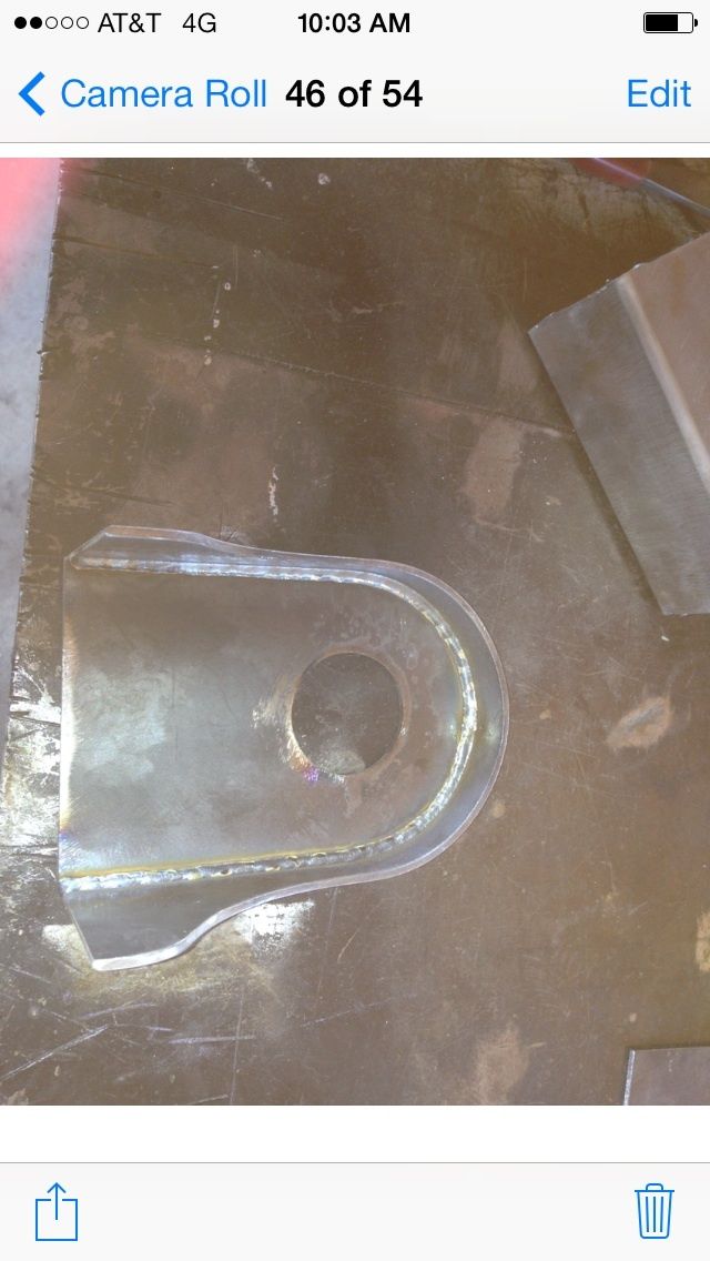

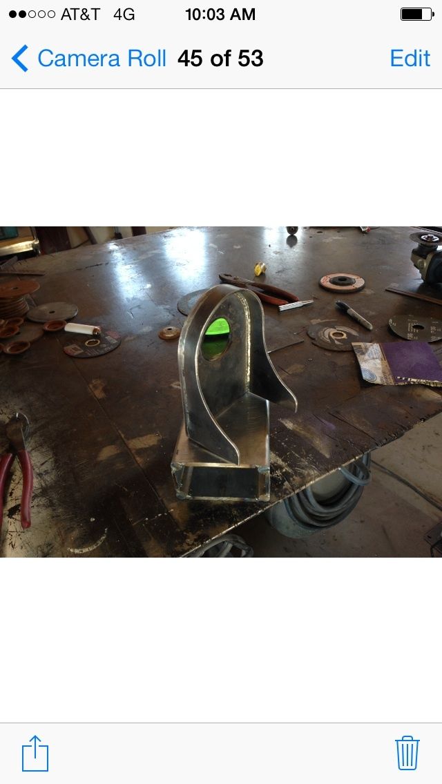

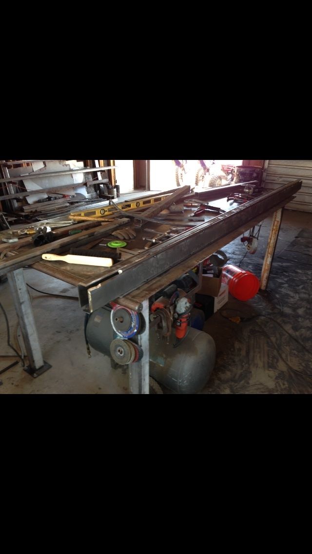

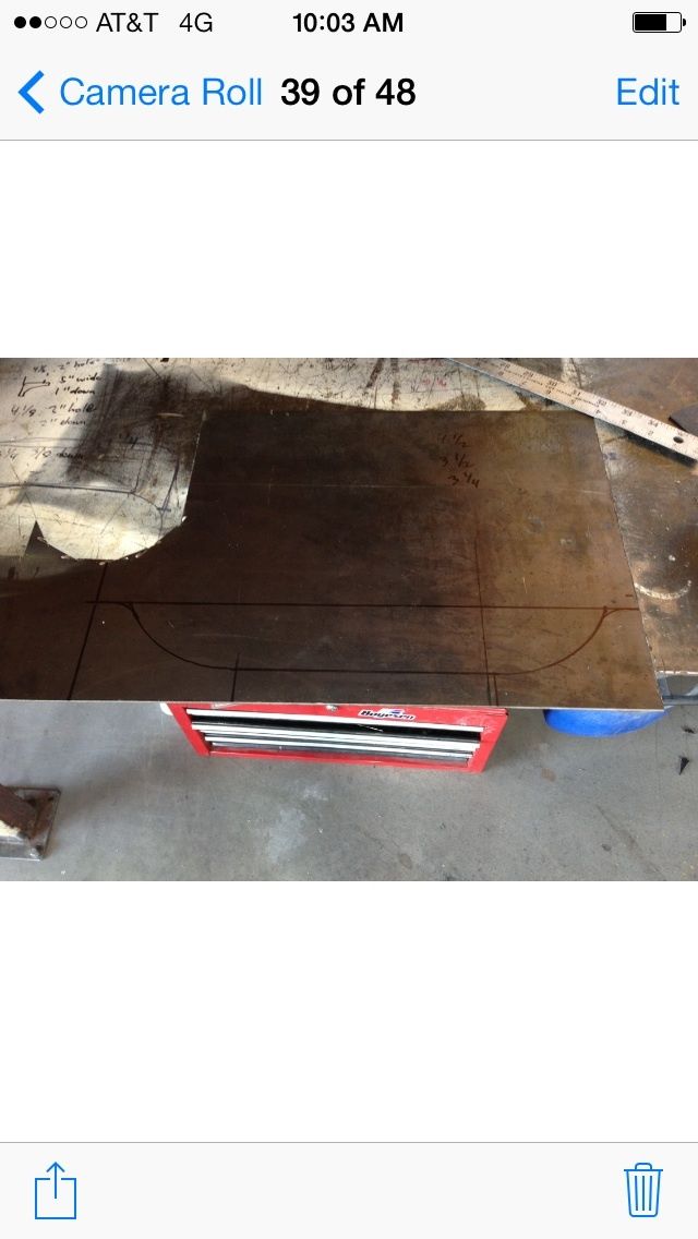

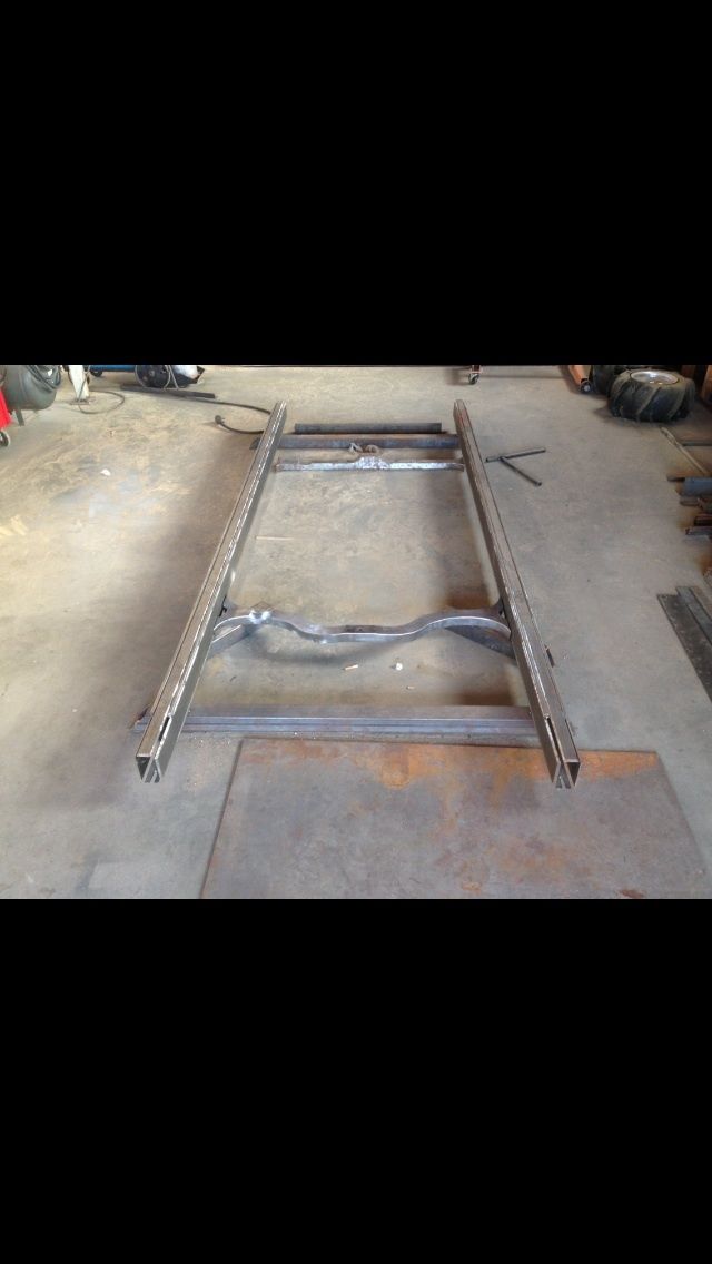

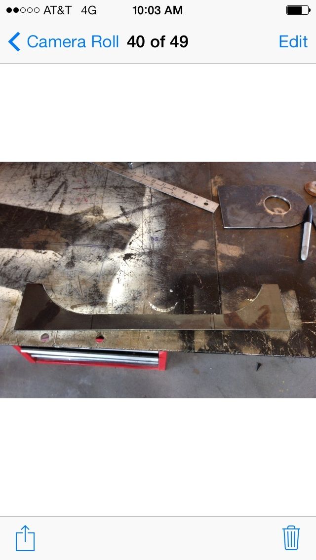

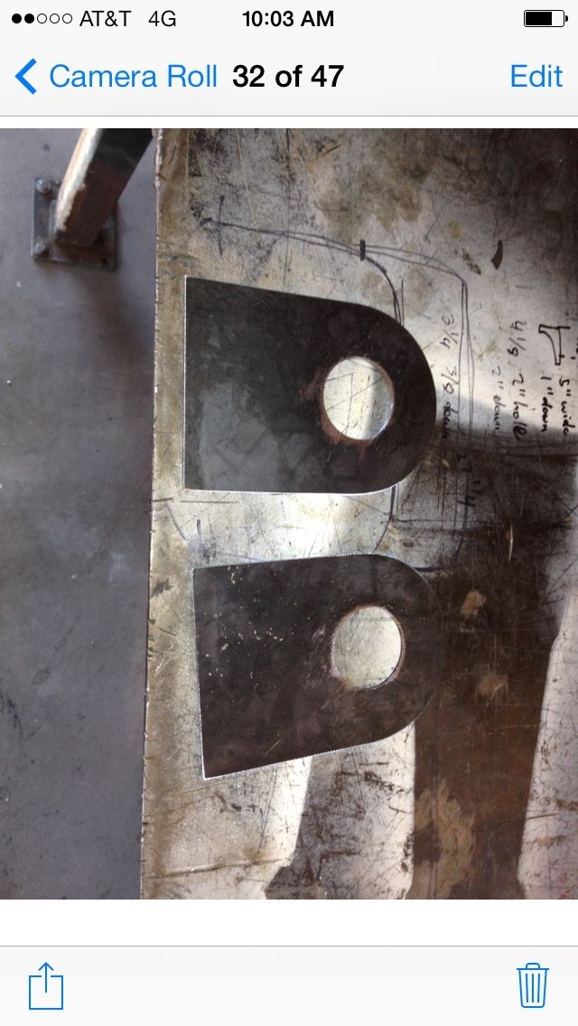

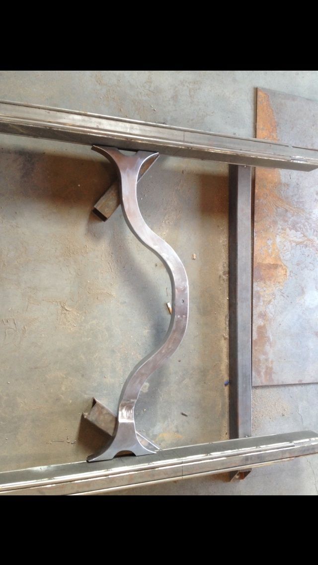

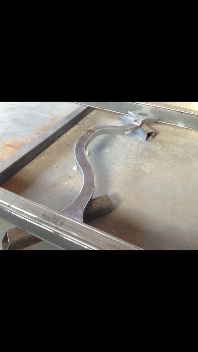

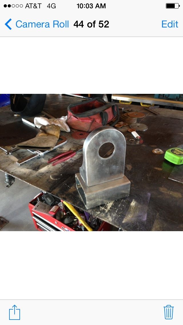

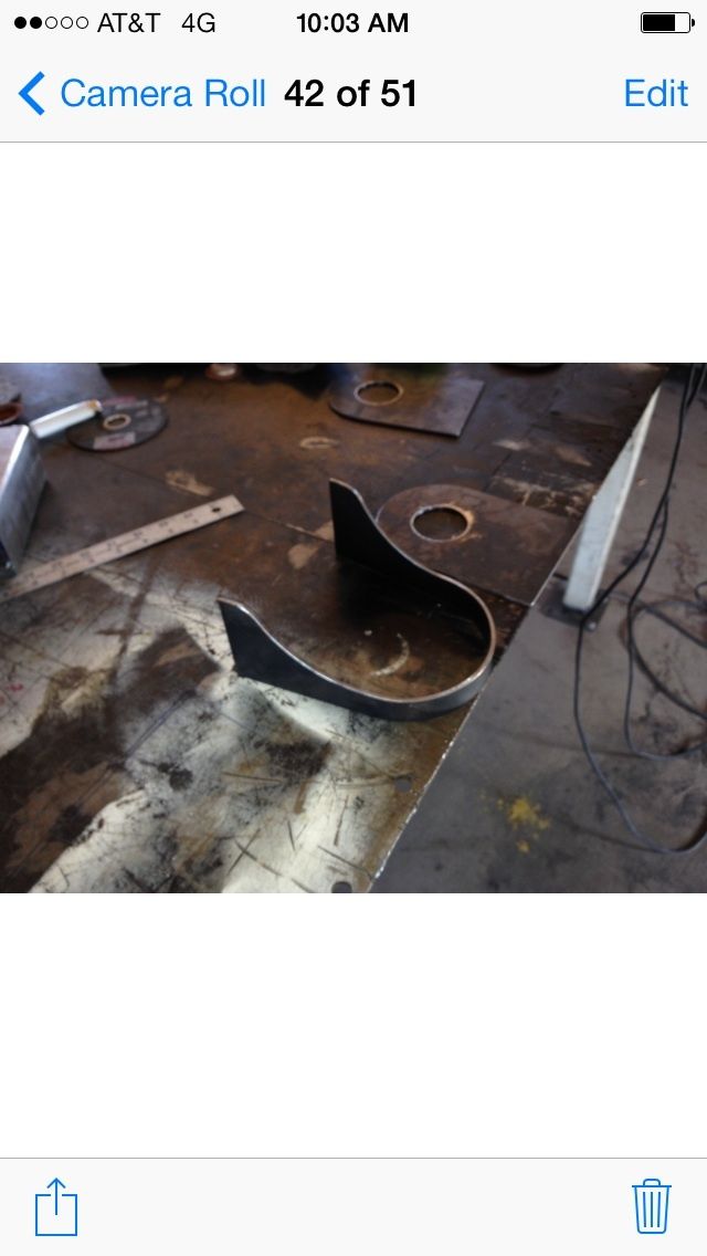

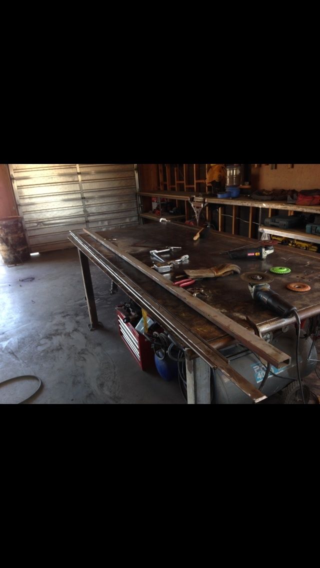

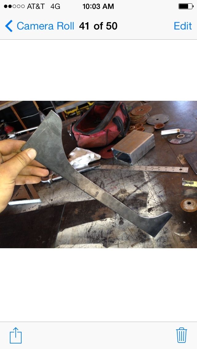

Well didn't get home in time to get my order form the local welding shop so did what I could with some steel I had, started the body mounts but only had an hr to work on them
E
exoticiron
There's one

Bottom
