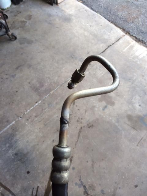

Hi, I'm new to the forum but not a rookie. I thought I would share the build of my shop truck. I bought Lowered without the semi rims and intierior. The truck used to have a 350sbc with a sm465 4 speed transmission. I'm now in the process of swapping to a L92 6.2L LS engine (2009 Escalade engine) backed by an 4L80E.
The exhaust I built while it still had the stock 350 made of left over pieces from previous jobs.
Tig welded the original power steering box side of the line to The L92 pump side
