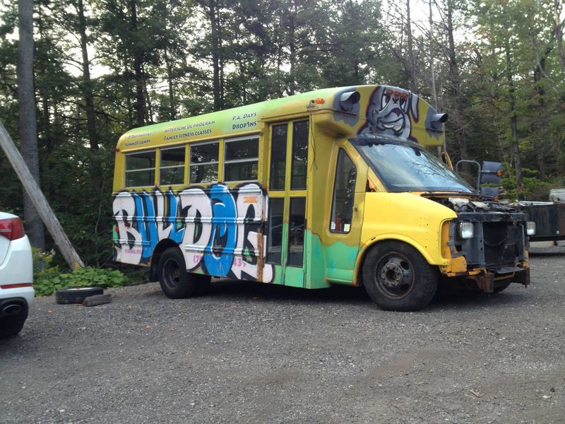

How it currently sits

Haven't worked on her to much, but the interior is now stripped. Air system wired and plumbed and the side door cut flush to the body. Going to go through it tomorrow and get the air system running. After that its time to install the front bags and go from there.

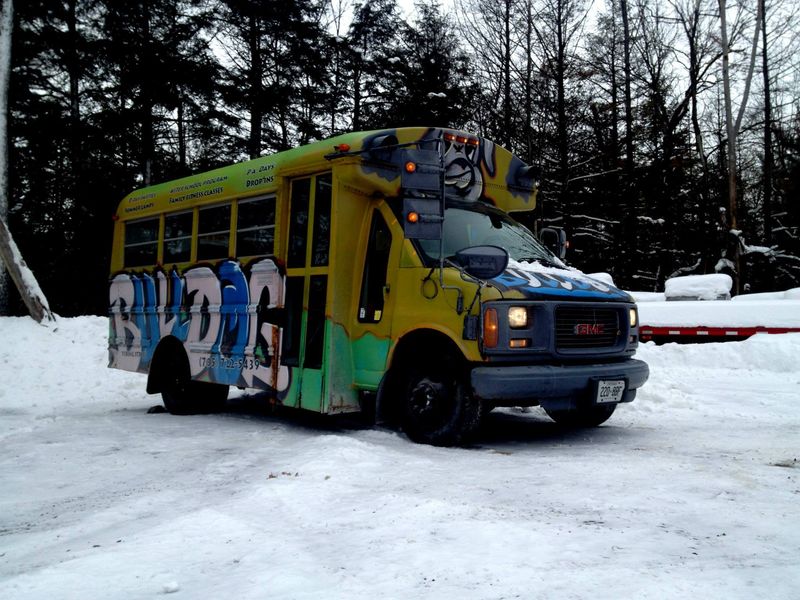

So I figure I'll throw up a picture. I need to dehump the control arms and get drop spindles. On that note anyone know the drop spindles I will need? The bus is a 2000 and the dealer said it was the same spindle as a 1500 chev but I have my concerns about that. I was looking at the Belltech ones for 90-00 Gm 3/4 tonne trucks. Just wasn't sure if anyone could confirm that those spindles would work (#3700). Thanks
Lifted
Aired Out
Rear is to come soon.

Got the front drop spindles in and the passenger side sheet metal cut out. Now to move onto the drivers side and have it on the frame. The rear notch and link bars are on their way.
