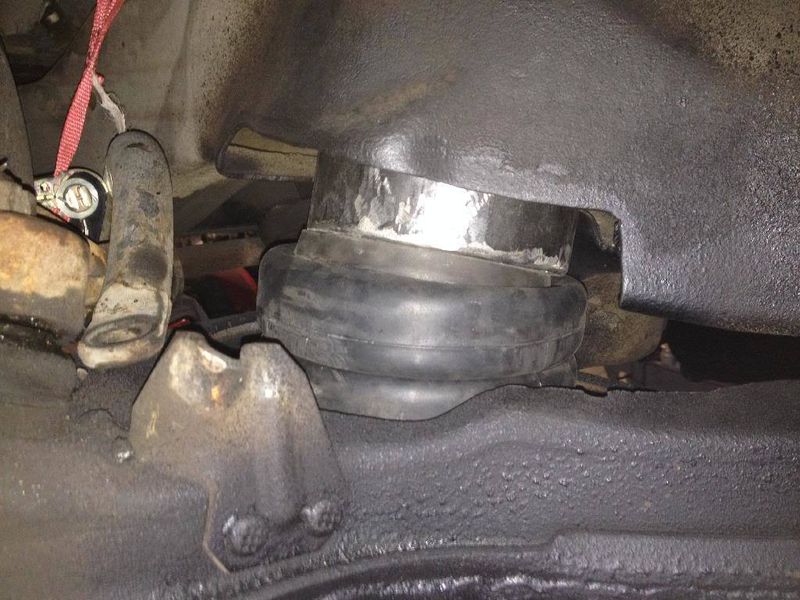

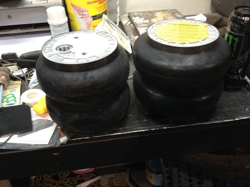

I started on the front bags. I decided to go with Slam Specialties RE7 and RE8.

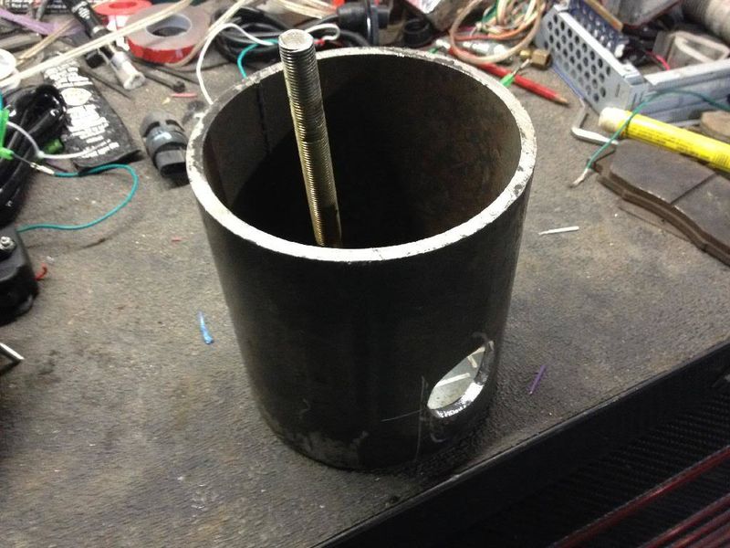

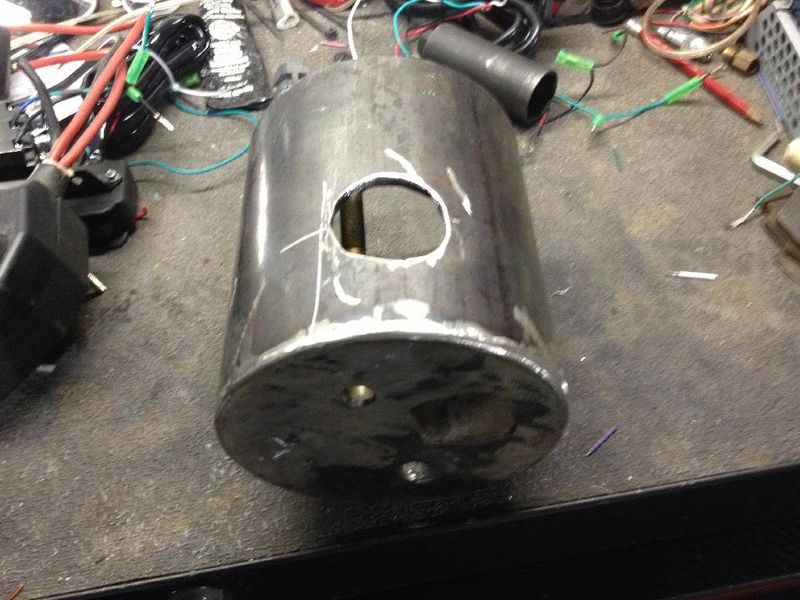

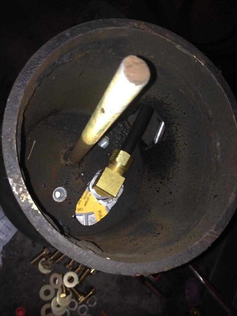

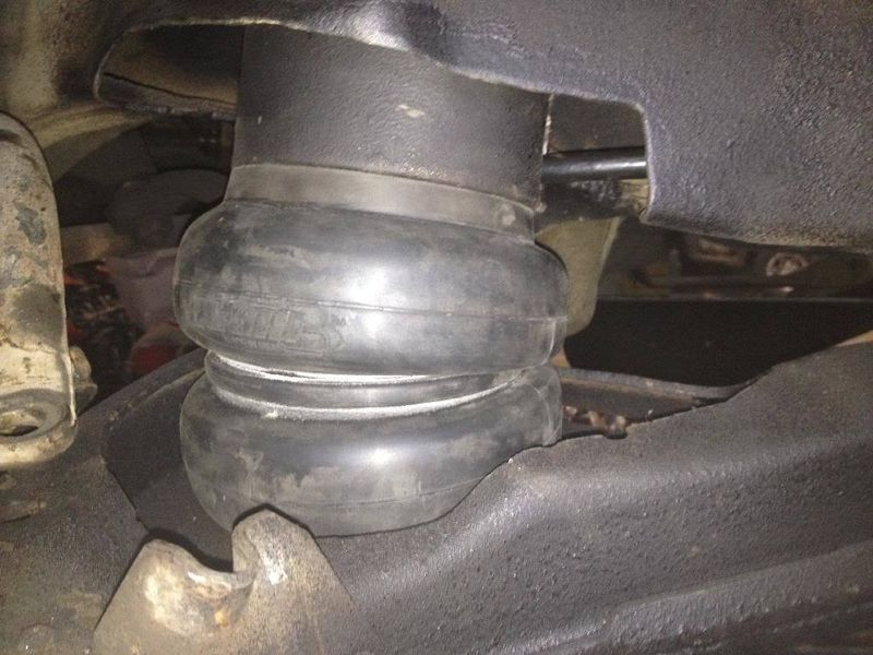

I fabricated the cups with some 5" pipe 1/4" thick and 6" long. All the holes were cut w a plasma cutter so they are not perfect. Modifications were made as I progressed. The rod I got by cutting some new U bolts I had laying around from a previous project.
I mock fitted it all before installing it.

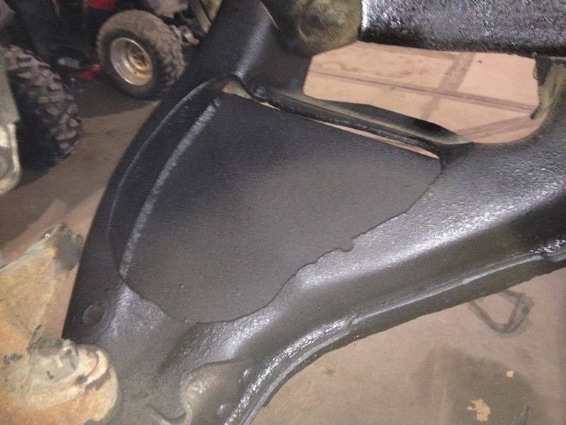

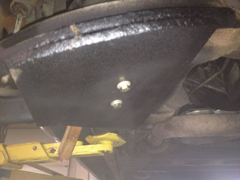

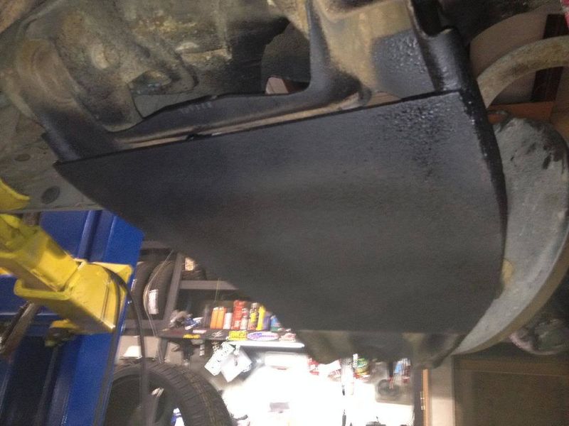

Next I moved to the lower control arms.
I removed the top and used 1/4" plate for the bottom. A generous spray of rubberized undercoating was then applied.
I may have removed too much but I was thinking ahead in case I want to go with larger bags.

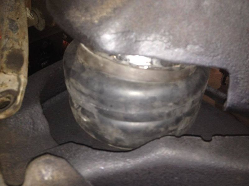

The front is all done and once collapsed the frame right under the engine sits 1/4" from the ground and the wheels tuck in nice. Not quite lays frame but Im happy with the way it sits. Im considering making some modifications to make it sit about 1" from the ground just for fact that I do have to tow long distances and want to be sure I can make it home in case a bag fails on me.
