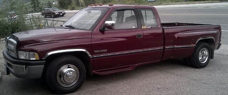

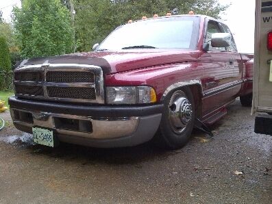

Just a few things its a bit of a slow go on this truck but to be fair I have been build 2 things at one time so far I have had the p pump rebuilt good for 620 HP stock turbo @42 psi cummins stage 2 cam arp head studs and some other goods

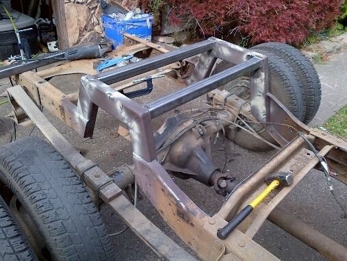

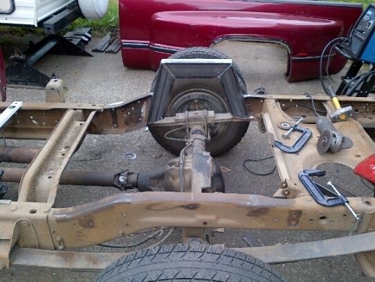

Lowered it 4/5 inch shaved the tale gate and frenched the rear plate I just completed the rear notch and next payday I will probably get some bags in there

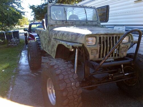

And a few of my other project 88 yj on 42s 4 link rear and 3 link front 305 on propane Dana 44 and corp 14 rear 16 inch fox 2.0 air shocks ... bla bla bla haha

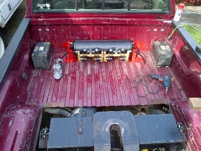

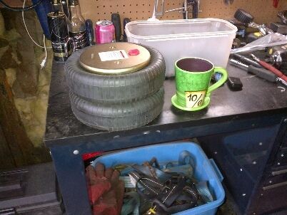

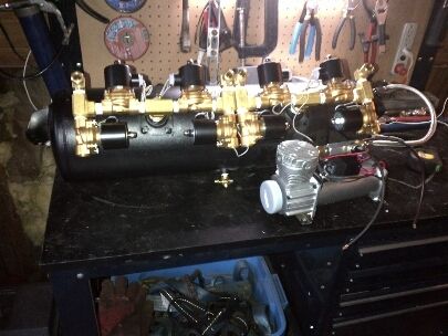

So I got some goodies from air bag it.com
1 DC 2500 compressor ,4 3800 5000 lbs air bags 1/2ports
8 1/2 valves ,switches and relays ,$800 to my door . I would highly recommend them to any one .

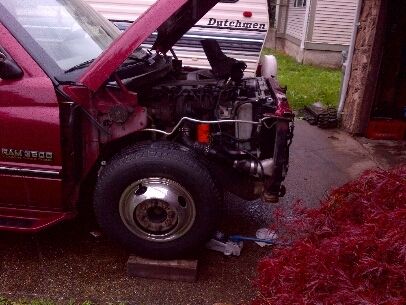

Anyways I got home and tore in to it this was over a few days
covino's avatar
covino

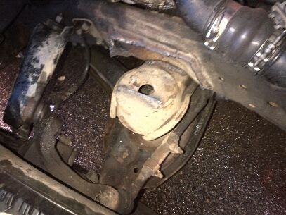

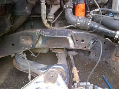

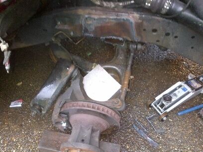

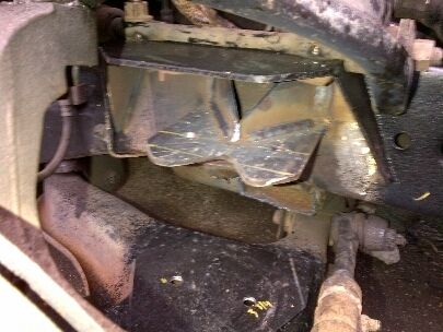

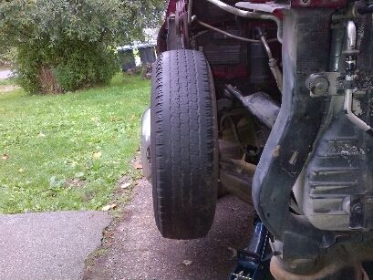

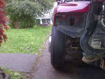

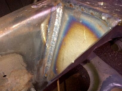

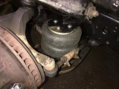

The reason I cut the upper control arm mount off is because of the ridiculous camber and ball joints binding at full drop. I don't plan to drive it in "show mode" but I hate the look of mad camber .., besides this also gave me more room to work with the masave air bags also it let the front sit down 2 more inches so now my front x member is on the ground with no drop spindles

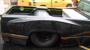

This pic shows the camber I don't care much for lol but still a very nice work ... This use to be a ram 1500 converted to a 3500 and body dropped

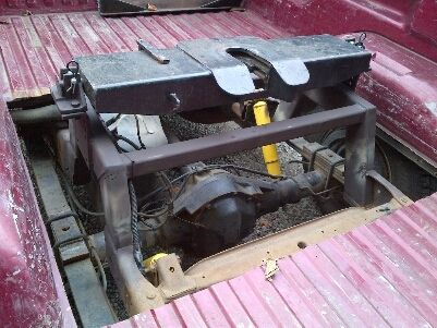

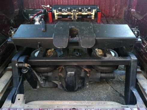

5th wheel installed and bed mock up

Thanks buddy all i t took was a kick in the ass and now I'm just rolling threw it . for my rear notch I just went to metal mart and got 8 ft of 2x4 by 1/4 and 8 foot of 2x2 by 3/16 square tube . all in all with some during discs where $86 long story short much cheaper if your willing to build everything
