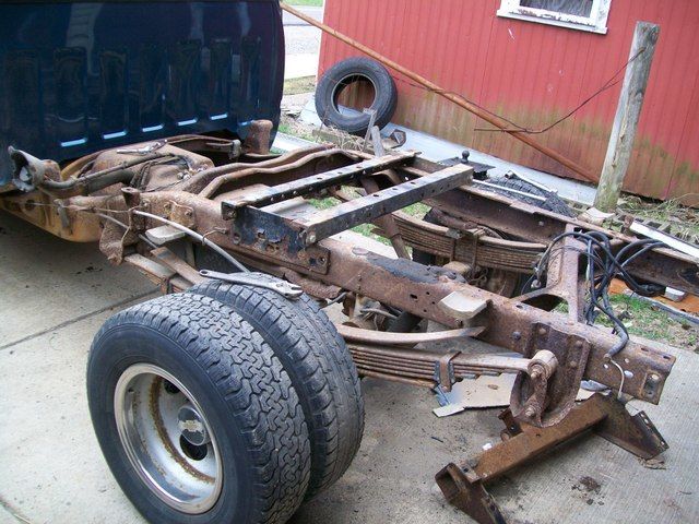

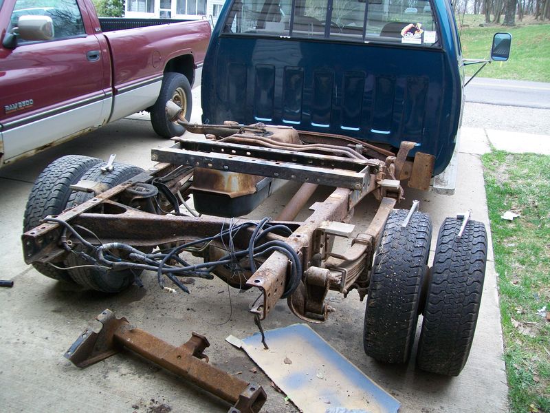

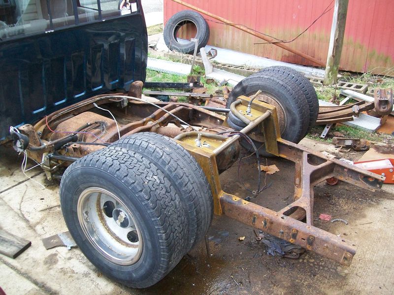

Ok so I'm a lil later than promised but here's some pics.
Got it home and tore down, have a pic somewhere of what it looked like when I pulled it in but I'm terrible with pics and I'm sure all you guys know what a factory truck looks like.
You can see the Cummins drivetrain donor in the driveway beside the dually.

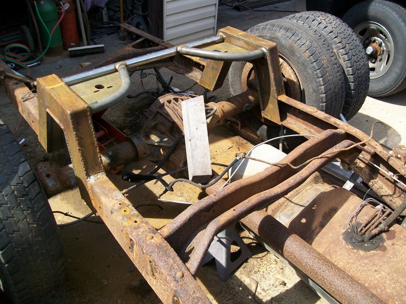

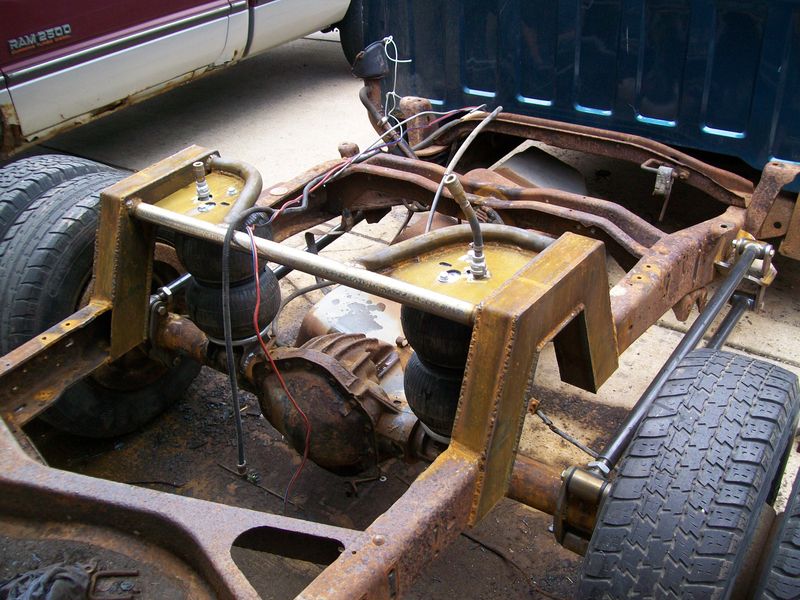

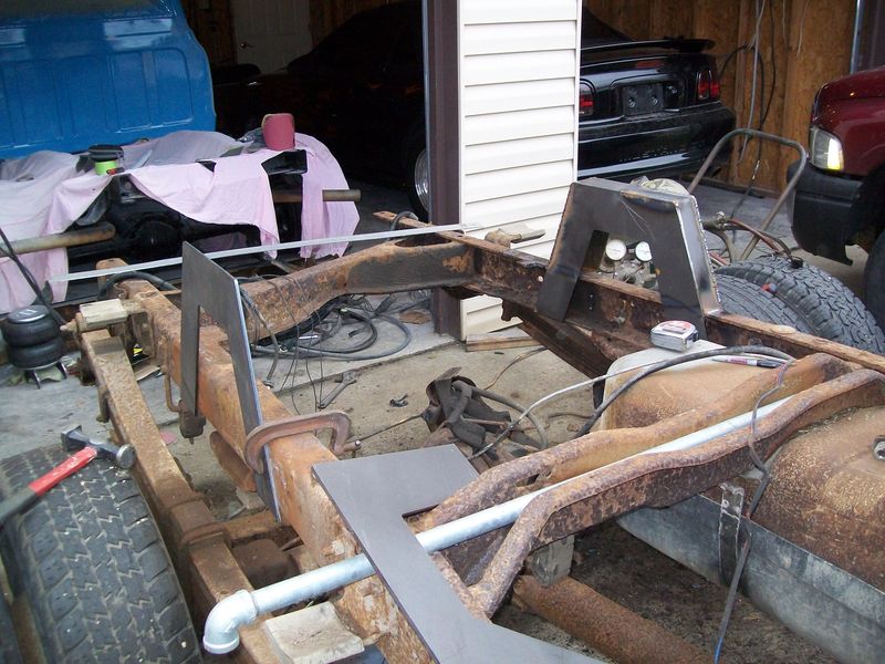

So now the rear is pretty much done for now.
covino's avatar
covino
Got a track bar going in there too right . And what bags you running in there I just did my notch and looking for options?
tow?n?low
Yup bar is on now.
Those are the bags I'm using front and rear.

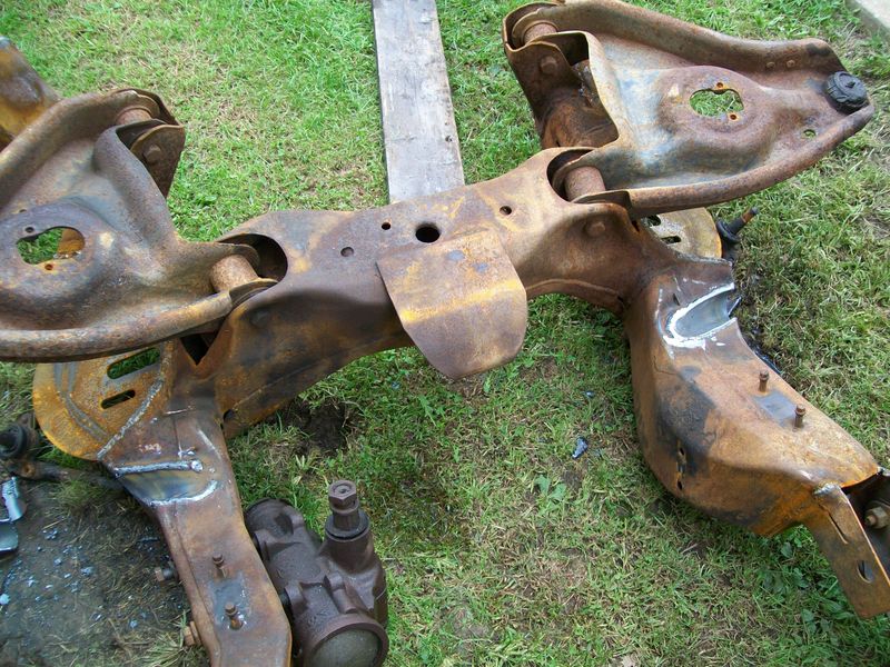

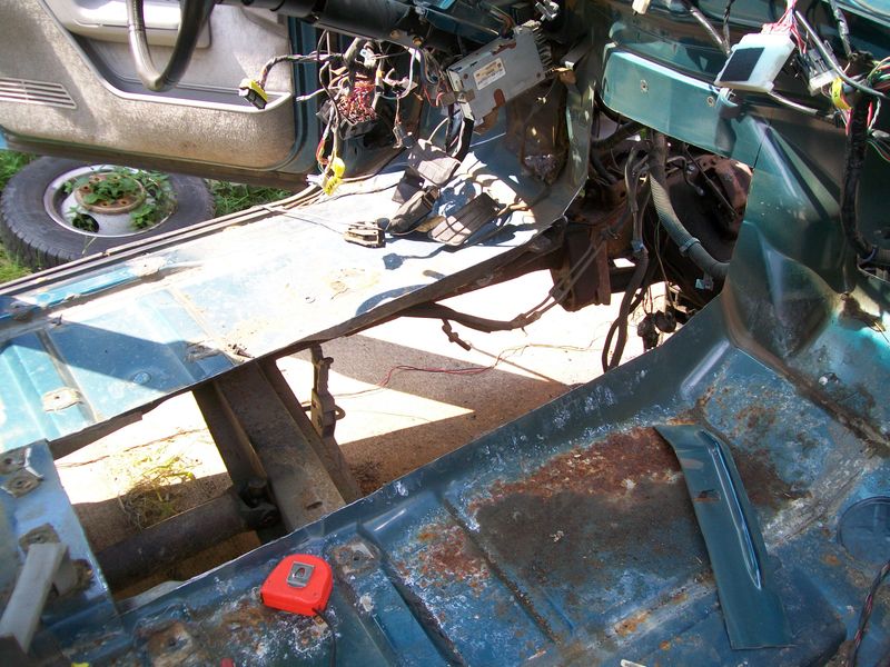

tow?n?low

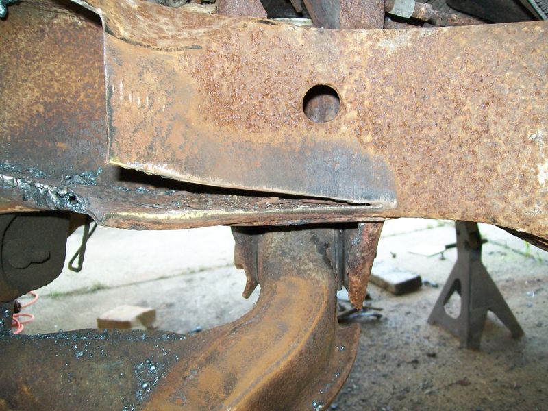

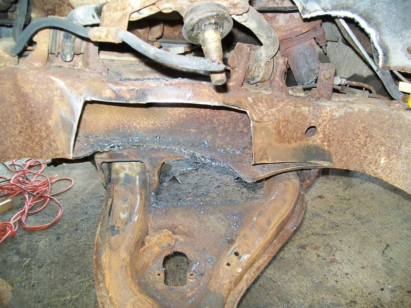

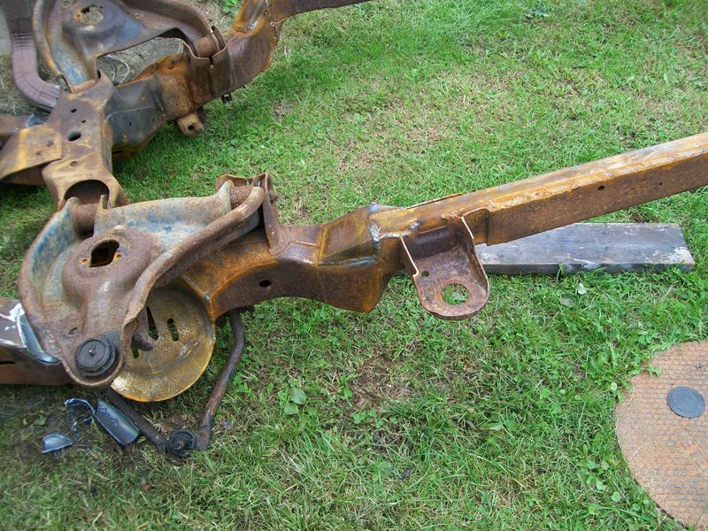

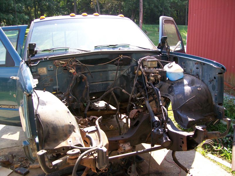

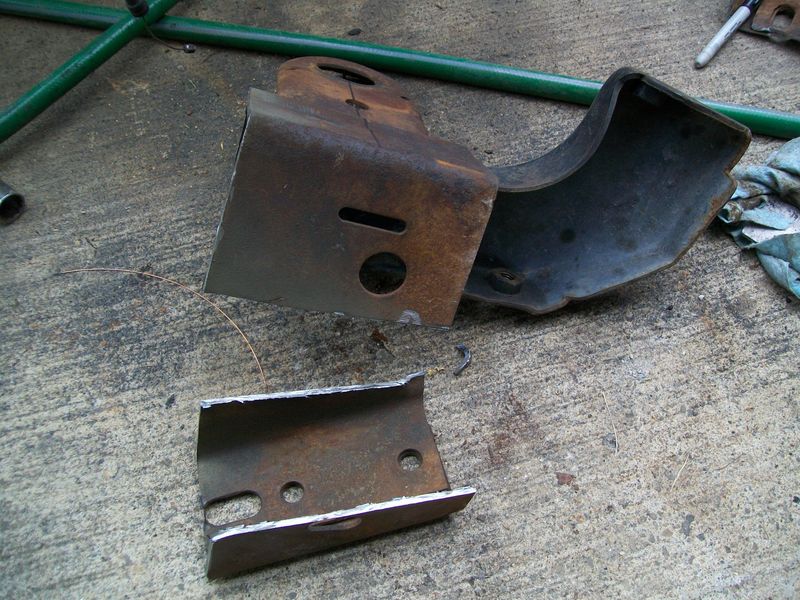

Opened up the front today for the bags.
Made a pie cut in the frame, removed some metal, beat it back together and welded it up so the control arm doesn't hit it when folded up.

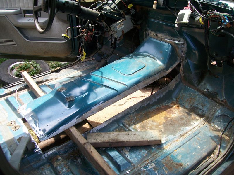

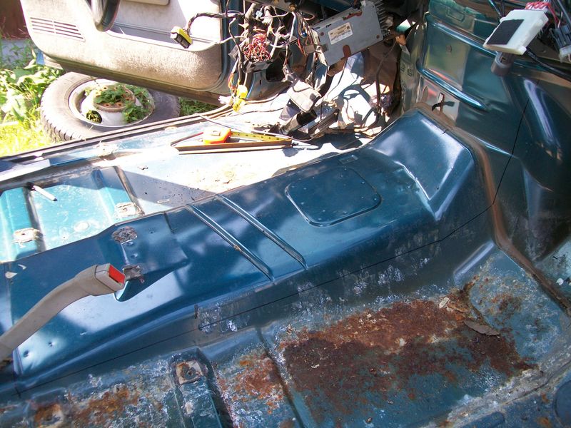

Motor and trans out.
Tranny tunnel cut out, raised 4 inches, and temporarily set in place. Don't want to make it permanent until the diesel and 47rh is in place.
Front frame horns trimmed and lowered.

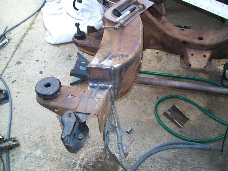

tow?n?low

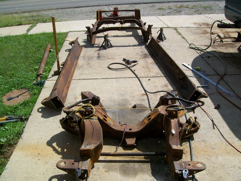

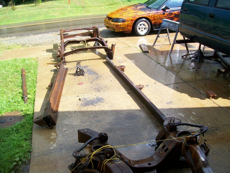

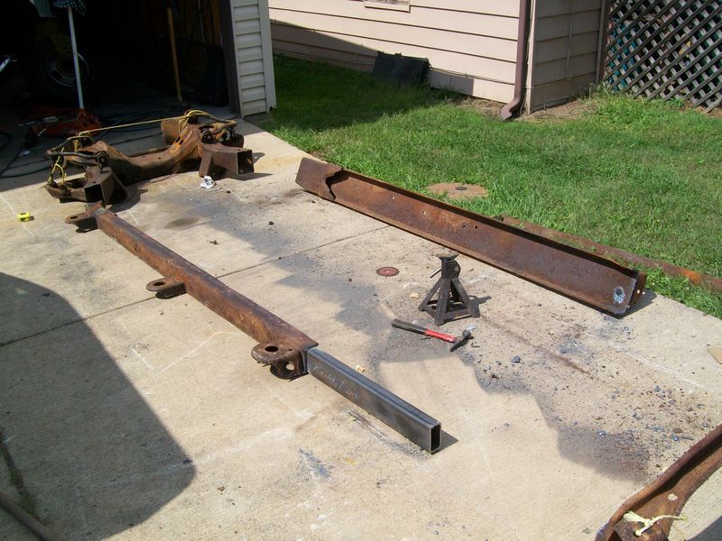

Today I got the frame out from under it.
Man, being by yourself, with only a jack, some jack stands, and a couple beams completely sucks to pull a frame.
Anyway... frame out...
frame hacked...
welded in some 2x4x0.25 box steel and trimmed off bottom edge of frame...
Gotta love the freak rain storms out of no where with the sun shining that put an end to production...
I at least got both rails made. I'll weld it all together tomorrow with the Z and plate it all, and likely have to notch for tierods.

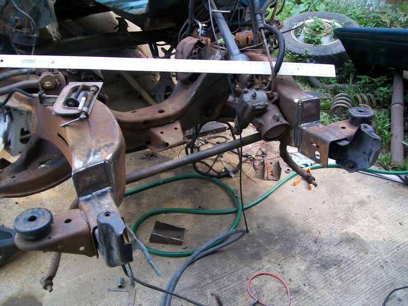

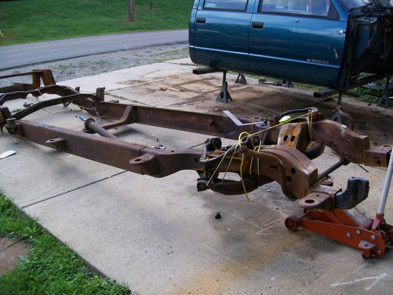

tow?n?low
Ok got the frame finished up today. Hopefully get painted this evening and back under the truck tomorrow and hang all the suspension and see how it sits.
Rails reattached to the front and rear clip, flipped it over for the easy underside welding. Went ahead and notched for tierods, and plated the frame inside the z with 1/4" plate
