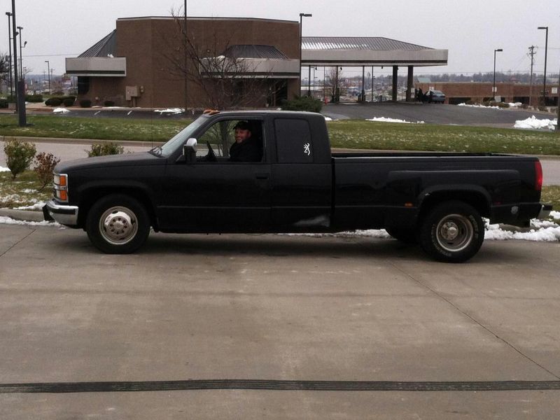

Here's a pic of me and the truck, right after I bought it
Here it is 3 days later, leaving on my friends flat bed
