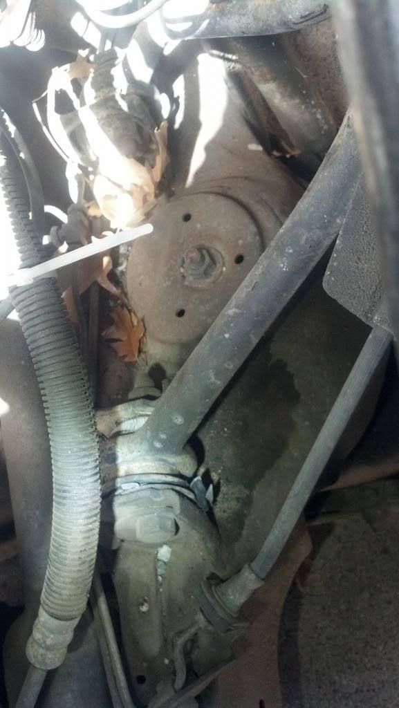

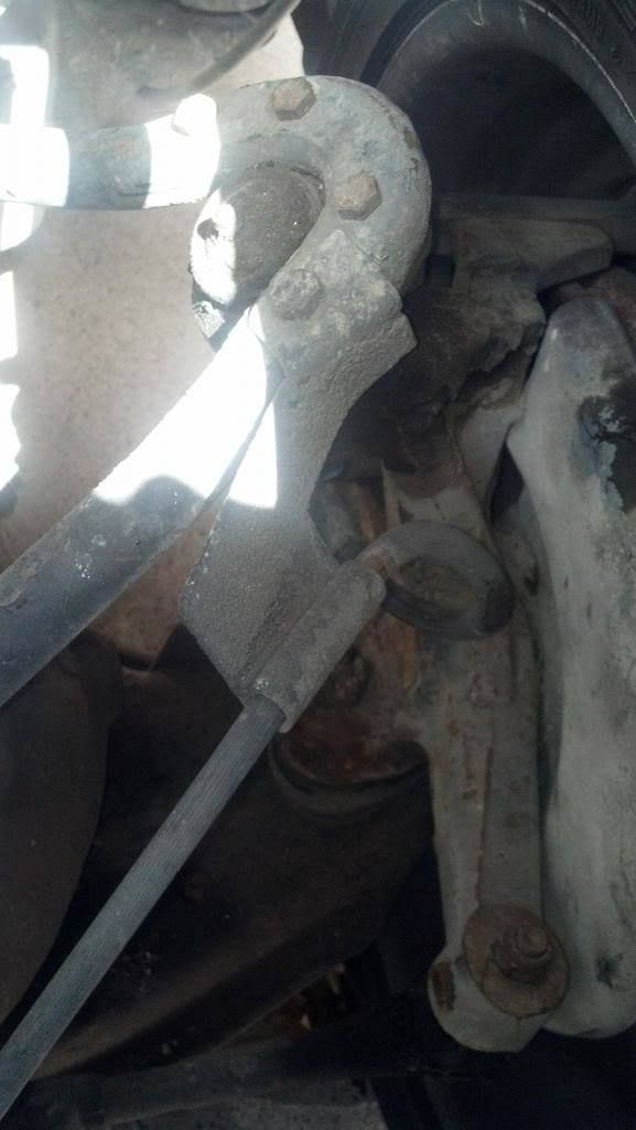

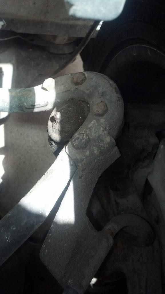

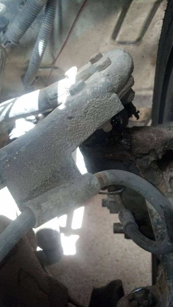

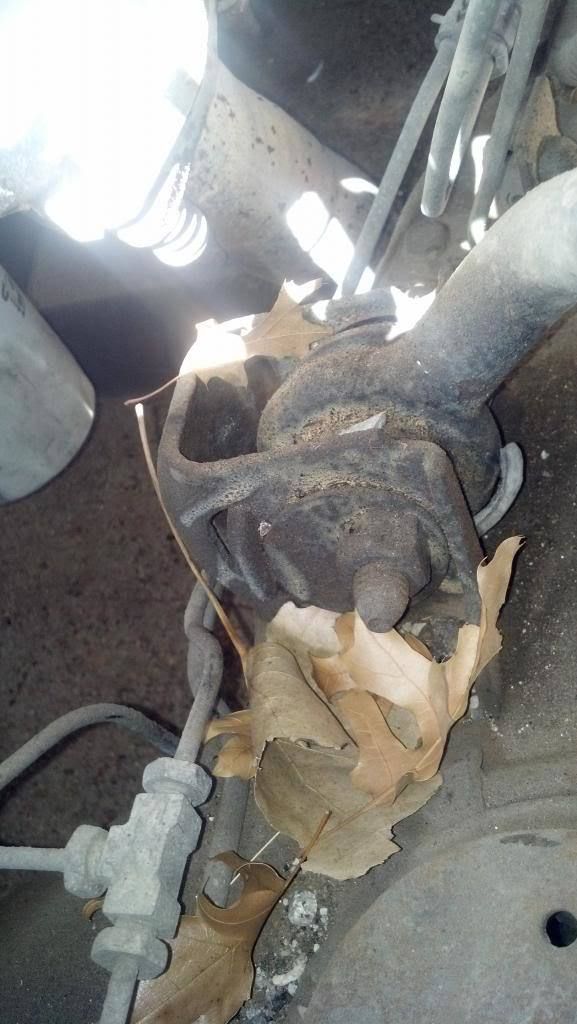

Can you identify these upper control arms? if so, what ball joints will I need so I can rebuild the front end? Also, can I use stock control arm bushings parts? (Polyuerathane Energy Suspension)

Those are factory a arms man. One ton a arms

Really? I never knew tubular came stock. Learn something new everyday! Am i safe running stock?

They aren't tubular. They are solid. Looks like you have stock lower arms too. They have been cut for clearance, and probably has flat plate welded in place of the spring registers. I use MOOG products for all my suspension. They do have upgraded components too. Bushings, sway bar bushings etc.
