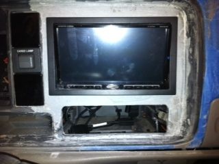

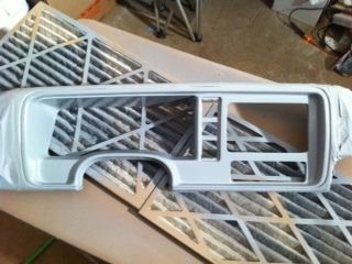

Have any of you decided to take on changing your den and a half to a double den? If you have Let me save you some trouble. This is a link to a kit to make things much easier. I wish someone had told me about this before I took on this task. Let me know if you guys have any questions on how to make this easier. I will take more pics as I start to complete the dash. Have lots of pics of the build. I have completely rebuilt my suspension. I had no choice my upper ball joints kept braking. Thanks Michigan Metal Works. FU! MMW . Stay tuned for the pics of all three broken ball joints.

503 if you really want to do it yourself you can save alot of money and time if you want my advice. I will walk you threw step by step and take more pics so you can what has to be cut and what has to be fabricated. I wish someone would have posted a step by step of the Double den mode. Would have saved me alot of time, but that being said I learned a ton about fiberglass working with plastic. Let me know I will hook you up.
