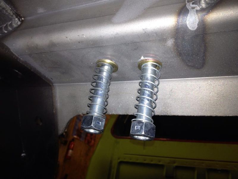

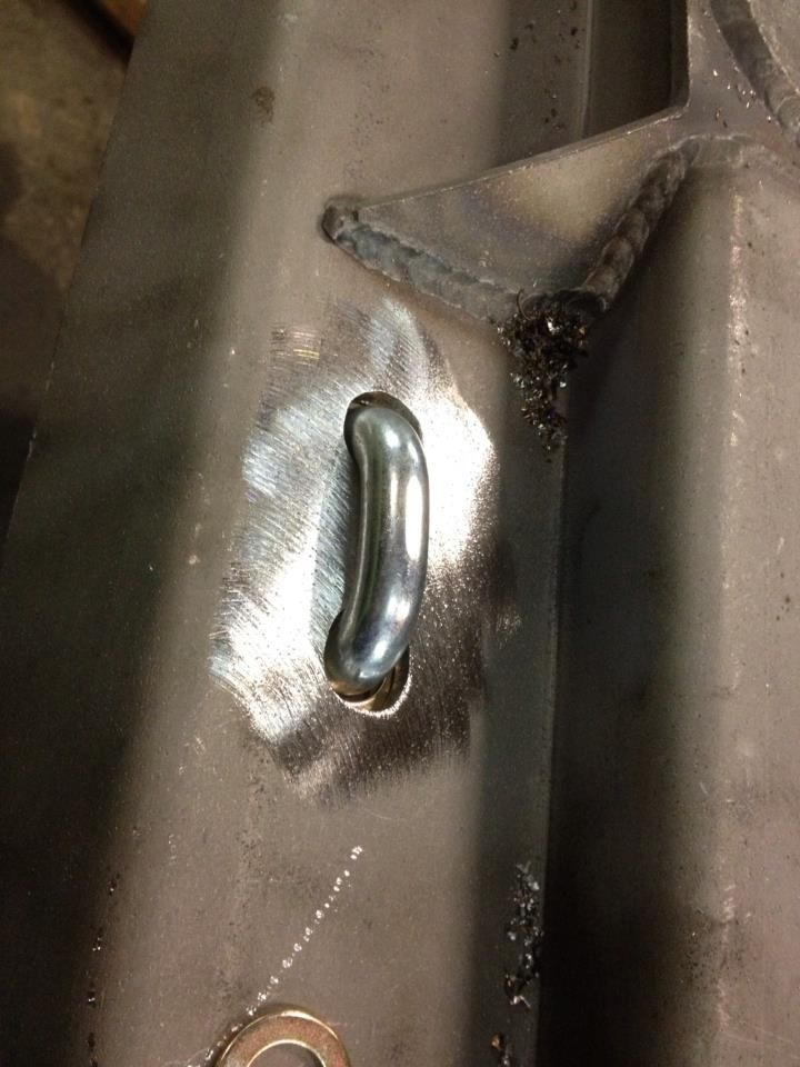

realized there was no where to hook the trailer chains to on the bridge plate. So I added some spring loaded "U" bolts.

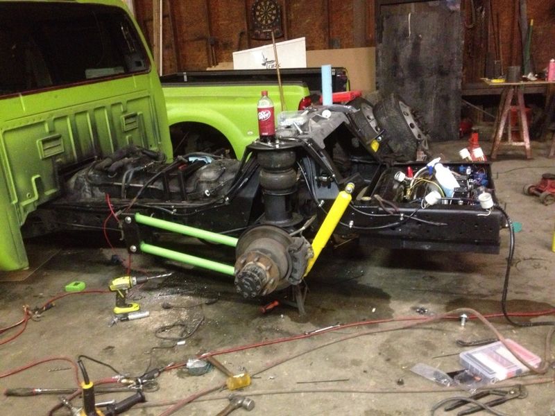

Got a few more things done in the last couple of days. Not much but a lot if that makes any sense.
Done:
-Fuel tank back in
-Fuel lines re-routed
-breather lines hooked back up
-brake lines re-routed and hooked up (still need to bleed them)

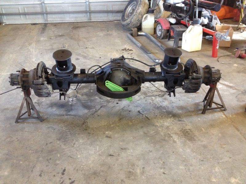

-E-brake lines routed and hooked up (drilled holes thru the four link bracket and used the four link bracket as the e-brake bracket)
-Four link bars adjusted and in (Adjusted the pinion to +3* since the trans and front drive shaft is at 0*)
-Watts link is in and set
-Dodge 3500 shocks are in (they had the required travel needed to work for the setup)
-Drive shaft is back in and bolted down
-Painted the rear axle w/ Zero Rust
-Finished drilling the bridge plate for the U-bolts for the tow chains
-Refilled the rear axle with gear fluid
Still got a lot of little things to do
