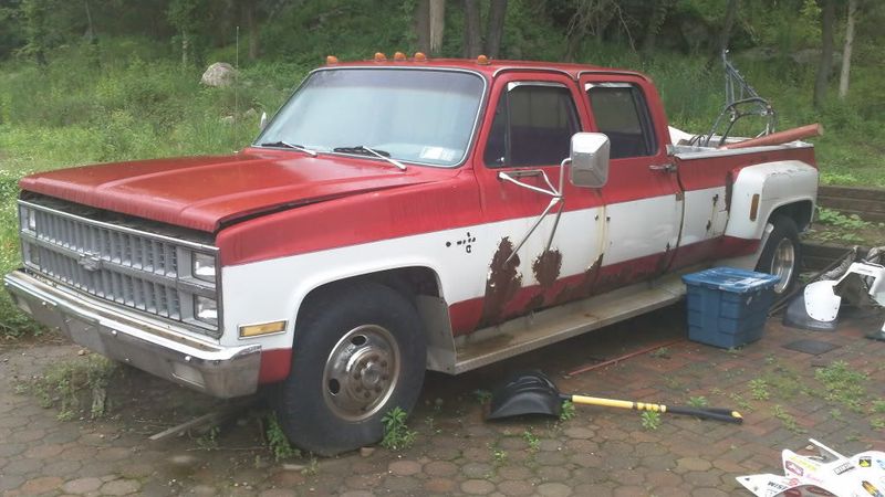

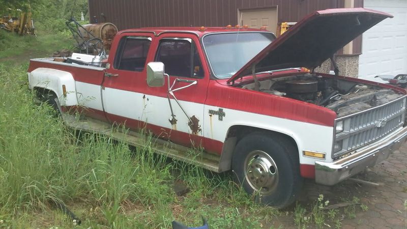

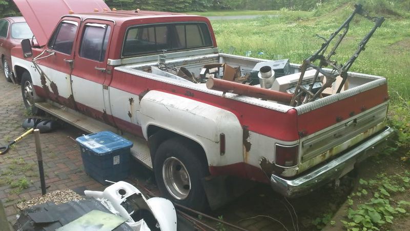

What's up guys, I figured I would join up here to see what's going on in the Chevy truck world. I recently inherited my dads old 1982 C30 454 Extended Cab, Camper Special It has been sitting for about five years now. My dad took this truck off the road because the brakes went out and he no longer really needed it to haul around stuff. So now I am reviving it to it's full glory once again! The previous and first owner towed around race cars with it, so it must be a little depressed to go from that lifestyle to sitting around for years. haha

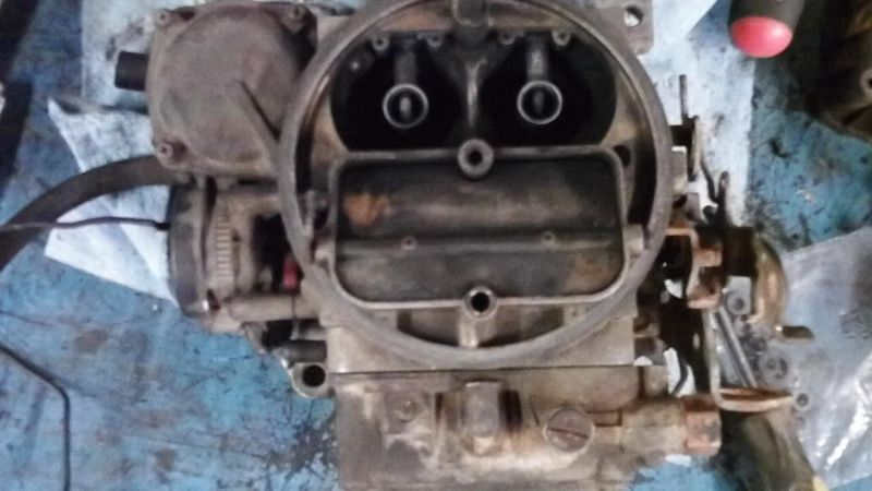

I went to start it up last week and it fired right up with starting fluid! Then the five year old gas flowed into the carb and made the truck run like crap. So I siphoned the old gas out and I am in the process of a carb rebuild. I am kinda a newbie at trucks, but I am sure you guys will help me out!
So here is my plan for this beast! I dunno if I can post pics right now with my low post count but soon I will. The brakes gave out on this truck and it hasn't ran for 5 years. So the short term plan of attack right now is get the engine running smoothly and make sure the truck can stop under it's own stopping power. Right now I am waiting for a new float, the secondary float was broken, and float needle was clogged up and jammed open. That would explain the gassy smell when it did sorta run, I knew that smell wasn't me! :p So after that the truck needs some body work done, the floorboards have holes on either side that you can literally fall through if you miss-step. That's the plan for now, I am sure a "Mod bug" will take over me and this restoration will take a turn towards the expensive balls to the wall build. For now though I am trying to get the thing on the road, pics to come soon!

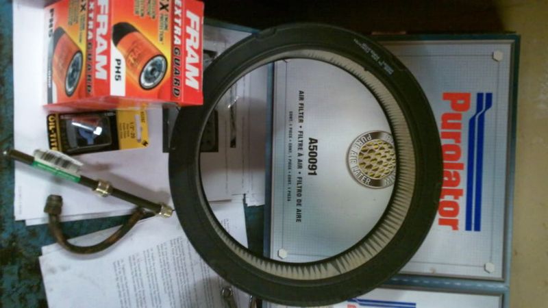

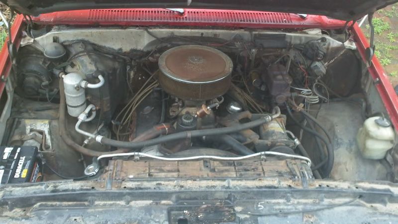

New parts run! Air filter, oil filter, oil drain screw.

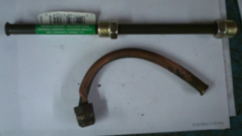

Here is a fun one, he rigged up a fuel filter outside the carb, then used this copper tubing to route it to the carb. I am replacing it with steel because the copper twisted a little bit.

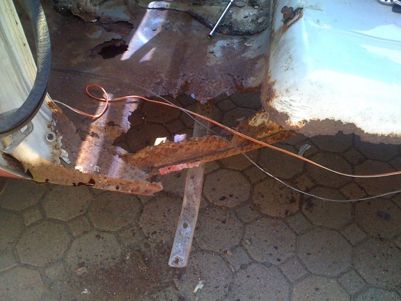

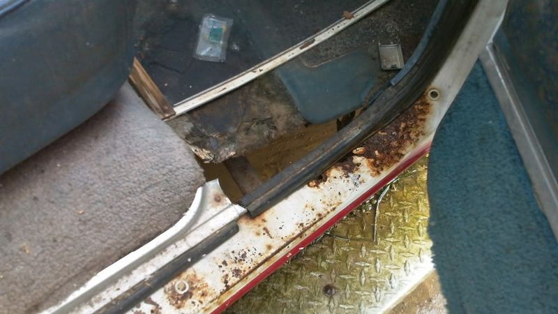

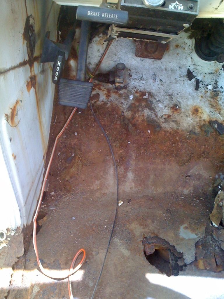

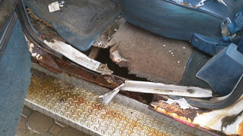

Some rust and holes in the floorboards that I have to fix eventually

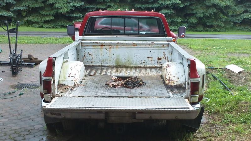

I love a clean bed!
Fresh rebuild carb minus the broken secondary float. That plus the sticky needle is probably why that was flooding :rolleyes:

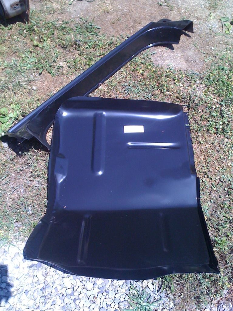

I figured that I would start working on solving my rusted through floorboards problem. I found some replacement ones for pretty cheap here.
That's a kit which is pretty much what I need. Then for carpeting when I am done.

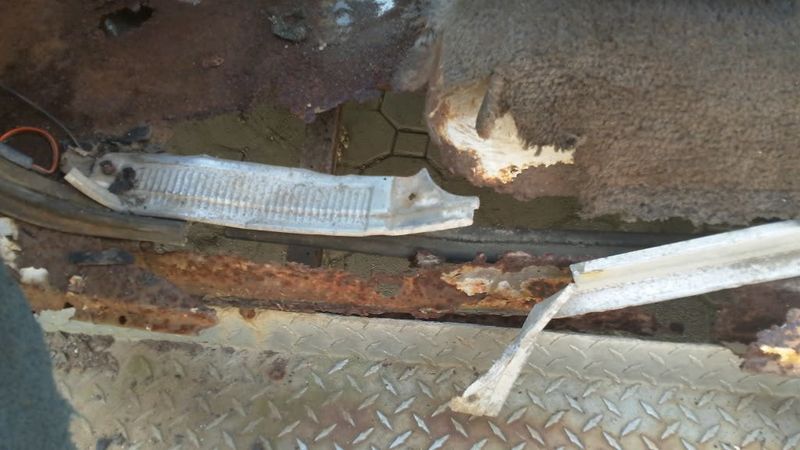

So here is the progress I made it uncovering all the rust
The basic plan for that sub-project is to cut out all the rusted parts, trim the new floorboards, rocker panel, and so such, then weld them all into place, then for the final touch install the new carpet! Thoughts?

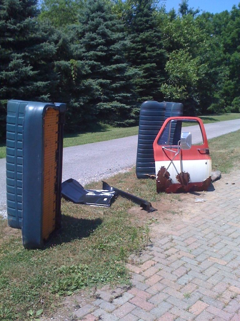

The seats and drivers side door removed

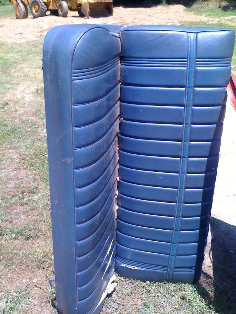

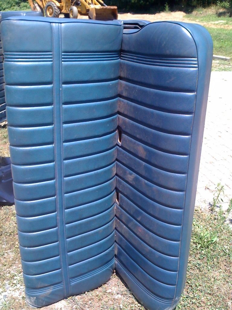

Back seat. It's a little dirty but no rips or tears!
New drivers side floor pan and rocker panel to be cut and welded in
Front seat, it has a couple little tears at the bottom left of the screen.

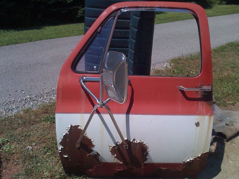

Me thinks this drivers side door needs to be replaced eventually

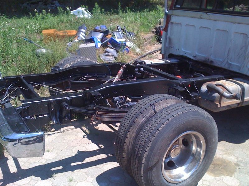

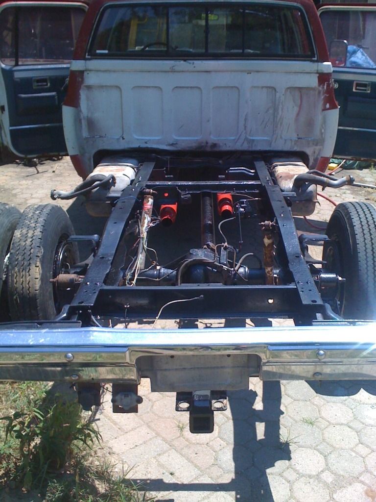

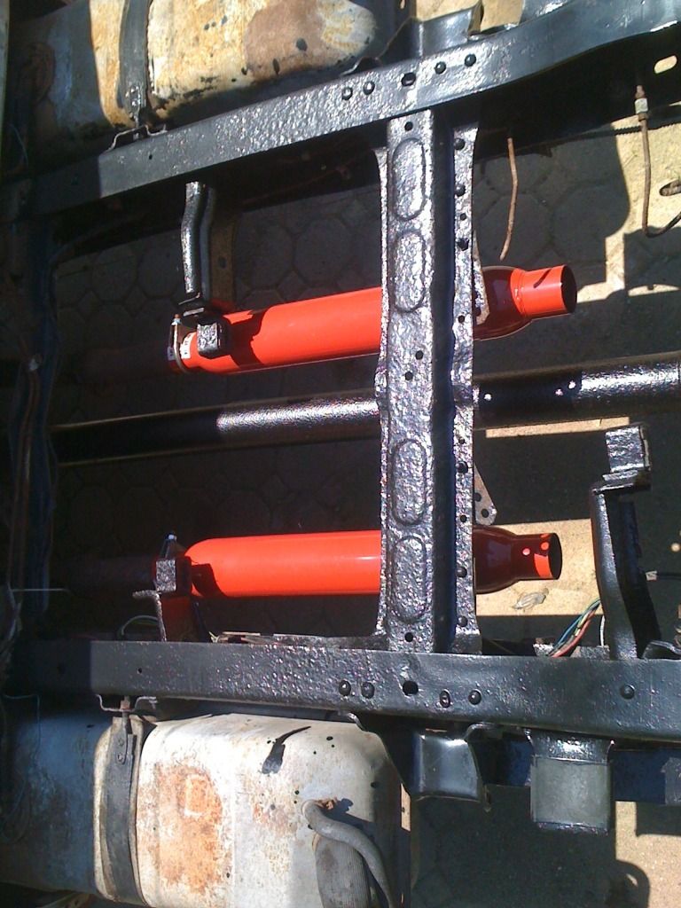

POR-15 painted onto the frame/wheels/driveshaft/axle. Looking sexier by the day!
Notice those two red things? yeaaaaaaa
Thrush glasspacks! Pretty much pipe, with a tiny bit of packing in it to tone the sound, not much muffling going on here! Just pure 454 sound

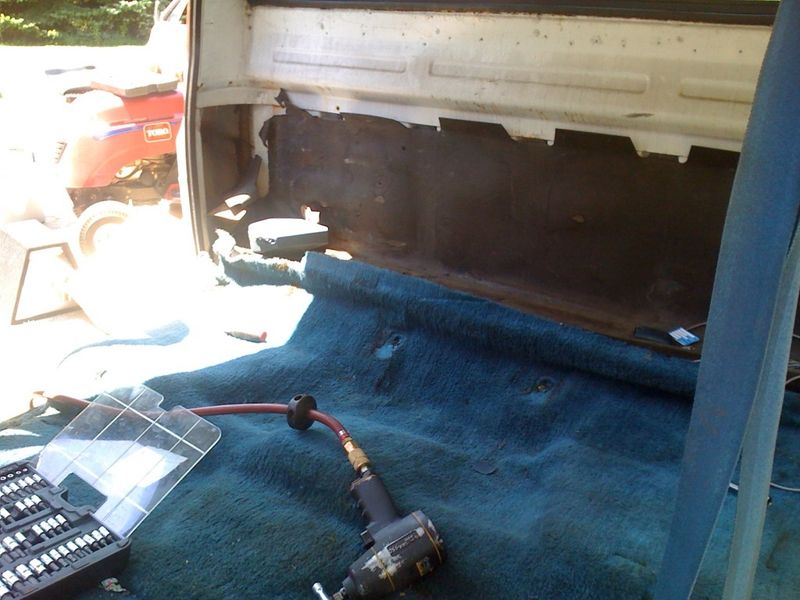

Seats removed, working on removing seat belts to get all the carpet up
Carpet still coming up piece by piece

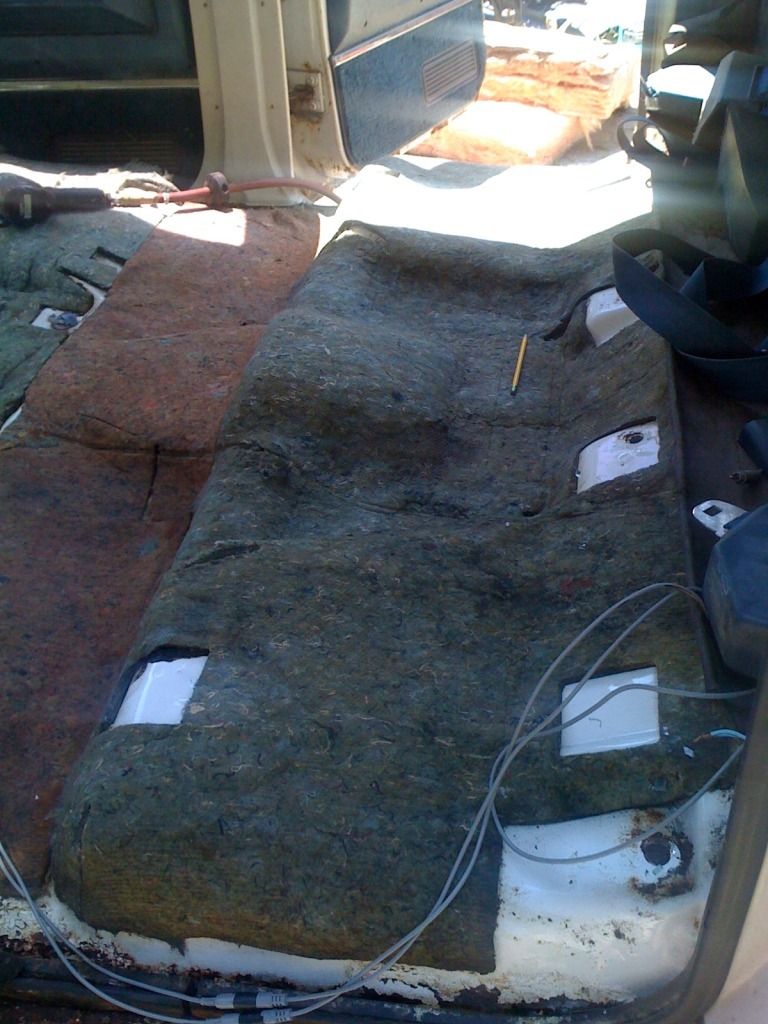

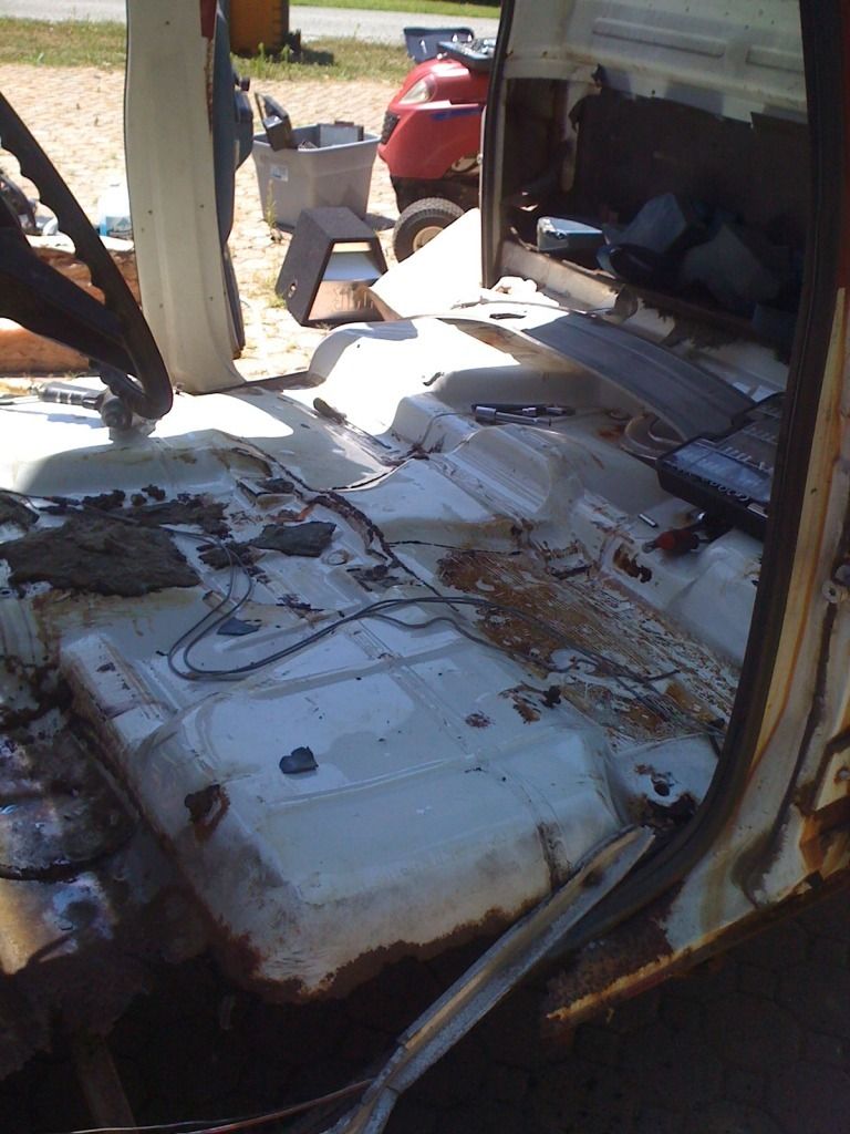

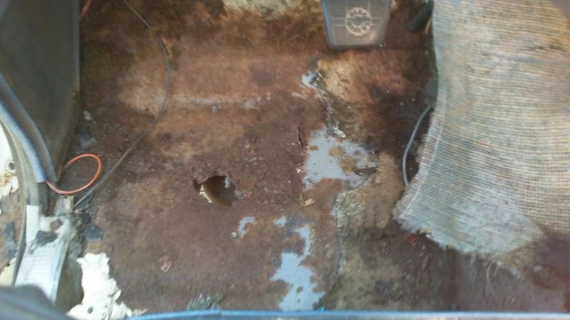

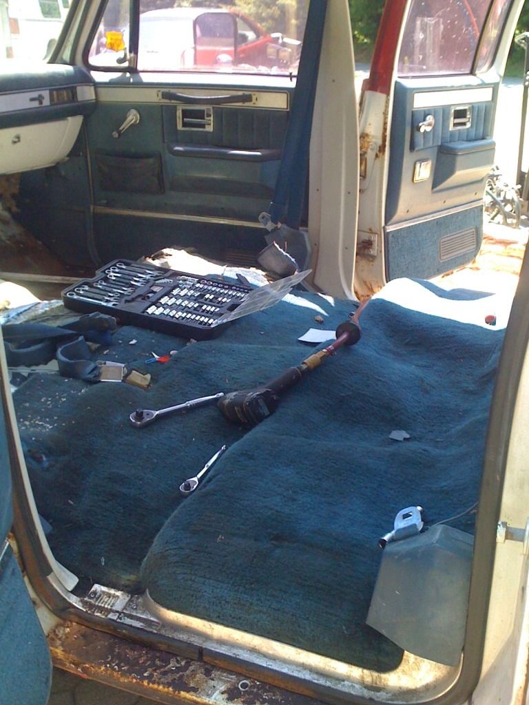

Alright! Carpet is up! Now just removing the nasty sound dampening mats

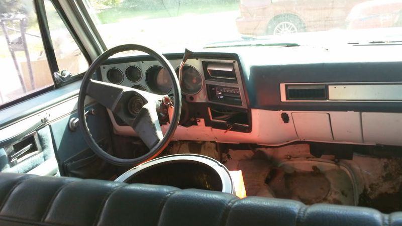

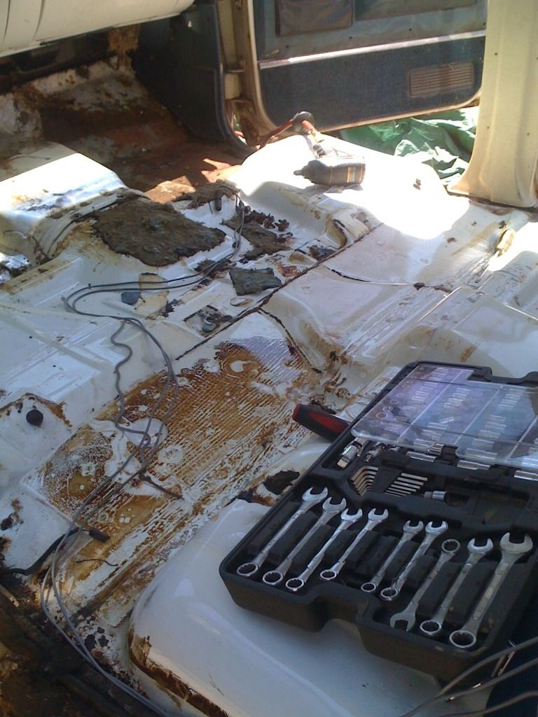

Carpet is gone! Time to inspect the rust damage
Yep, only little pieces of carpet stuck ti the floor

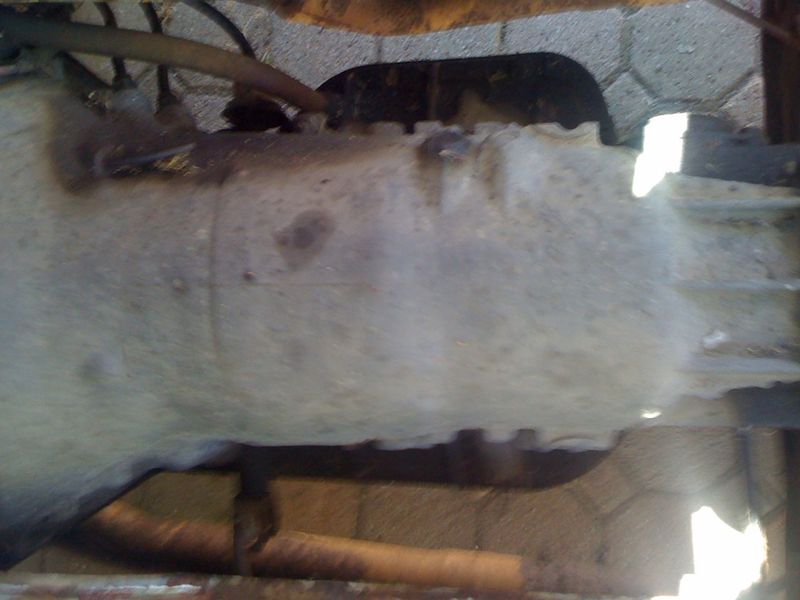

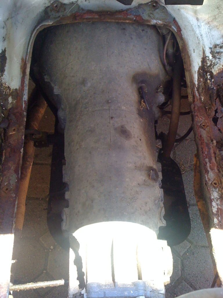

Transmission hump. Noticed the blocked off manual shifter?
Transmission!
toyhauler

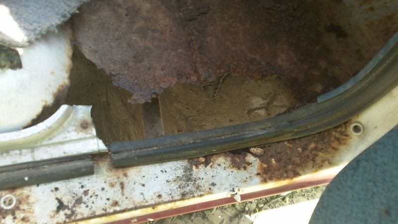

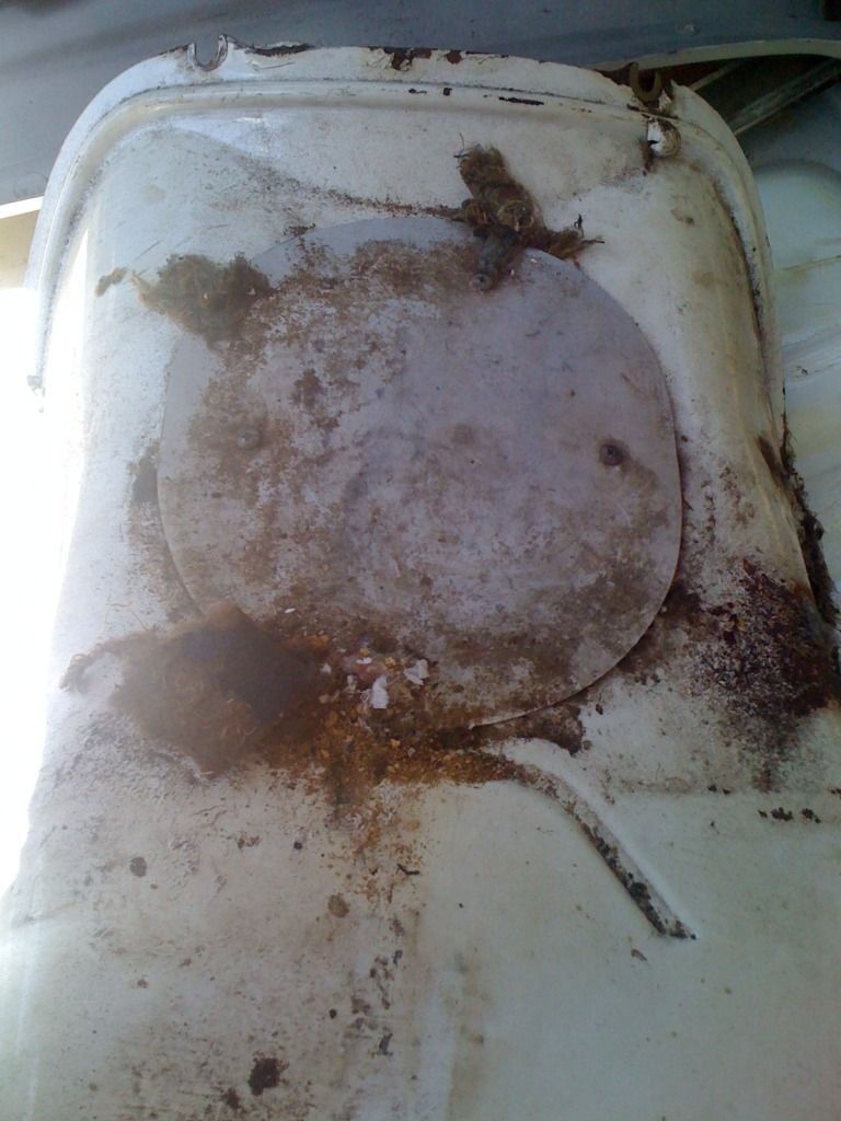

Kinda scary knowing this is right by where you sit.....

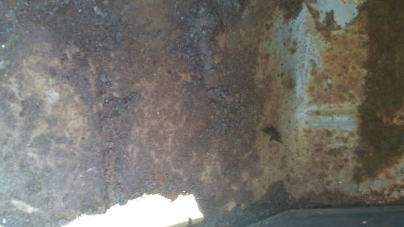

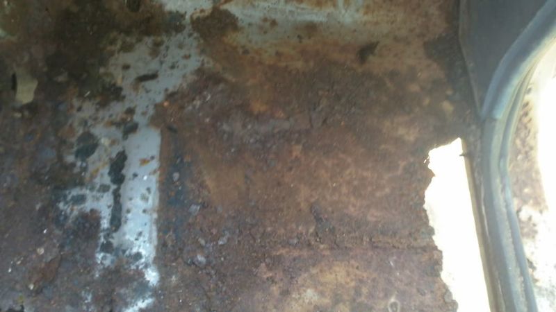

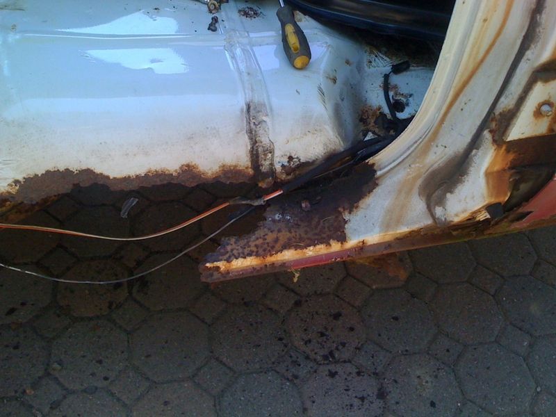

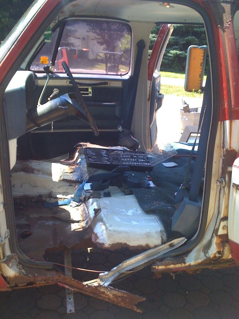

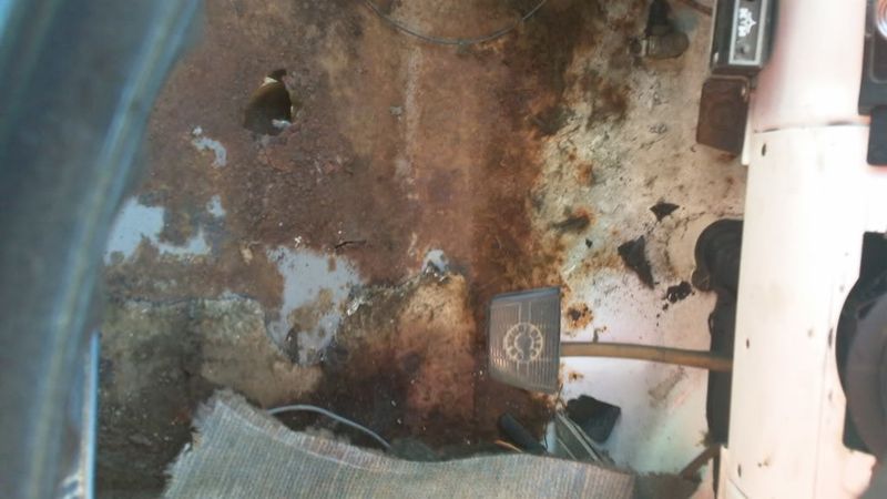

Holy rust problem
ehhhhhh a little paint will fix that right up :p
yea that might take some work!
