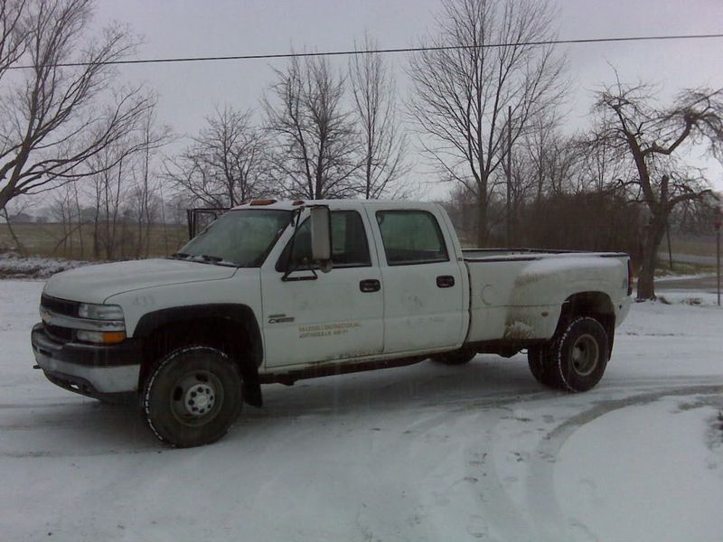

well I guess I can start this build thread now, its still going to be slow going but Im bored sitting in this hotel (work out of town 5 days a week).
Heres what Ive got so far:

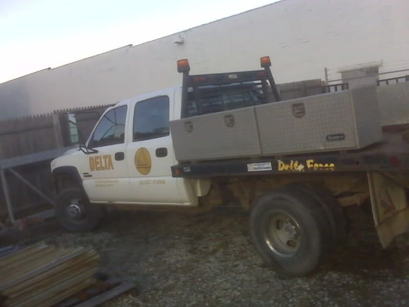

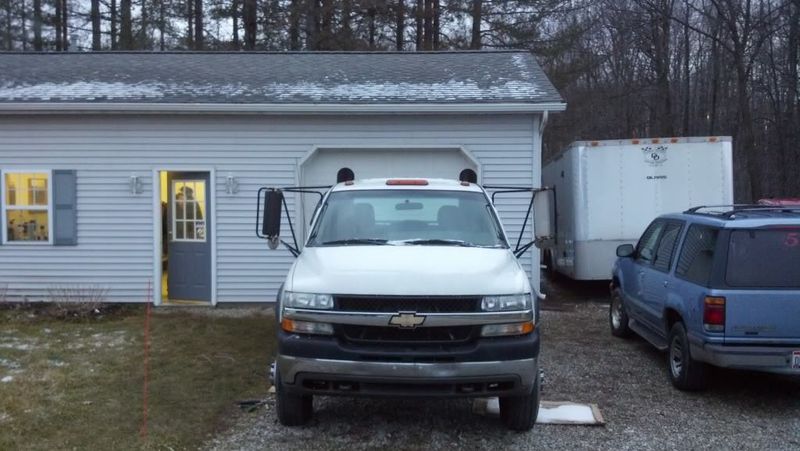

2002 Silverado CCD 2wd Duramax/Allison
(bought it real cheap, was a work truck for my employer)
Scrapped the flat bed that came on it, and replaced it with a dually bed I found locally.
Moved the fuel tank into a flush diamond plate toolbox in the bed...to make room for the 4-link...

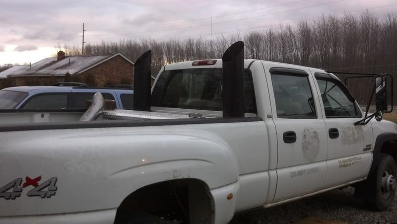

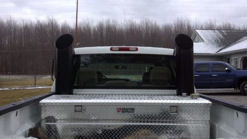

Got the exhaust installed...
MBRP 5" from the downpipe back to dual 8" Grand Rock miter cut stacks powder coated matte black
(I know that stacks arent everyones style but its what Ive always pictured for my dually)

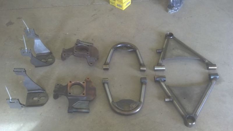

Originally bought DJM Upper and Lower arms, AVS front bag brackets and 2" McGaughy Drop spindles (FOR SALE BTW)
But after talking with a buddy of mine that has his dmax already bagged, I followed in his footsteps....
Called up Eric at The Little Shop of Horrors and ordered his front set up for the 2500/3500HD's...
Just ordered the Parallel 4 Link from SD this week so I wont see that for 3 weeks or so....
