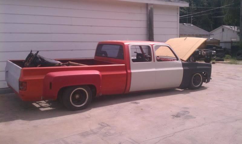

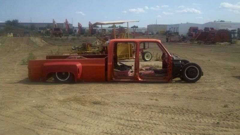

I am new here, From wichita ks. I picked this truck up about a yr ago for $500. I just got done building a 69 chevelle and now onto this. Truck has been body dropped and bagged already. Shaved firewall. I'm going through entire truck and re-doing what the previous owner had done to it. All the welds are bird shit and non structural. Front frame horns fell of with one small hit with hammer. I will be building an entire new rear section of frame starting from the back of cab. With be triangulated 4 link with a cantilever setup. As for a power plant im thinking of just a 454 or maybe diesel conversion. Interior will be 4 WWll bomber bucket seats. custom sheet metal dash and center console.
Just getting her into shop and starting the work will post pics as progress comes along.
Laying in the dirt

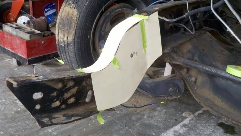

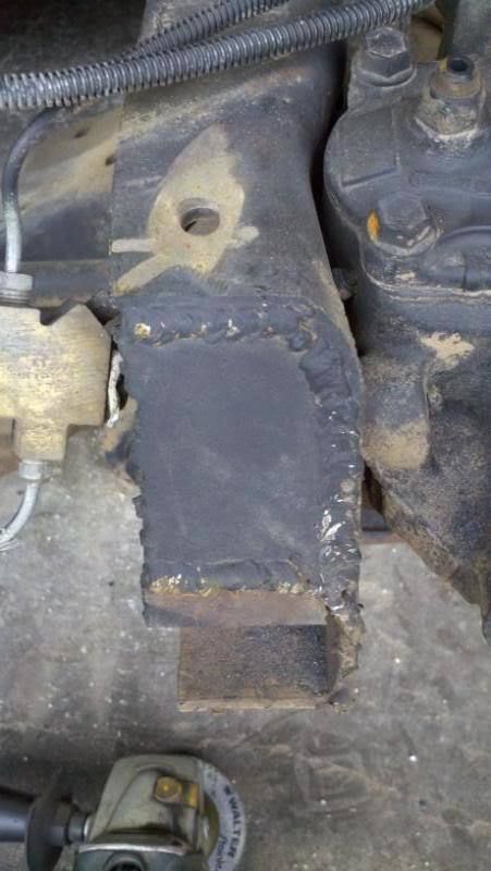

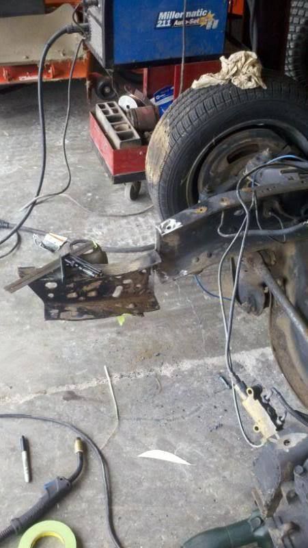

Where previous owner had welded front frame horns on. Zero penetration and 1 nock it came off. Bird shit welds everywhere.

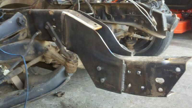

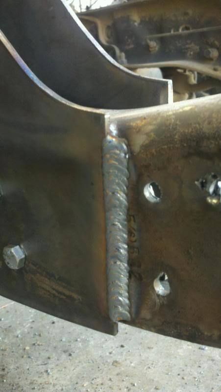

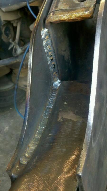

Cleaned up and tacked into place.
Will plate both sides with 3/16 steel rosette welds on outer side

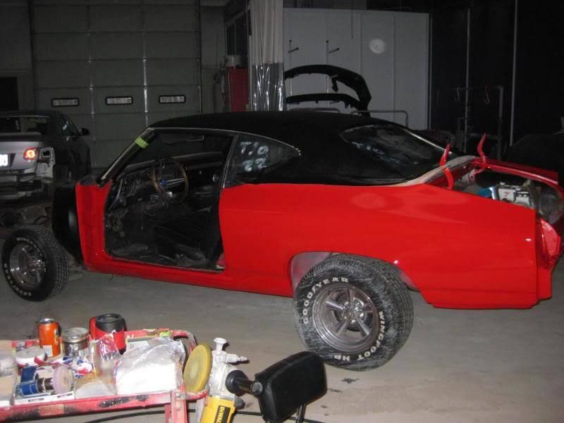

I am a painter and fabricator by trade Here is a pic of the chevelle I just got done painting. Might not belong in this thread but it shows the quality of work I do

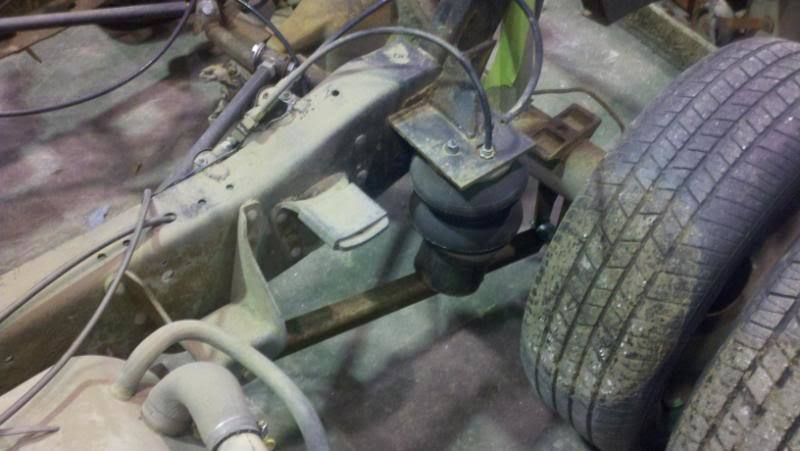

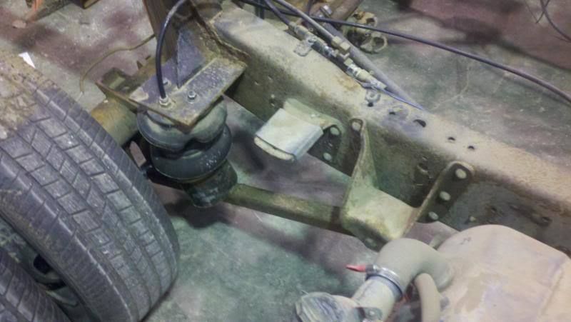

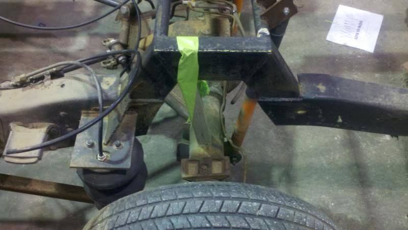

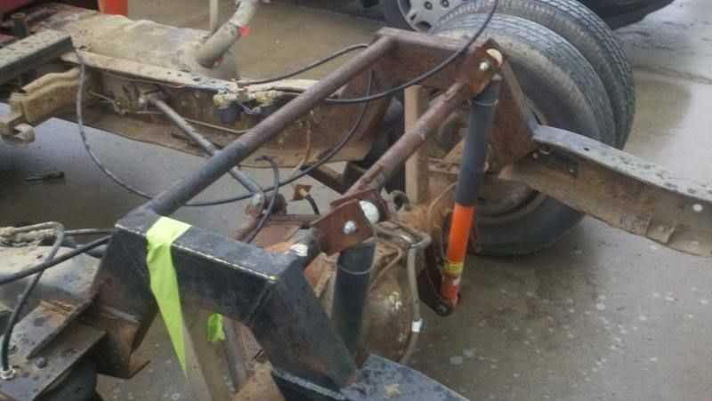

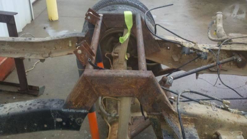

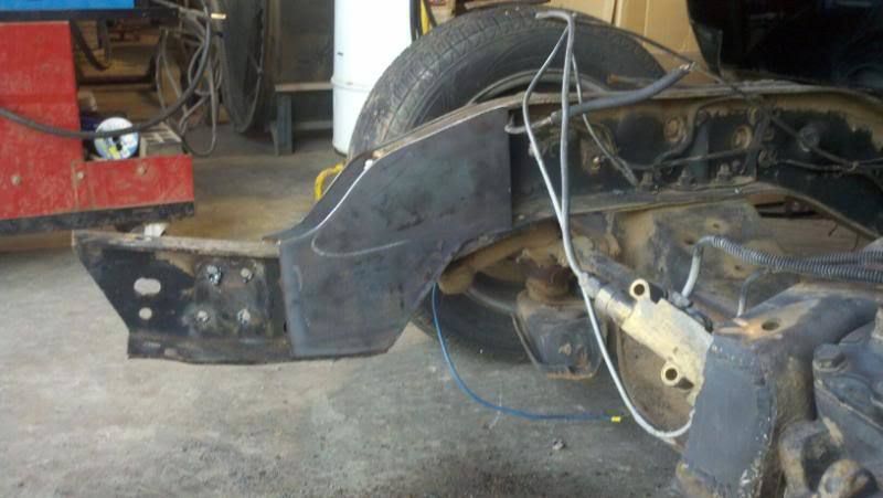

Here are a few more pics of what i'm dealing with. Just to give you an idea of the shit work that has been done.
Track bars/Trailing arms aren't long enough for my liking

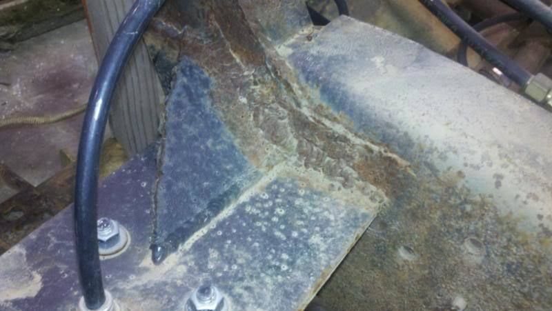

More bird shit welds and ugly gussets
As you can see here inner frame rails have been left unboxed. No structure or strength.
