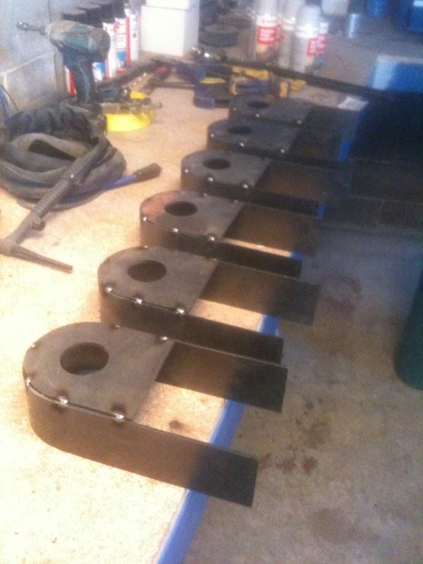

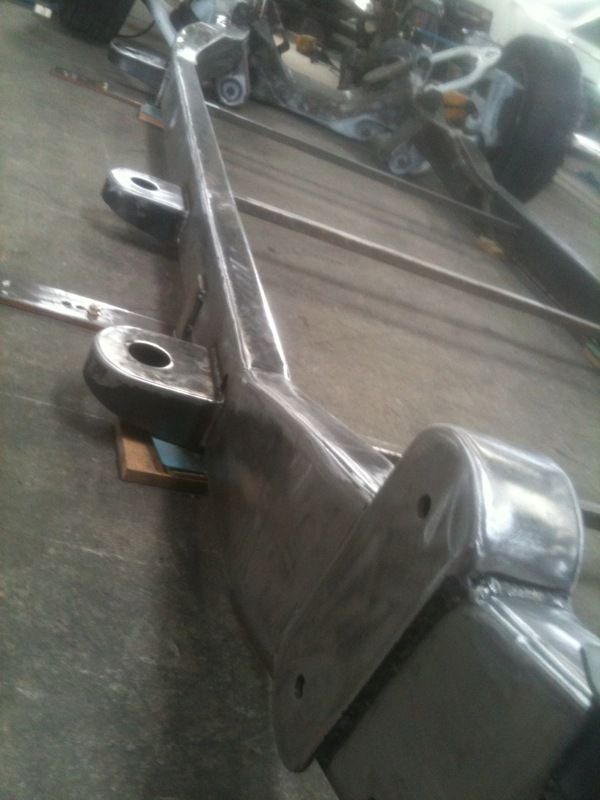

Hey guys I'm from a small part in Australia I run a customs shop. Here's my 88 c3500 build I've had it about a year and a half bought it LHD imported in 2006. Here's my build so far.
When I got it

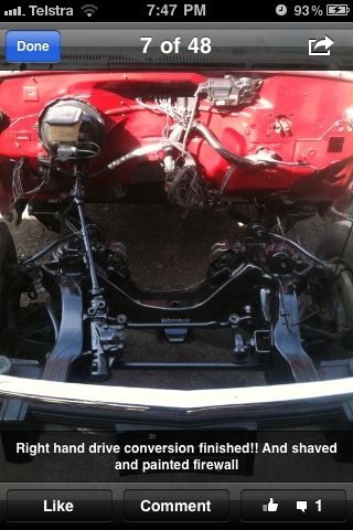

RHD conversion

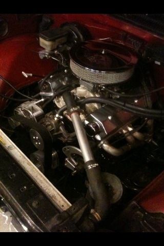

Pissed off the shit TBI put a 600 Holley, edelbrock manifold, billet brackets and gilmer drive, extractors etc etc on the 350

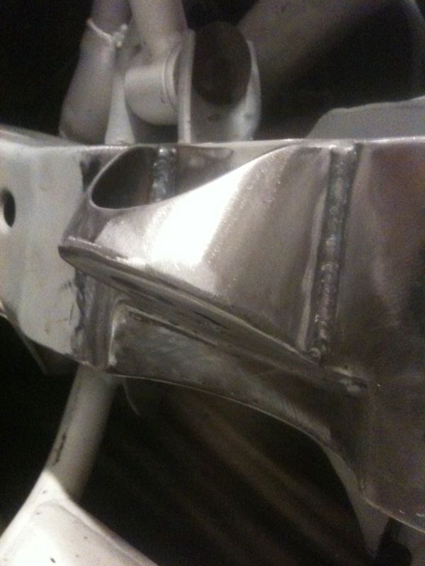

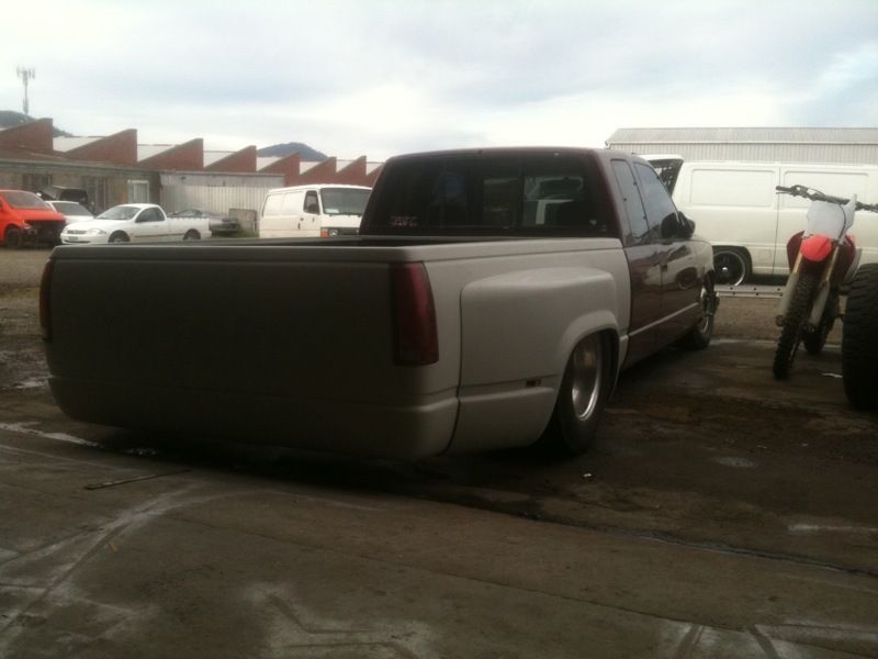

I said to my self when I got it yeh I'll just lower it a bit and drive it daily, pffft that whent out the window, notched it
Then 4 link
Shaved the rear gate and rollpan on

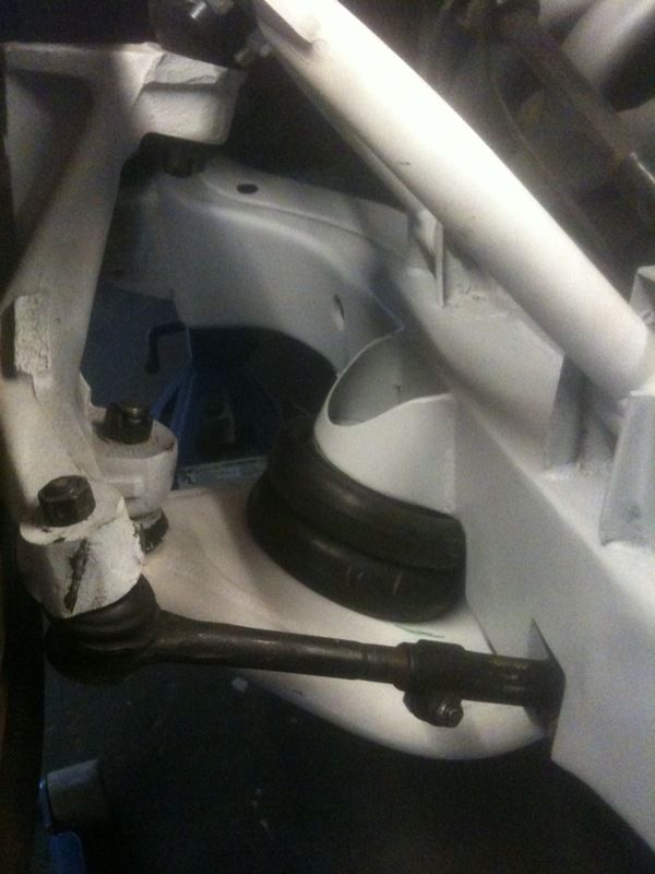

Bagged the front and stole the tubular arms off my c1500

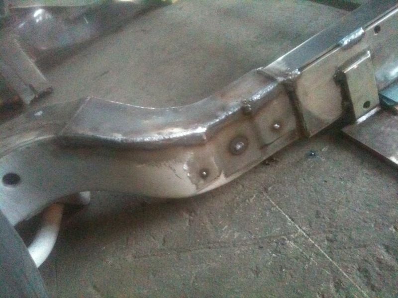

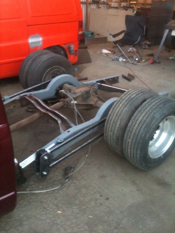

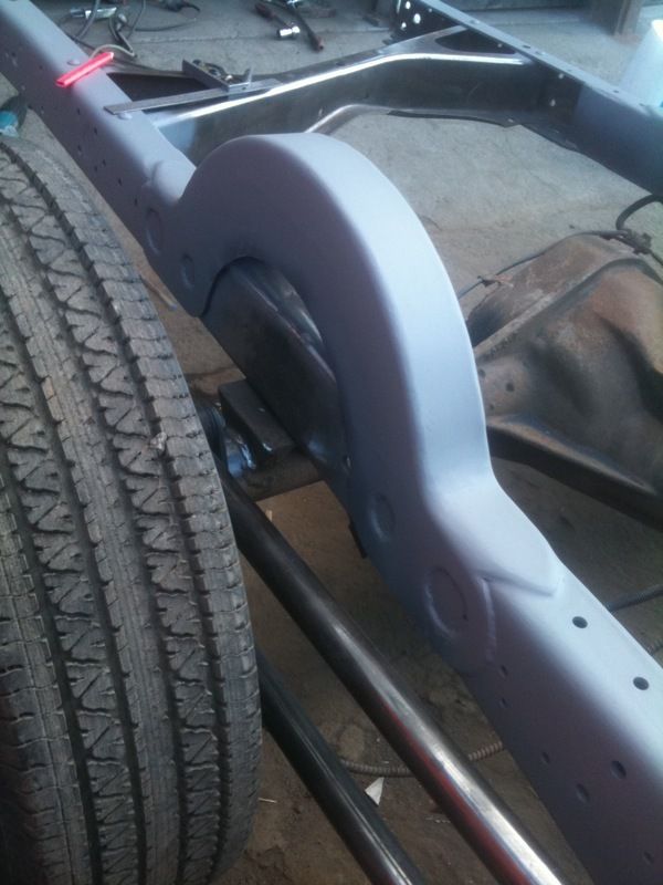

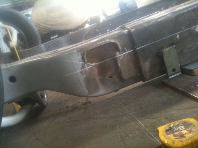

Got it sitting on the ground then the gap between the cab and the concrete annoyed me so off comes the cab and 3 1/2" body drop, trimmed the chassis and fully boxed it in with new body mounts
This is where I'm up to now chassis cleaned up with 4 link and body mounts done, ready to mount the new motor and box (ls1 carby fed and turbo400)
Still need to bag rear, drop spindles in front and 24" town nastys and heaps of other stuff. All feedback appreciated cheers fellas

Really nice, clean work you're doing there sir. What's up with your front bag mount? You start with a 4x4 truck?
You wouldn't want to box up some rhd stuff and send this way would ya?
mrmfab
Hey bud cheers, na I just got rid of the spring cup as I couldn't stand the look of it ha.
RHD stuff is hard to get over here I can't even find another steering box and I used the dash out of my c1500.

Cheers back at cha. That little trick right there is clean as Hell.

There's usually a few write offs on aus eBay man check there, the dash and steering box are the hardest to get, brand new RHD boxes are $350 any rightys rolling around over there?
