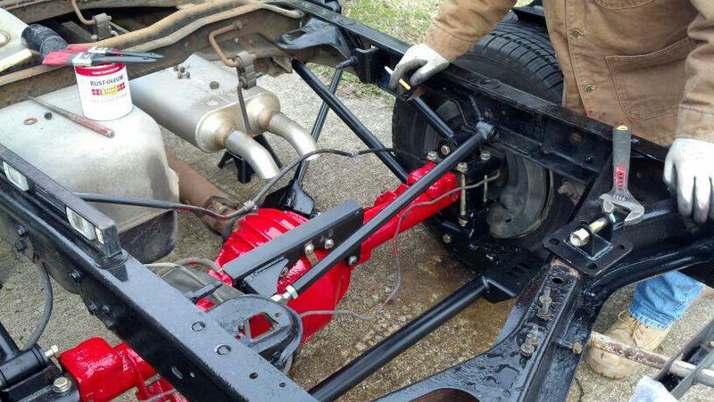

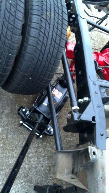

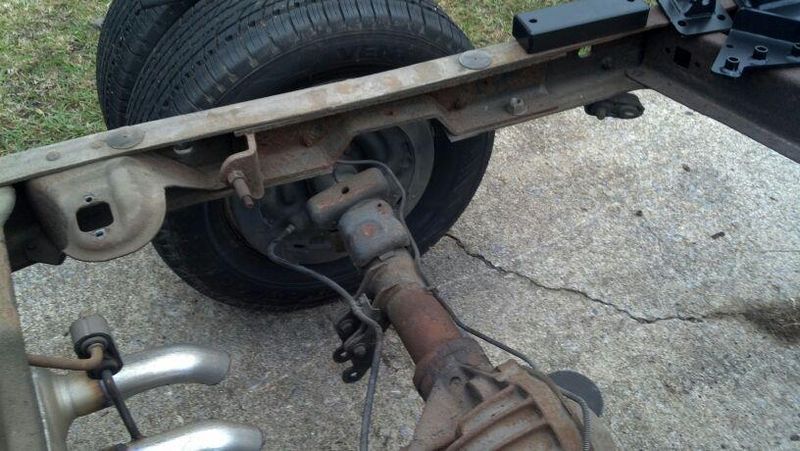

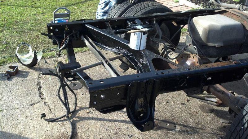

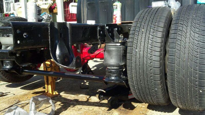

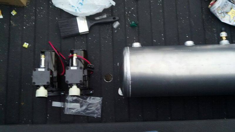

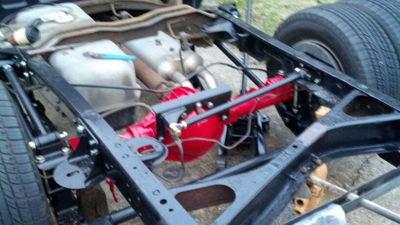

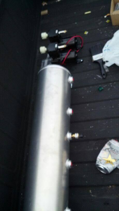

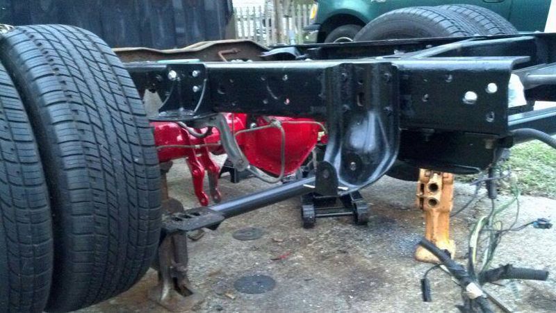

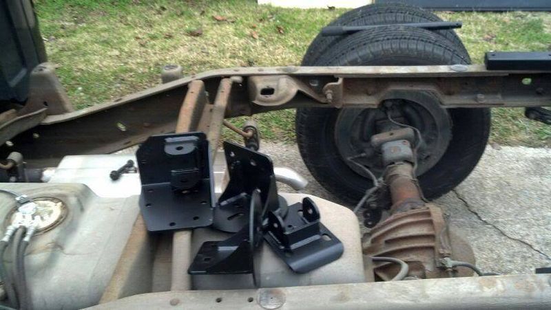

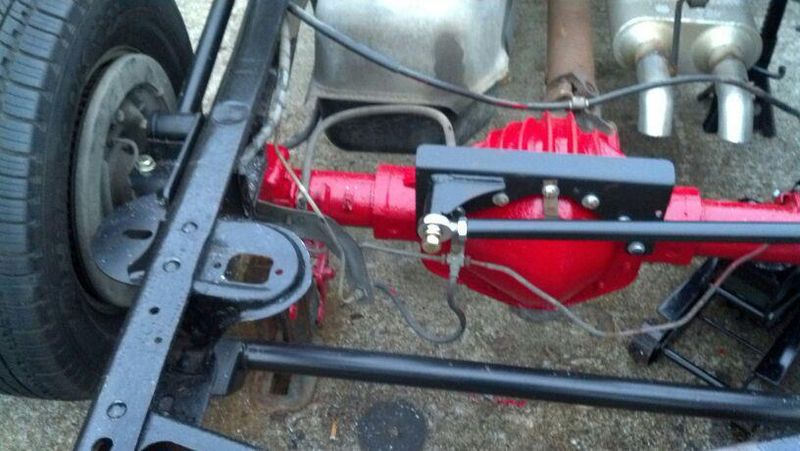

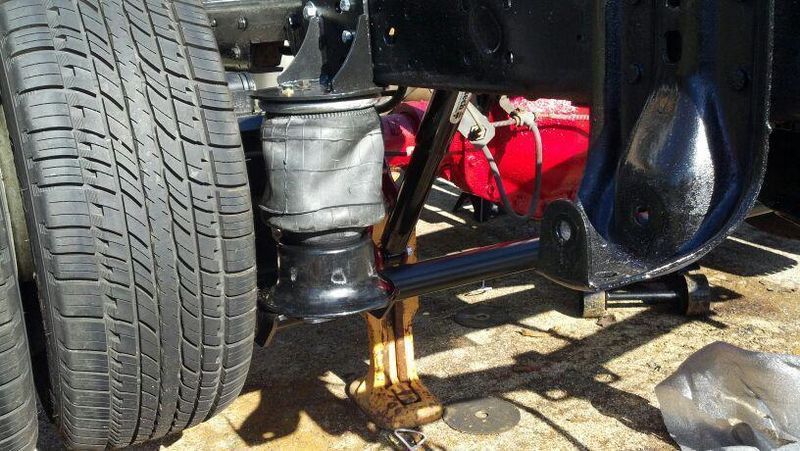

What kind of bags are you using? Where are the rear bags connected to? off the rear of the axle?
mattk86
it's the firestone 2600's that ridetech uses, and yes the mount comes off the axle.
mattk86
I figured out during my installation that I definitely need a bigger notch out back and up front I need to build some tubs for the wheel well

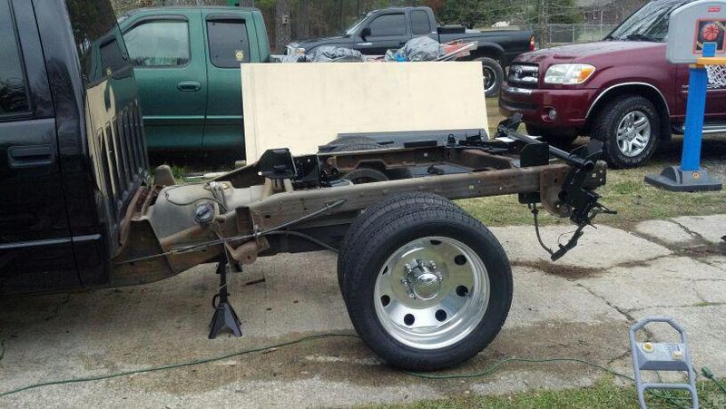

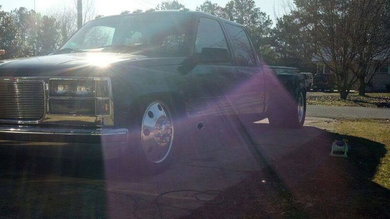

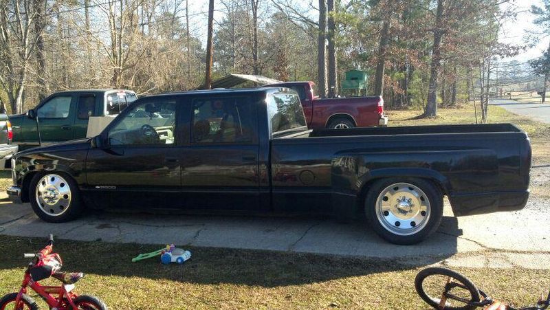

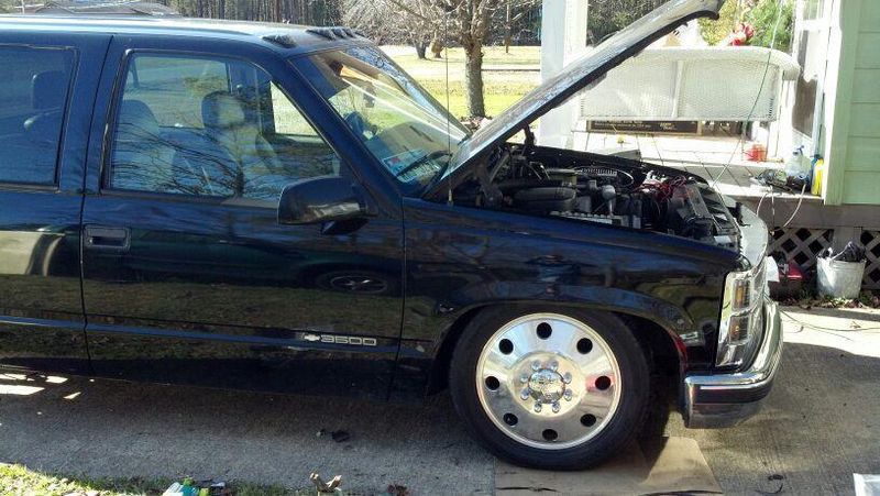

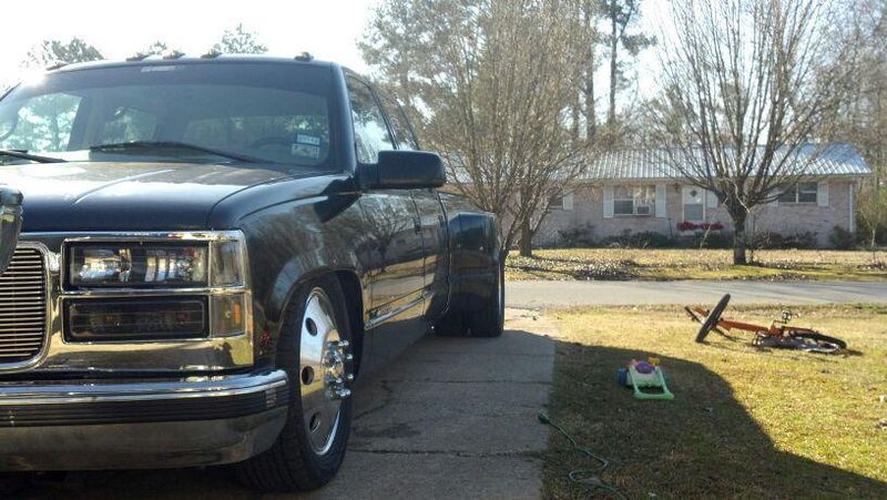

I like the rake.
U want a bigger notch to lay out or to go a few inches lower?
Post was last edited on Jan 06, 2012 08:14. Edited 1 time.
mattk86
just to go about 2 inches lower, I didn't even notice the rake until I laid it out the first time. I don't really wanna go any lower than 2 inches, don't want to start changing fenders and all that good stuff lol

Looks good! What size are those tires? I like the rake too
