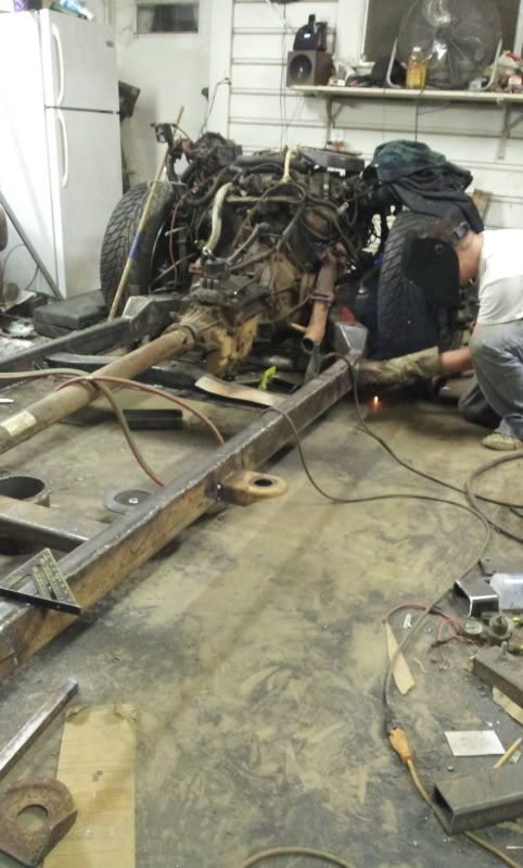

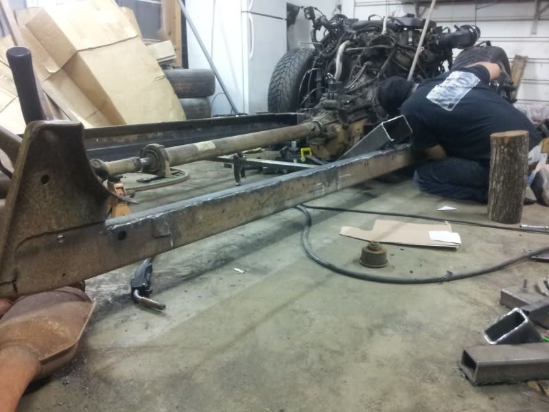

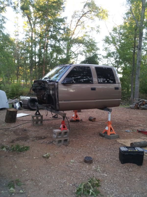

well guys and girls i havnt posted in a long time, but i am in the middle of doing my stockfloor bodydrop right now figured id give everybody a heads up on my progress, and while its stripped down to the frame like this i am thinking of doing my 12 valve cummins swap also..also going to redo my rear bag setup leaving it a 2link but re doing the bag mounts and putting a gooseneck on it..

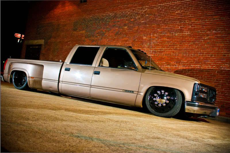

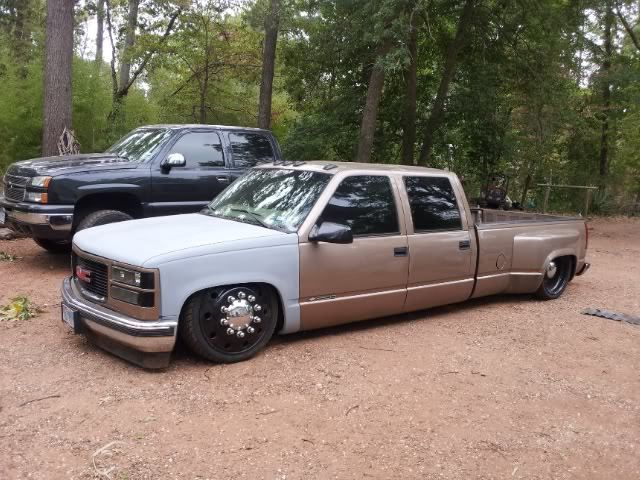

here's how it used to look right before i tore it down..

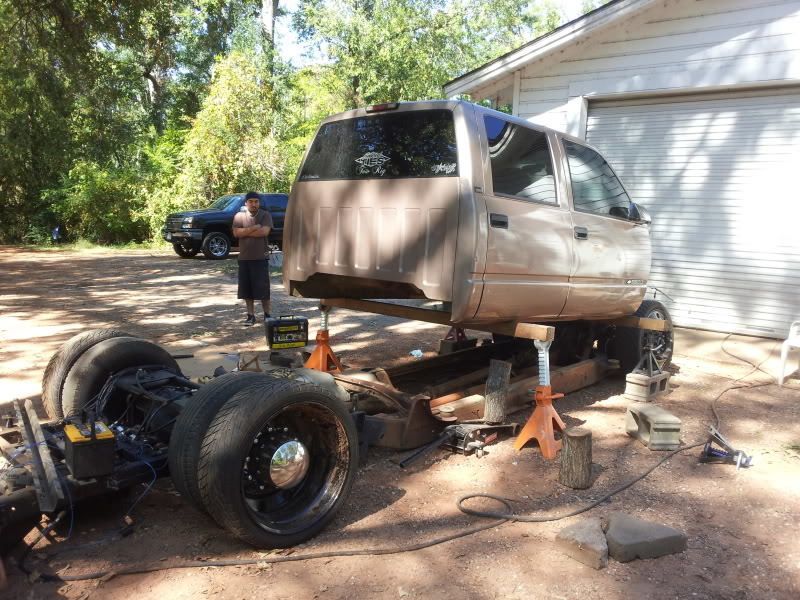

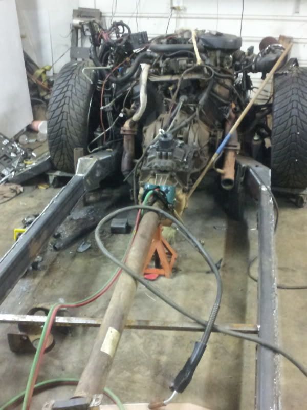

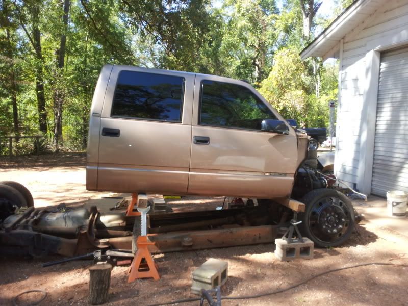

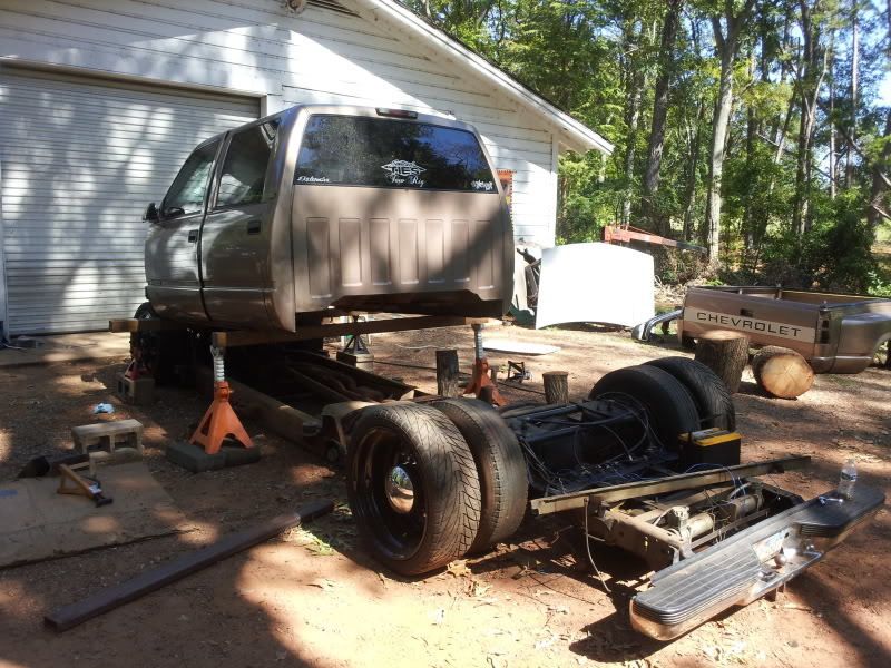

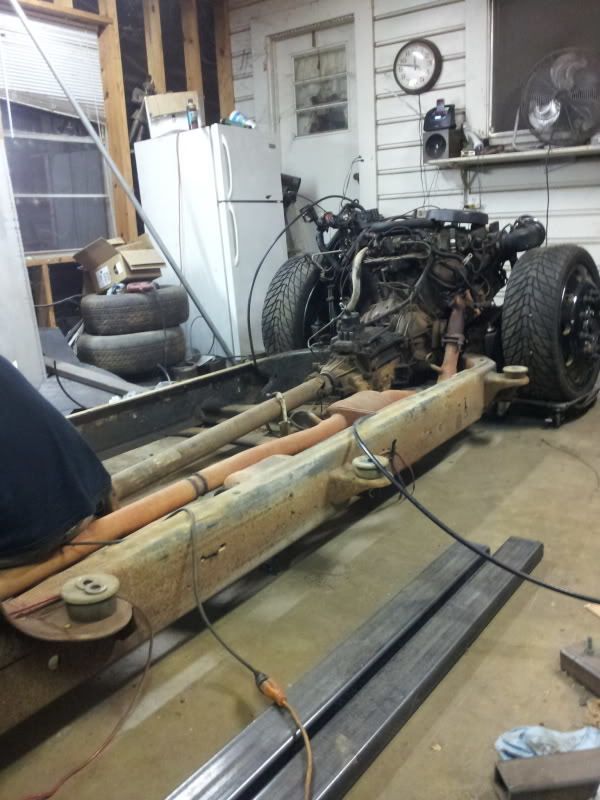

and the progress pictures as we was tearing it down to the latest updates on the frame.

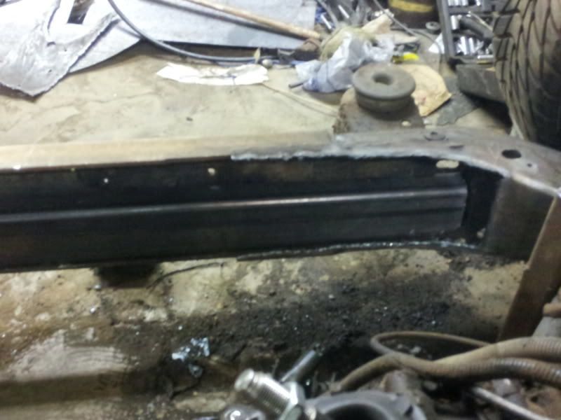

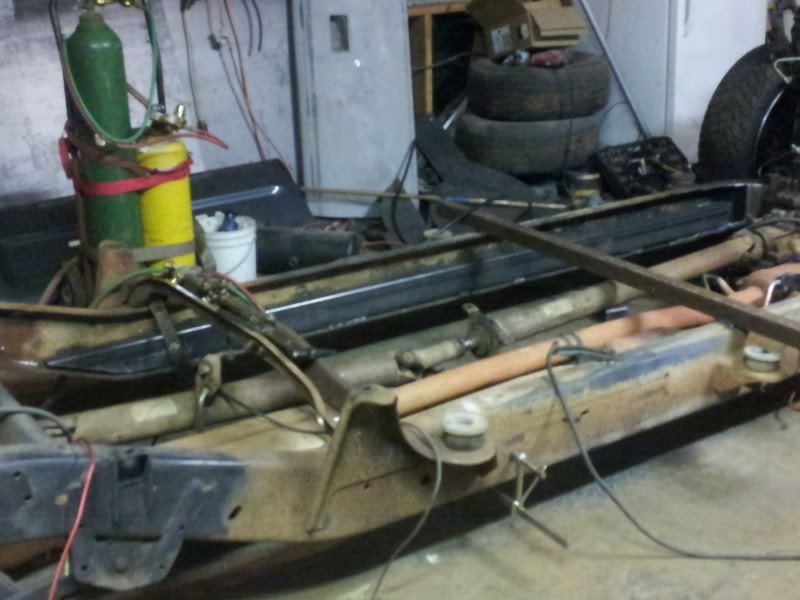

after getting the Frame in the garage

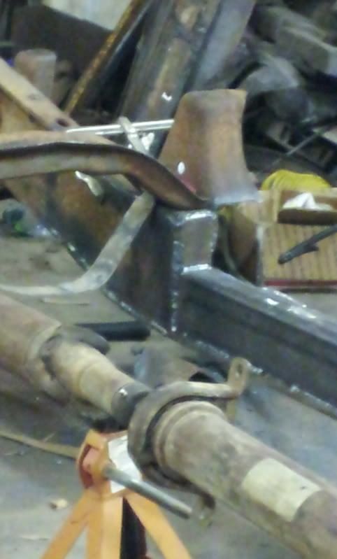

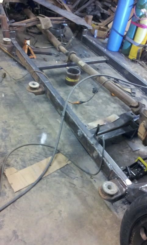

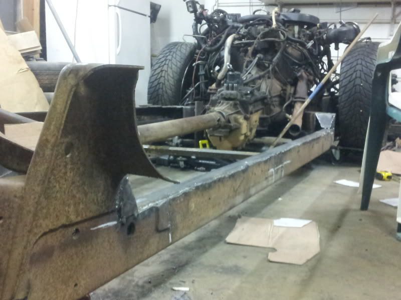

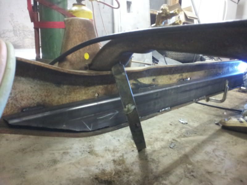

getting the frame rails set in and welded up
both rails are welded in and Cut down..

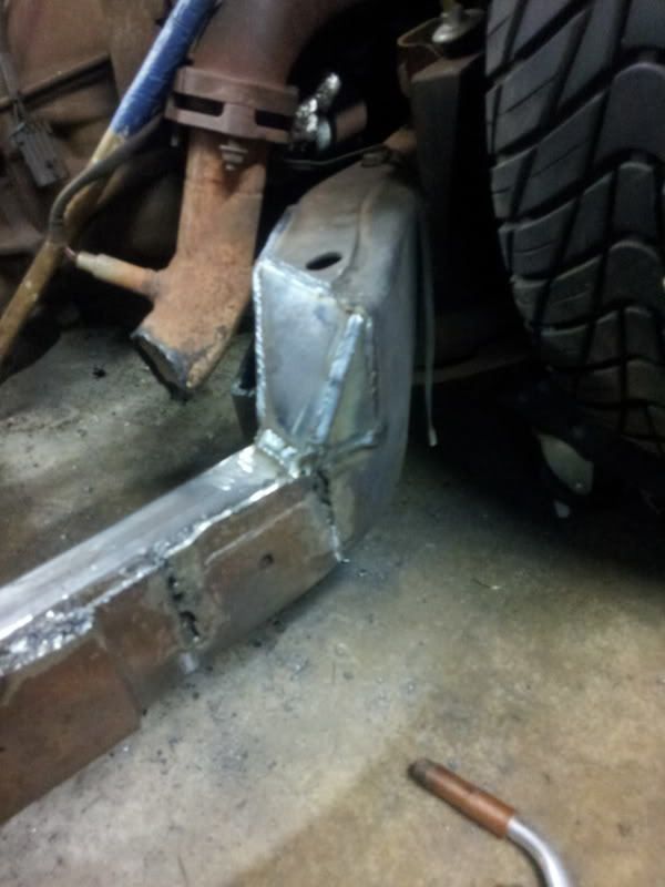

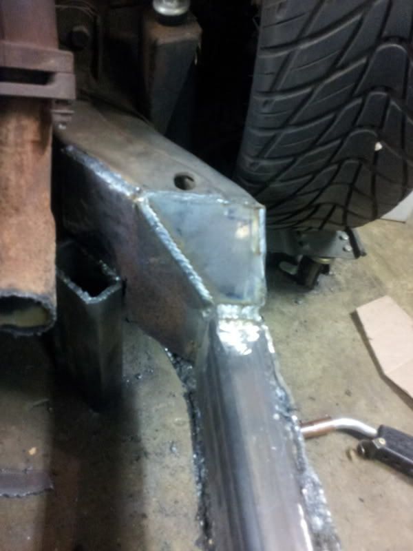

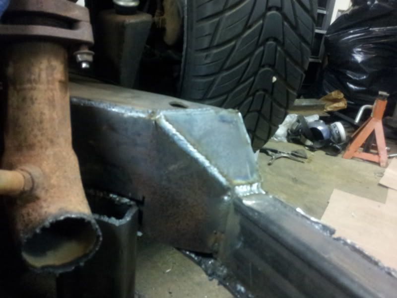

front frame rails boxed and welded in

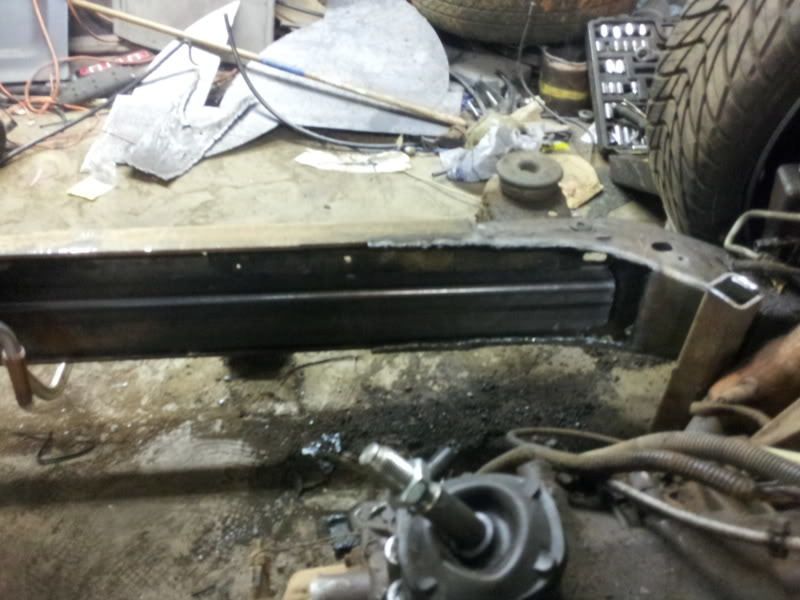

rear of the frame boxed in and welded up

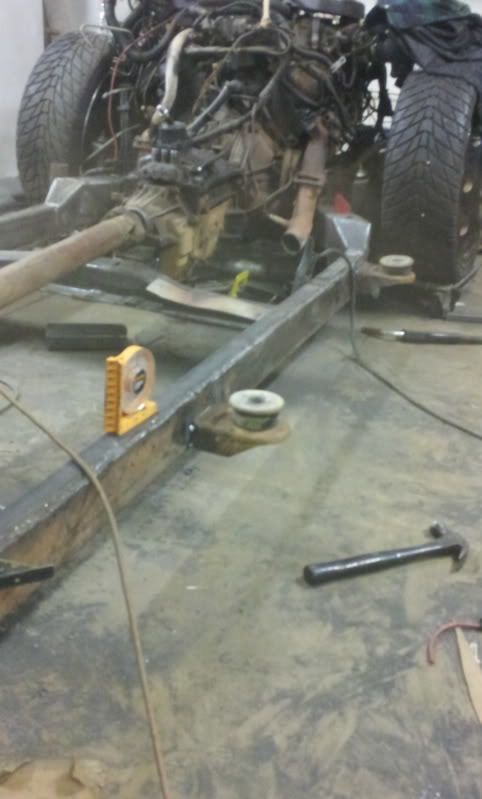

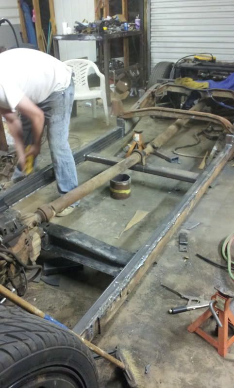

got the tranny cross member and carrier barren cross member in this weekend
started tacking on cab mounts
and thats where the frame is sitting at now, ill try to keep yall up to date on it, i dont plan on putting the body back on it until about the first of the year, to have time to do the 12valve swap and clean the frame up get all the old dirt and grim off of it..
