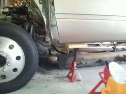

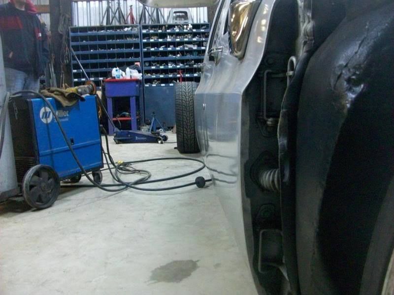

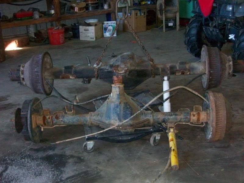

get a SRW rear axle....they shorten them so you dont have to widen fenders but theres no way around it your gonna have to section and raise them...i used a SRW axle out of a 97 chevy 2500 on my 85 dually and it worked great....out trucks are diff bodystyles but same principles for both

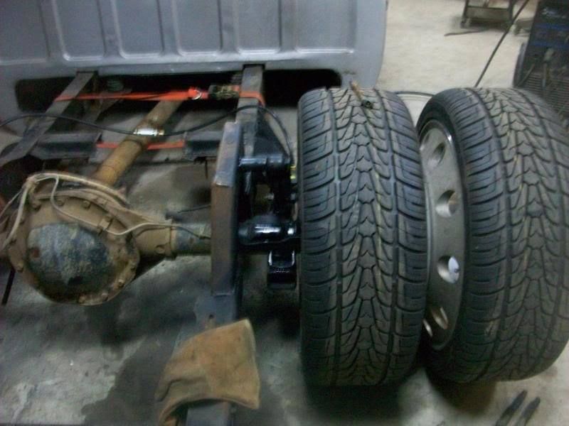

heres my stock rear and SRW
frame to wheel clearance...notice i had plenty of room to mount 2 link and shocks

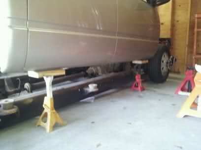

side view
tjiv80
thanks comegetsome.. did you have the srw shortened or did you run it as is. the pics help a lot. a lady backed into my rear wheels a few months ago bent my rear suspension (leaf springs and shackles) so its undetermined yet that the inner axle shaft isnt bent too. run that srw rear end and solve the problem.
