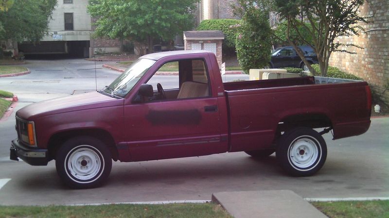

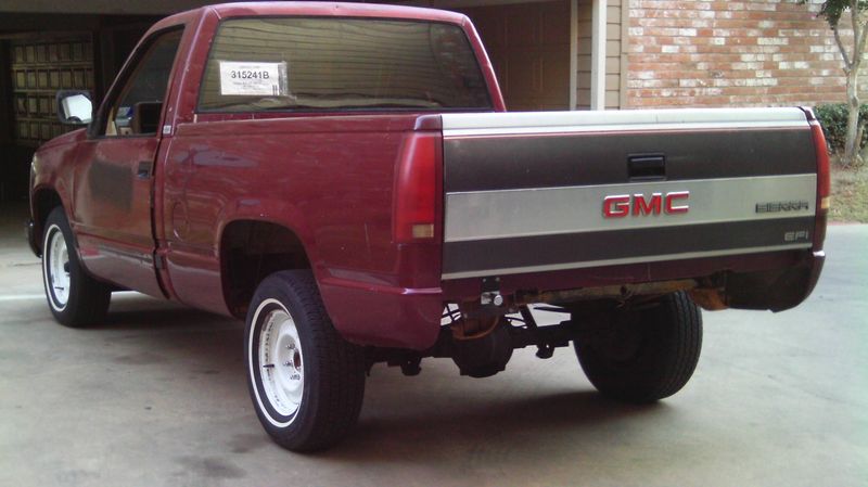

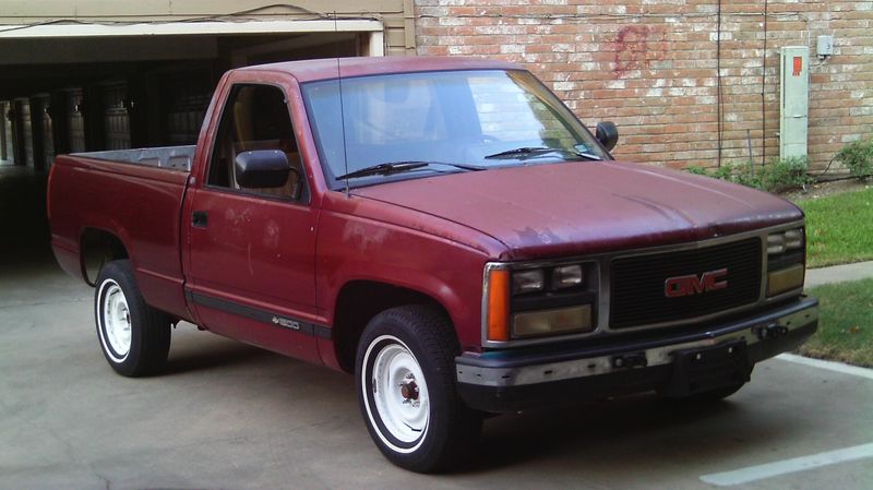

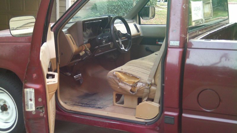

I got another 1988 Chevy swb truck.. Needs lots of love.. Has a refreshed 305. Maybe some gears? Good cheap Project truck.
By dually502 at 2011-08-19

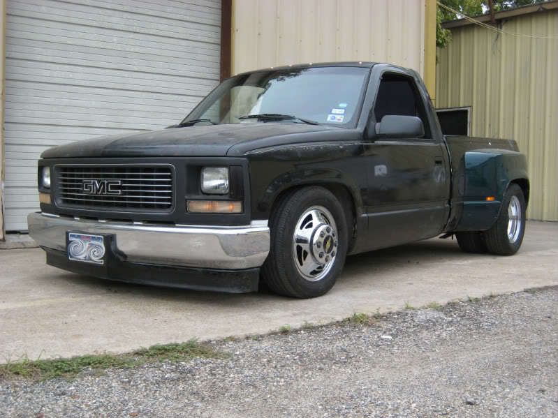

I built this truck a while back and really wish i still had it.. I will just build another one.
build thread:
" target="_blank" target="_blank
A quick summary of build thread:]
