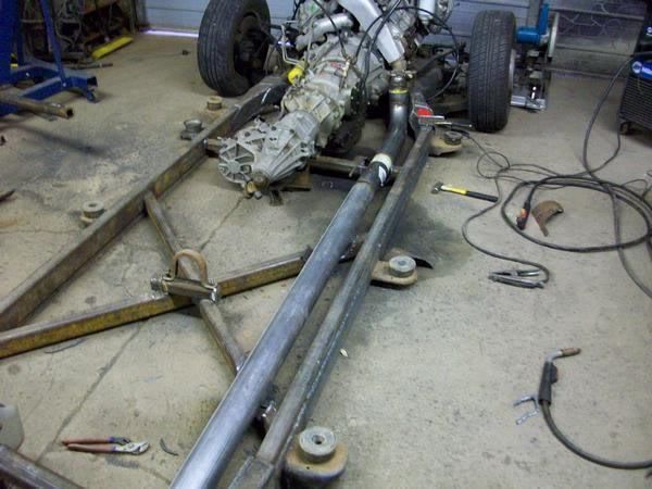

i took this build on as just a simple sfbd on 19's and new 4 link. well my big mouth opened said this would be cool and this would be bad ass and so on. now we have a 1st of its kind (that i know of) 1993 dually build. lets see, we started with a bagged 93 dually, frame rails are 2x4x.250, xmember is 2x3x.250 and trany member is 2x2x.250. link bars are 1.5x.250 dom, devious narrowed arms and 6 22's with 265/35/22 tires. everything on this truck is .250 plate and tubing. just because of the monster that was going under the hood. 03 lb7 dmax with allison tranny. updated the front end with a 04 gmc clip, custom 01 hd cowl hood. inside we put a 04 dash and steering comlum as well as dual climate control. yes it still fully functions. not on to some pictures.

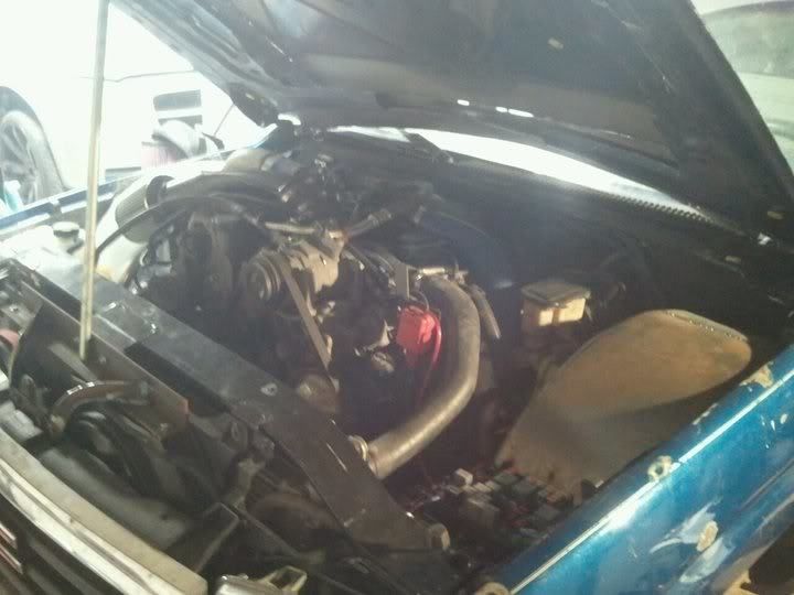

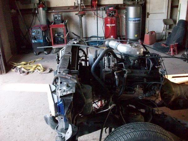

pretty much how it started with a stock tired 350 with over 200k on the clock.

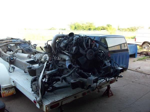

heres the doner. 2003 lb7 dmax. couldnt find a 2wd tranny so the owner decided to just keep the transfer case on it.

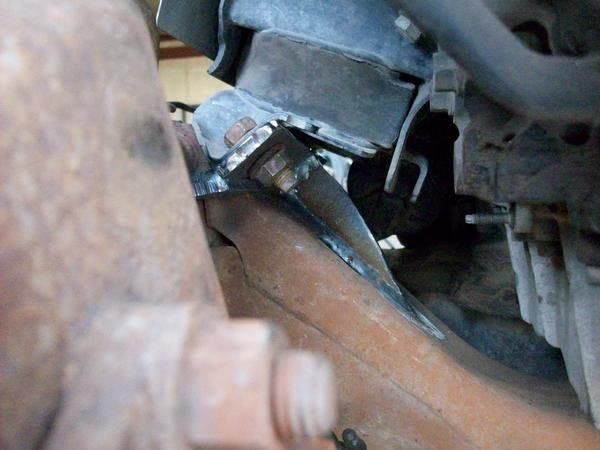

pretty much sat right in and fabed up some simple mounts.
nice 4" straight exhaust. test fitting everything before paint and bed liner

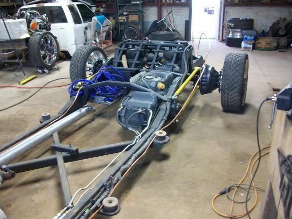

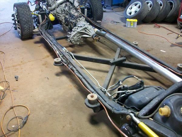

stock 03 shortbed tank installed.
sick82

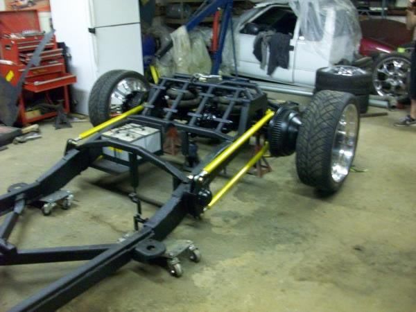

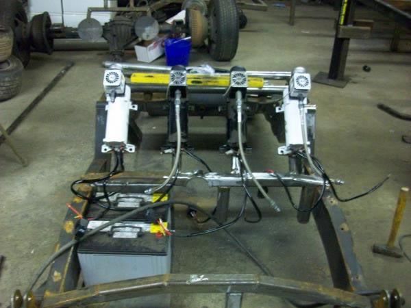

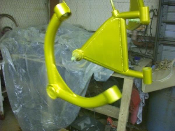

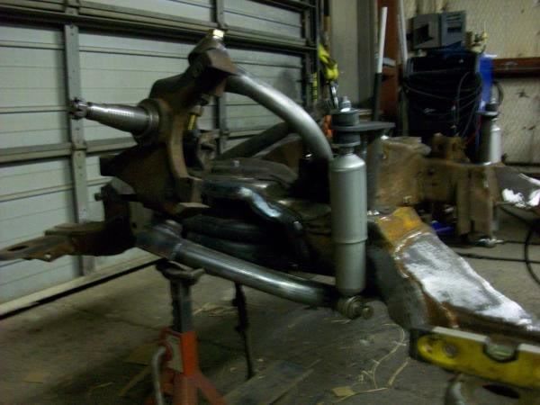

narrowed devious arms and monroe shocks. full droop.

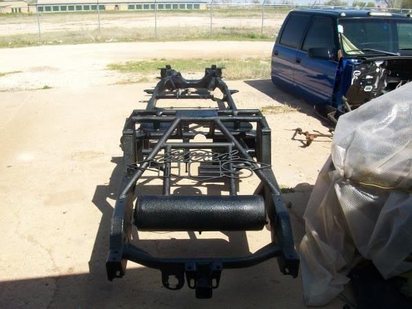

painting all the parts, hok sunburst gold

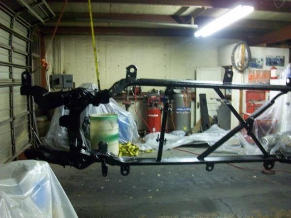

whole frame sprayed in speedliner.
putting it all back together

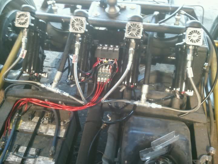

got a nice sponsership from az so i set up a nice display.

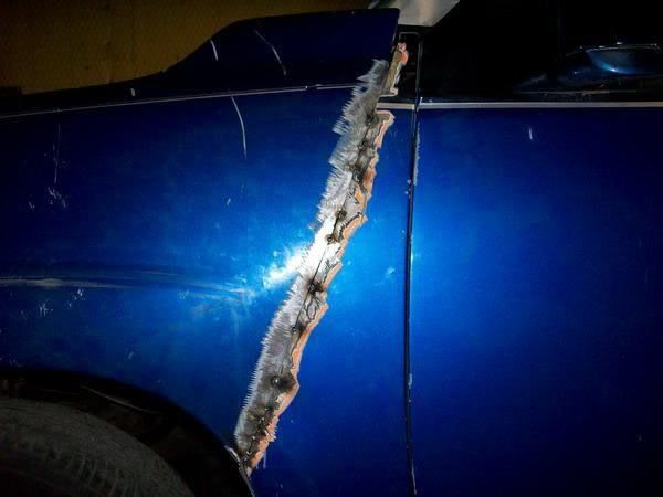

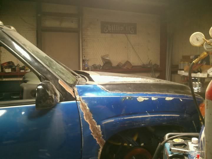

where we joined the new to the old. the upper bodyline will be shaved on the truck.

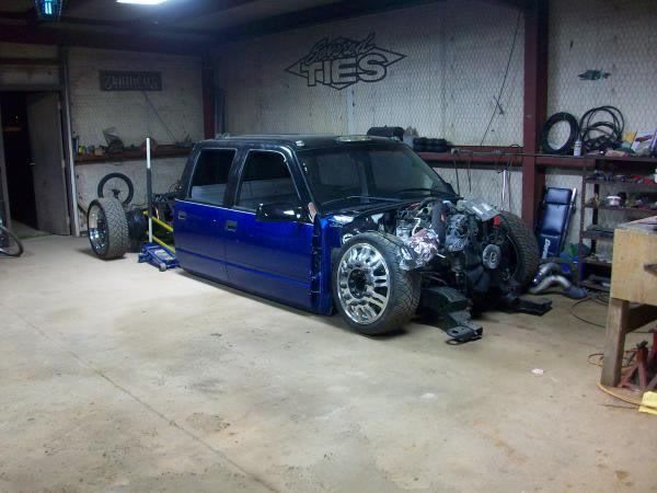

got it this far then it had to sit for a bit waiting on more money.

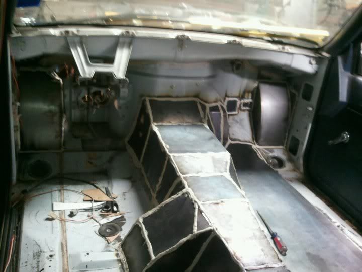

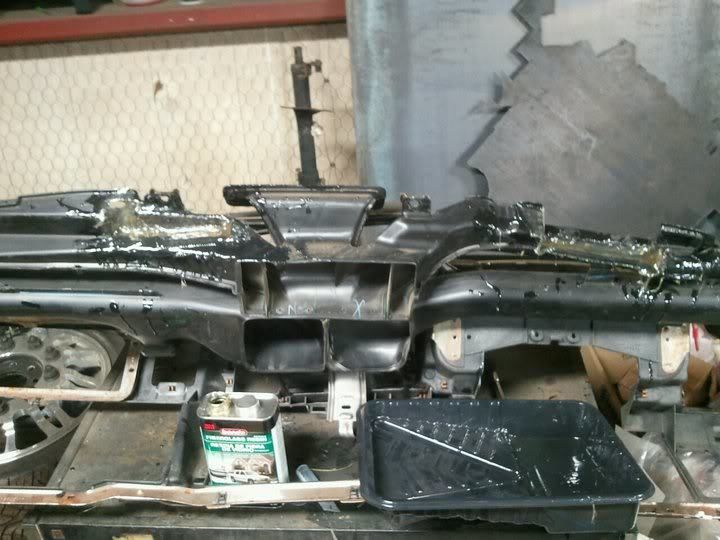

floor all covered up and seam sealed.

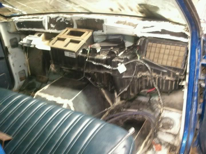

test fiting the modded dual climate blower box and getting it all mounted up.
yup, still has ac!

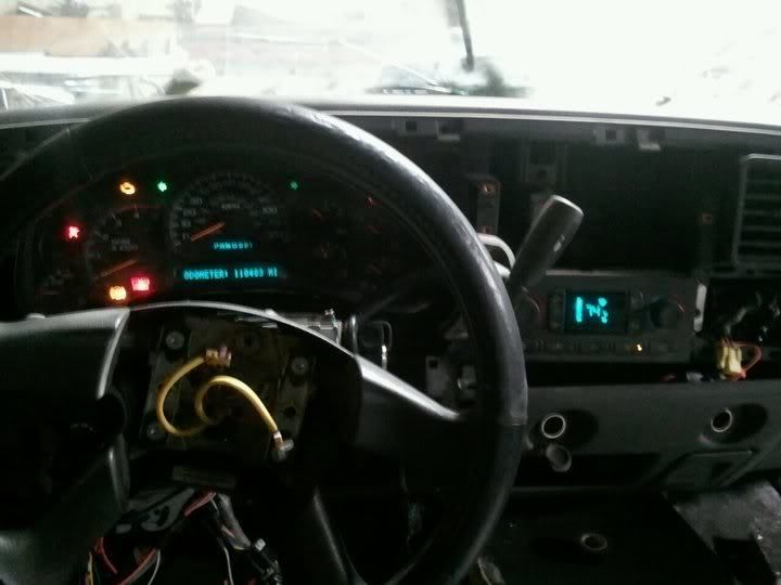

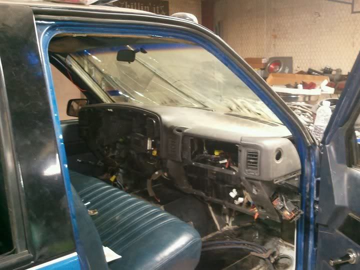

04 gm dash in!

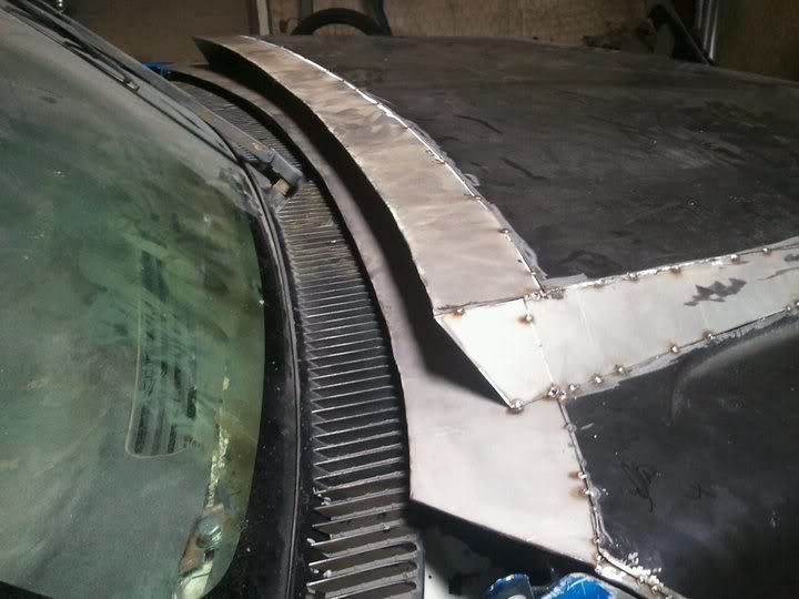

new 01 hd hood then turned into a cowl to fit over the intake and intake elbow on the dmax.
had to add metal to the back to cover to the cowl.

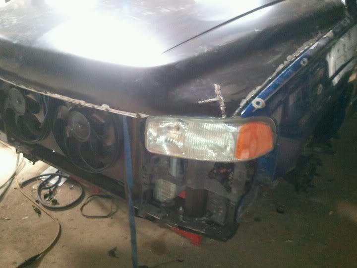

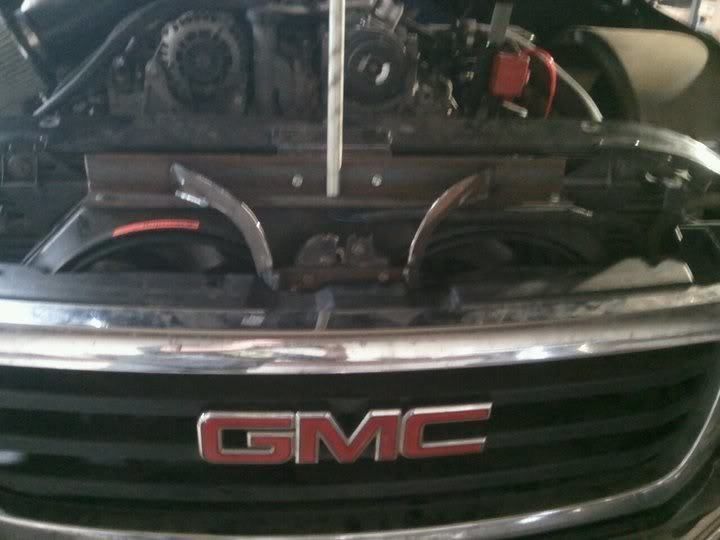

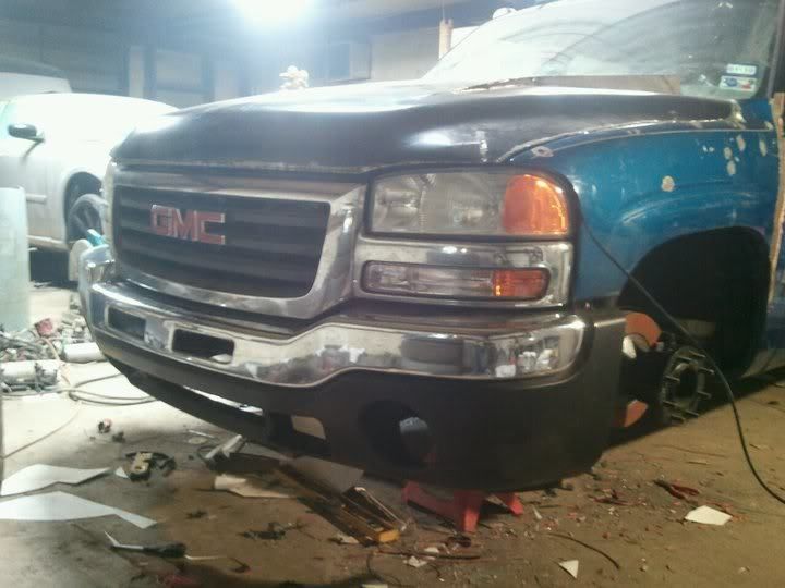

got it to fit around the headlights nice a purty

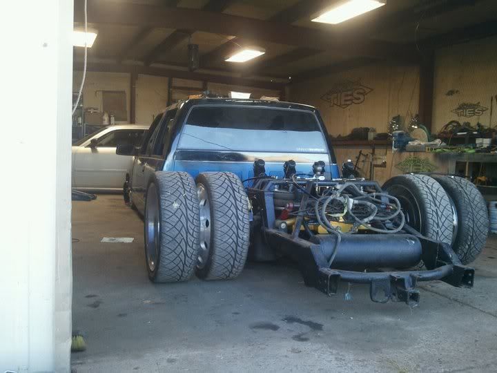

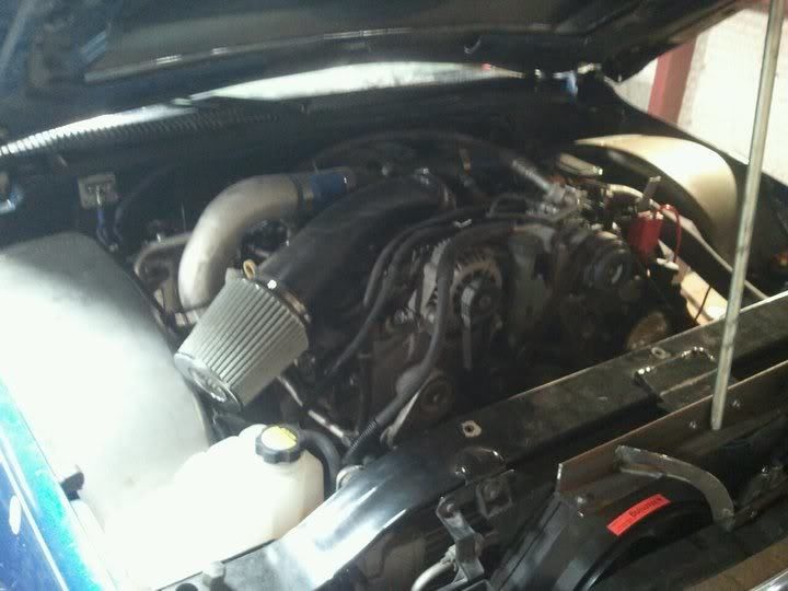

went ahead and got everything under the hood wired and plumbed in. 500 bux in all new fluids later

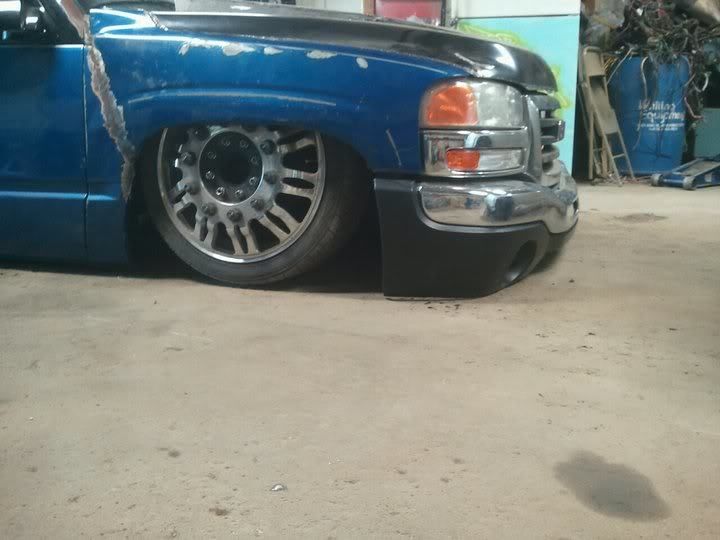

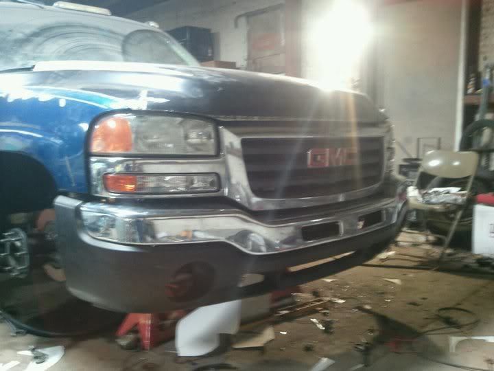

then finished putting the front end together.

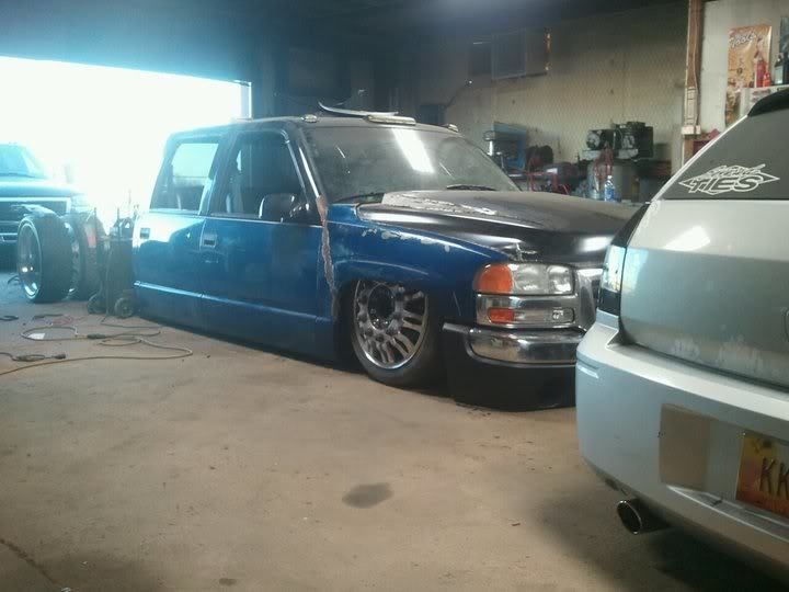

well hope everyone likes it. it has 3 electric fans on it from flexalite. just about to hit the body shop, i just roughed body in. they will finish it all completly.
