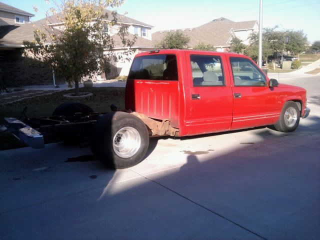

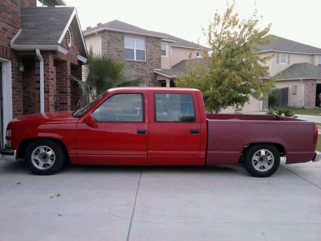

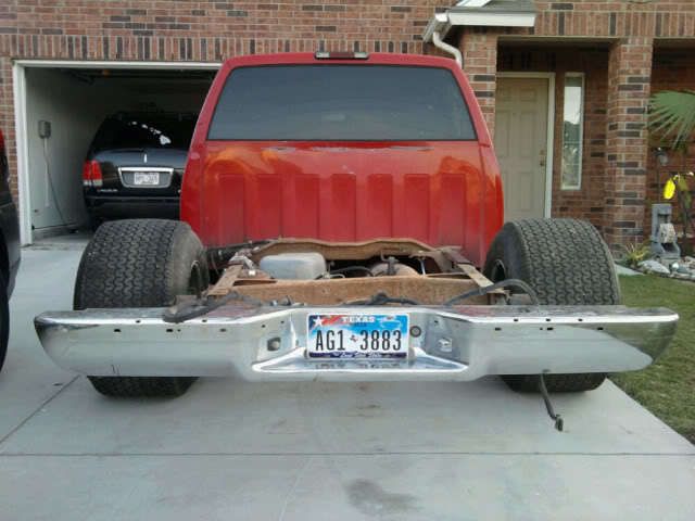

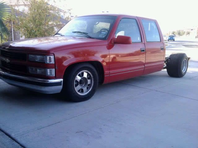

K this is my phantom dually project. I began working on um a couple weeks ago.
I going take this 96 crew cab....
And make it into one phantom dually crew cab short bed!!

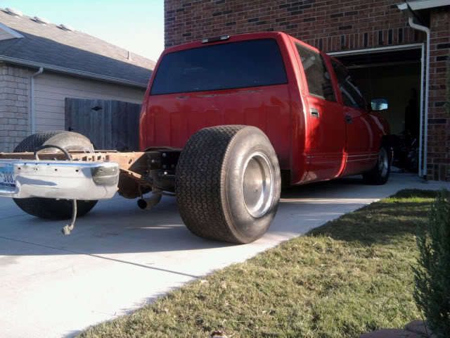

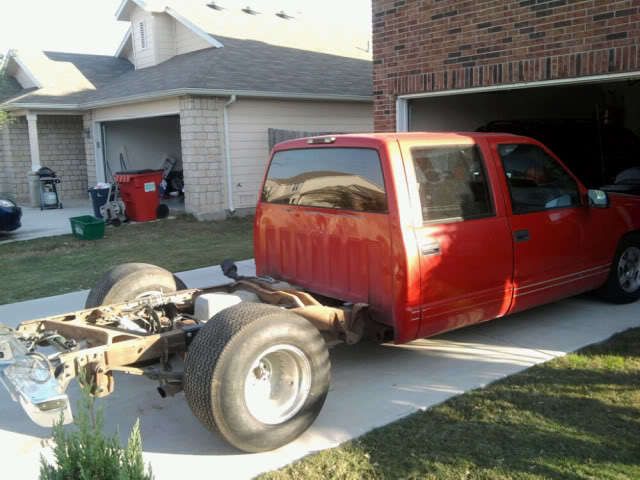

Heres the progress so far.

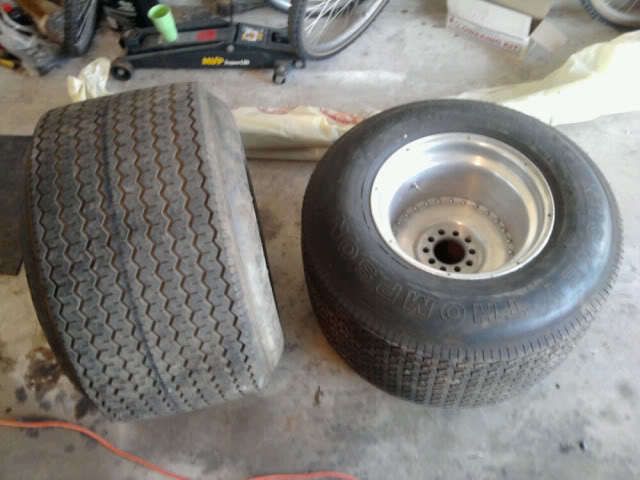

I get these tires and rims here...
I ordered a pair of wheel spacers a couple weeks ago and after going through some measurement issues with having the right bolt pattern I needed sent to me and having to send them back I finally was able to get the right ones and put on the spacers, center line rims and M/T tires.

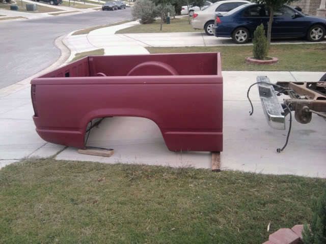

Heres the pic with the bed off the truck. I sold the bed in hopes of getting a 99 chevy dually short bed. The person when flake on me so I ended up having for buy another plain bed. But now since I picked up another bed I'm putting plan "B" into works. I'm gonna get some older 70's chevy step side fenders, mark them up on my truck and custom fit my trucks body style and weld them on. walla!! customs dually bed!!!

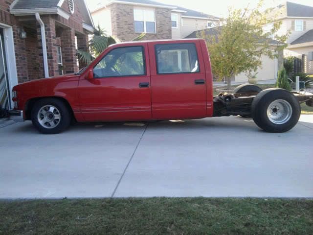

Stretched half ton frame (probably extended cab?) to fit that crew body, right? I think I see the reinforcements up there behind the cab. Or did it start life as a crew conversion by Centurion? Pretty cool either way.
You probably figured this out already but when you mount dually fenders the driver's side one will cover about 3/4" to 1" of your gas filler door. That's why those Arrowcraft dually conversion fenders have that little cutout in the driver's side. If you want to use OEM fenders you'll have to move the gas door a little bit, or cut it a little bit. My buddy Tim chose to cut his, which requires a little tack top and bottom to keep the face from falling off the hinge. Might work better if you just move it forward a little.
You might need to cut the bedside out for tire clearance, depending on your tire height...to be more like a factory dually bed, example:

Newp! No crew cab half tons by the factory in this body style (GMT400, 88-98 body style.) Centurion made some crew cab conversions with the short bed but I don't know at what spot they stretched the frame. They're kinda rare, too.
The factory did make some crew cab short beds late in the GMT400 series, but they were 1 ton (and if I recall, 3/4 ton) which would be 8 lug. Pretty sure they came in SRW and DRW.
So either someone took one of those pretty uncommon factory crew cabs and swapped all half ton suspension into it...or it's a stretched half ton conversion.
What are the 4th, 6th, and 7th digits of your VIN? That's GVWR, 1/2 thru 1 ton, and body style. That might tell if it's an original crew cab body, or a conversion.
More info on conversions...look in there and you'll see some Centurions that look like your truck.
Richard
