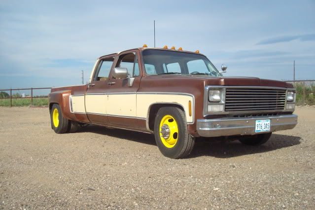

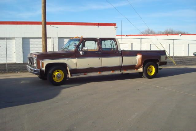

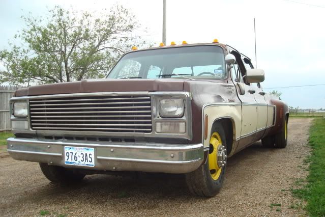

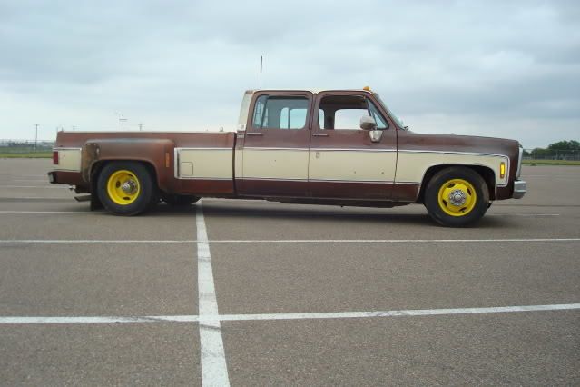

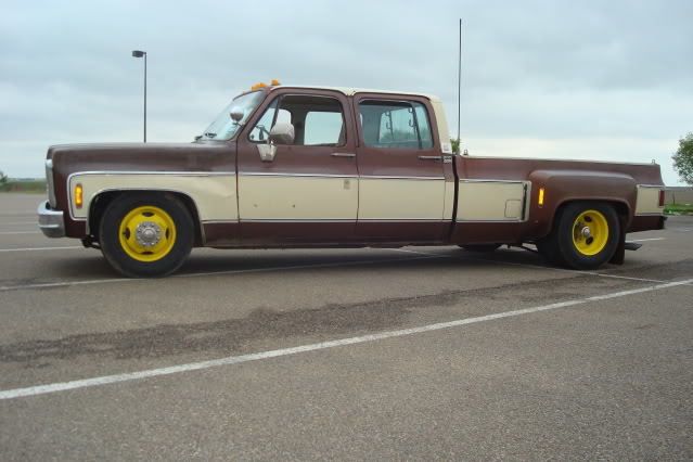

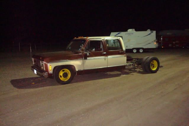

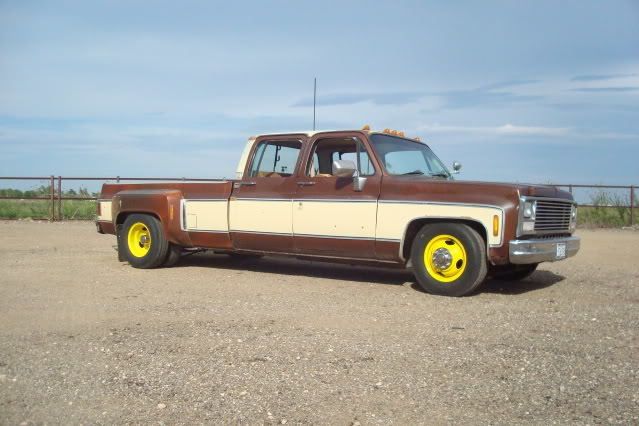

here are the recent photos of the dually before it entered my shop to get droped

Stock carrier bearing location is fine, I say keep the sway bar. Get with Campy on what to mod to keep it.
I had to lose the sway bar because of my custom flip kit for the C&C rear and because my new deep diff. cover would have been hitting it anyway. Truck looks good.

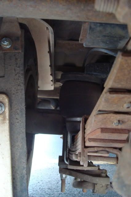

do i need to remove any of my leaf springs? its the camper special if that matters

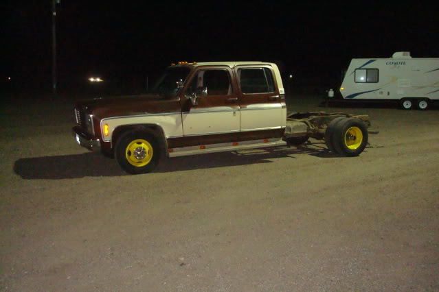

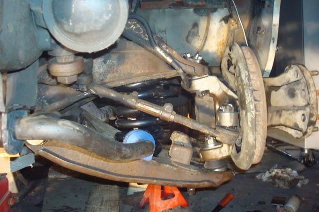

here are the updates for tonight
the bed bolts wasnt that hard to get out.....the gooseneck in the bolt was paint the nuts were welded to the frame which isnt a bad thing untill you add the 30yrs of rust that holds the bolt to the nuts...

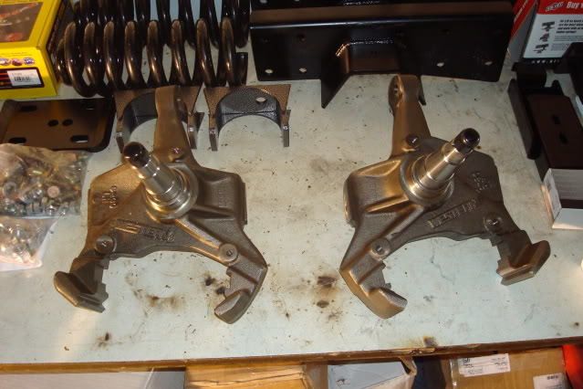

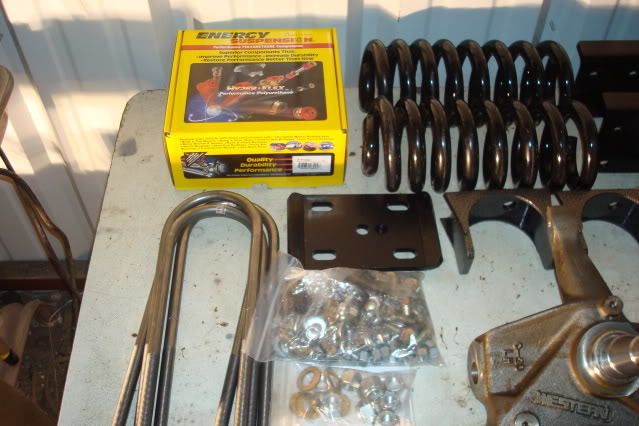

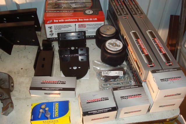

here what all im putting on it

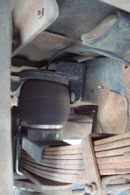

6/8.5 with the helper air bags
all new ball joint upper and lower
control arm bushing
sway bar bushing front and rear
body mount bushing
and im going to ditch the running boards so it should have a different look and hopefully ride better when im done with it

You only have to remove the top overload leaf but, I removed the lower one aswell for a better ride. Since you went with the helper bags you can probably remove more.

No I haven't pulled with mine. But, I might be putting my Lincoln welding machine (1,2000 lbs.) and some tools in the bed later at which point the over load leaves will be going back on and the spacers on top of the leaves will be removed to try and keep it at the same height. Luckily you have helper bags.

looks good man really diggin the color on rims
snapdaddy
thanks i wanted to stand out....
they didnt send the the bolts for the leaf spring pack or the diagram for the bolt holes on the c notch
so tonight i would have had the driver side all bolted up but i dont have the new leaft spring bolt so i guess tomorrow ill call sport truck direct and see if they overnight the bolts... im going to see if i can find some intown maybe at autozone or something like that
did anyone not get the bolt for the leaf spring in the rear?
