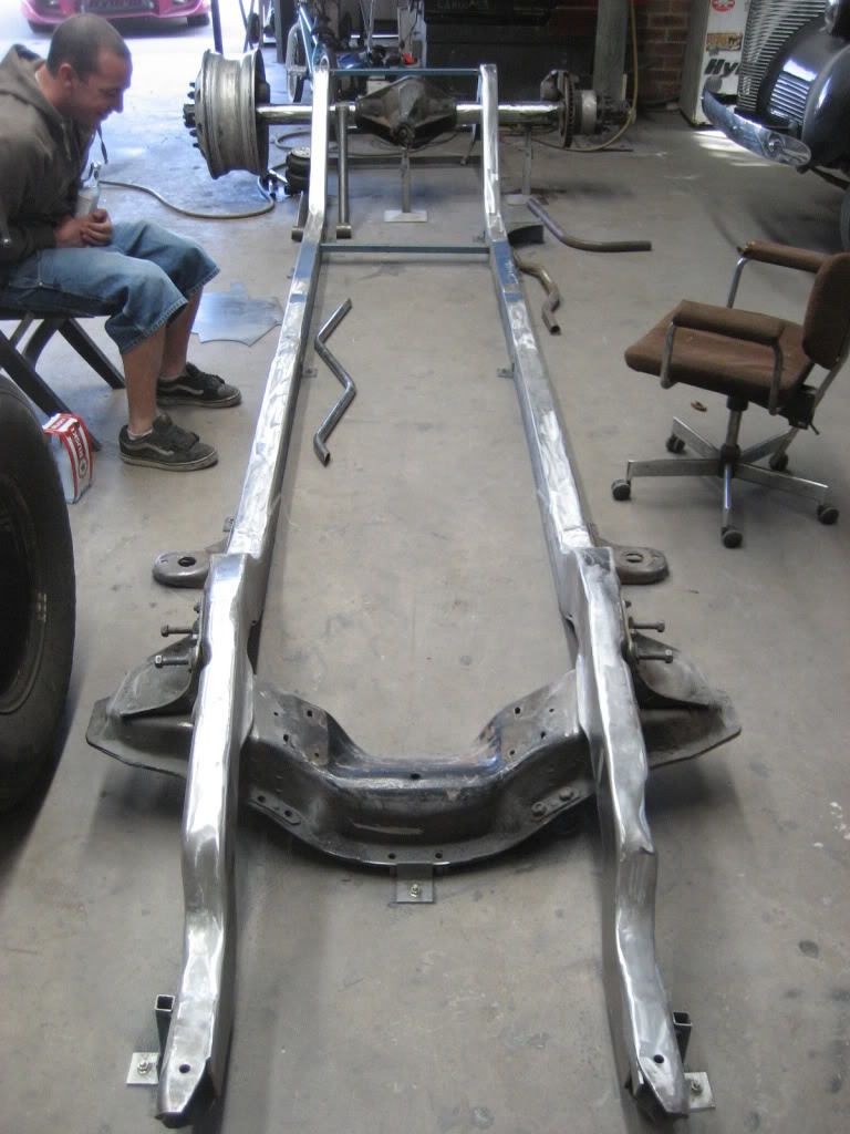

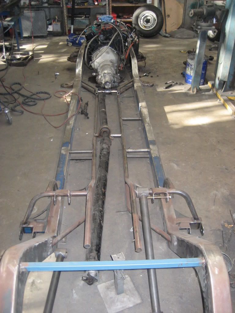

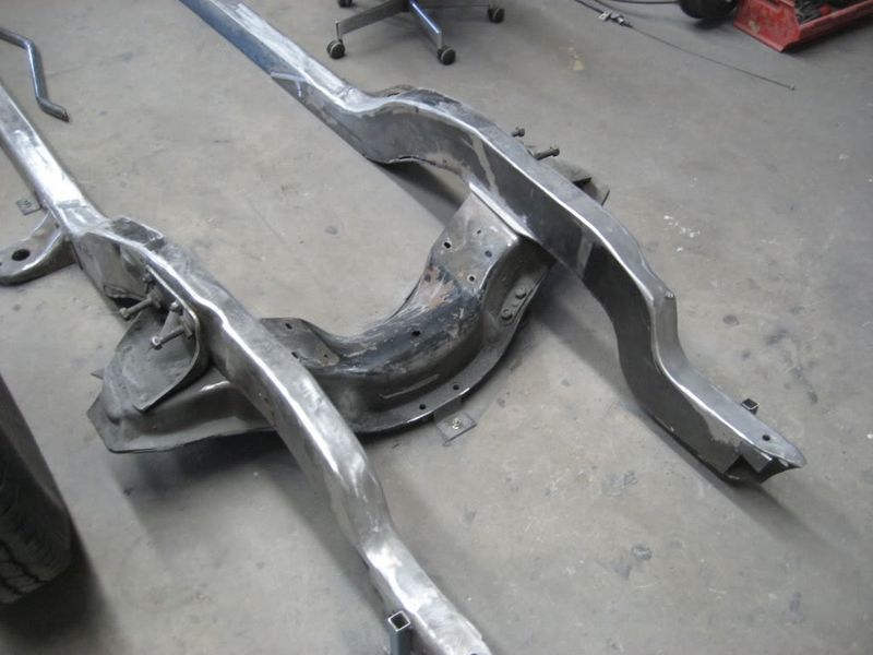

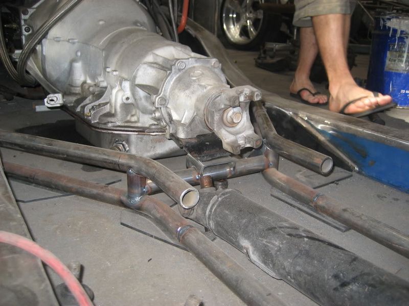

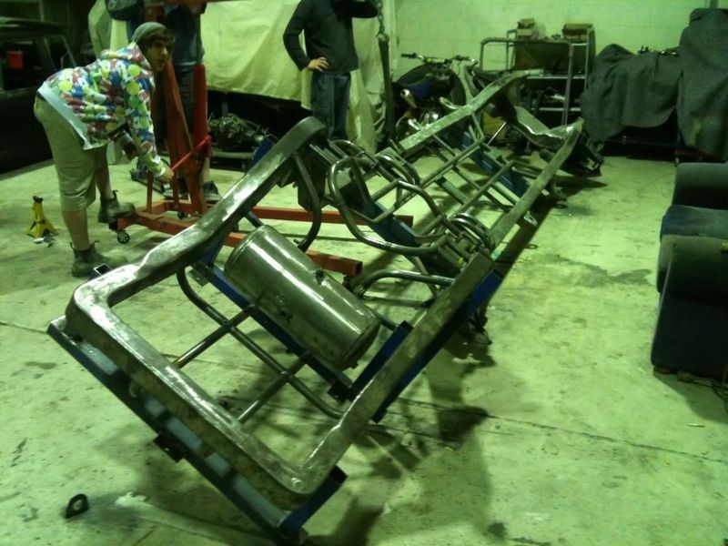

Hey Everyone !

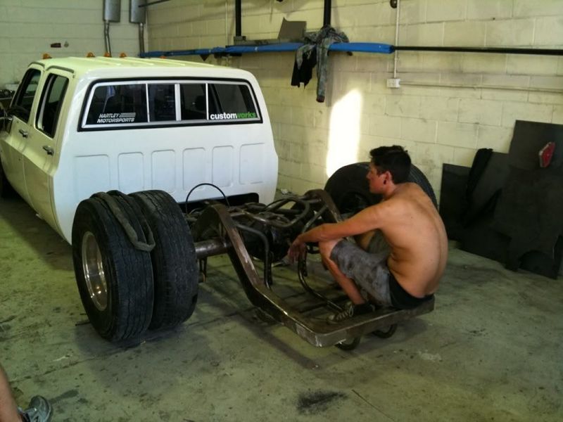

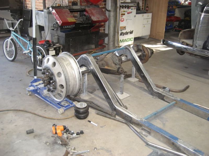

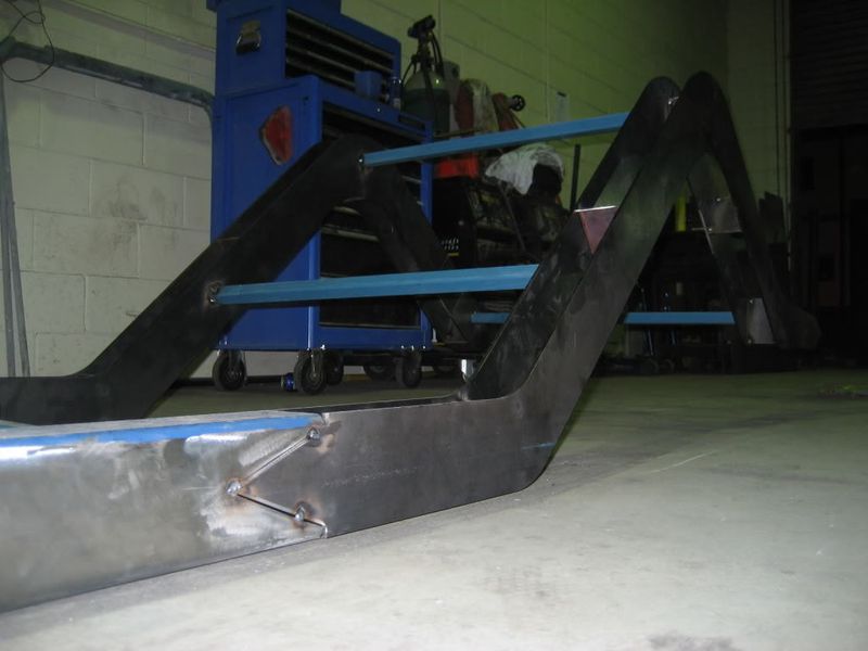

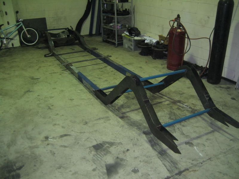

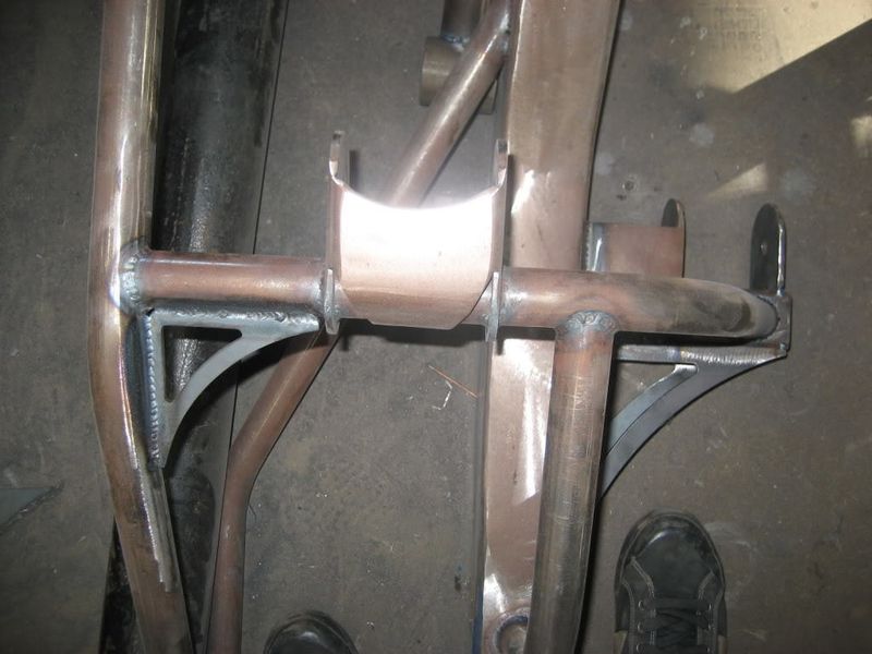

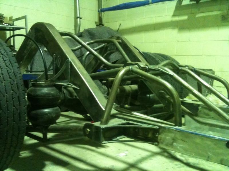

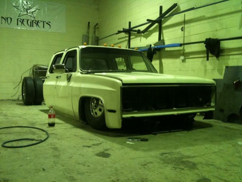

This is my 87 3500 shipped to australia about two years ago.

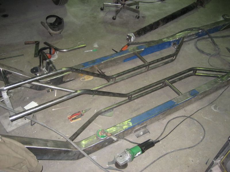

So far started full frame lazer cut frame rails , one off notch. Z is finished up front ... no control arms done yet ( ordered barley legal fabrication arms 12 months ago still waiting ) hhaha so not sure whats doing there ?
tube almost finished and four link finished so far.
truck will be BD to hard sill when finished
will hopefully be finished buy end of november ... here are some pics of where we are at .
cheers Rabit

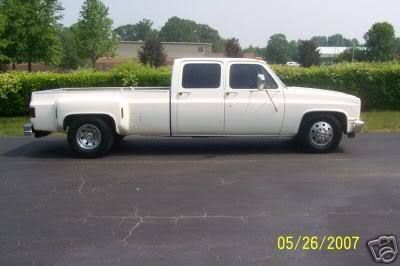

Me likey! sweet build, what is that rear from??

Frame looks nice.

the frame looks killer like it

Pretty wild, Holmes.

THANKS GUYS !
more pics to come this week ..
the rear is a stock 03 rear shaved back ...

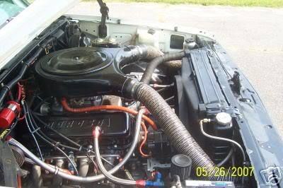

Looks real clean. Any details on the engine?

some info on motor for you wide load
The motor as it sits was dyno'd at 516hp
454 bored 0.60 over to 468 (4 bolt main )
CP pistons flat top
Crower cam : torque beast stage 1 '
Crower rods
moroso heads /roller rockers
eldebrock manifold
750 comp carter carb
billet James Burnes racing pullies.
