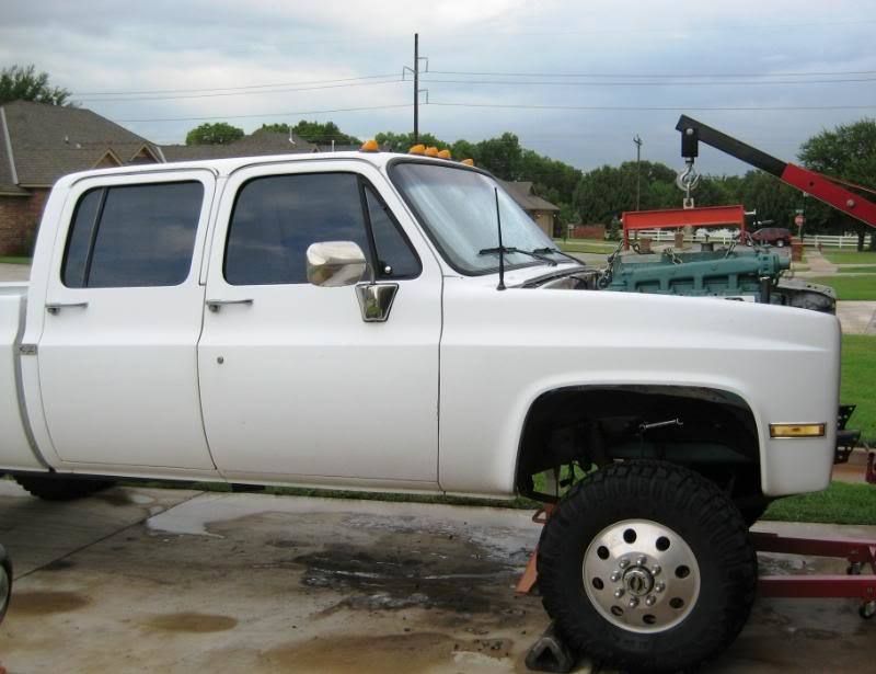

It's going slower than I'd hoped, but here are some pics of my dually. I'm swapping in an aluminum 4-71 Detroit Diesel and Roadranger RTO-610 ten speed transmission.

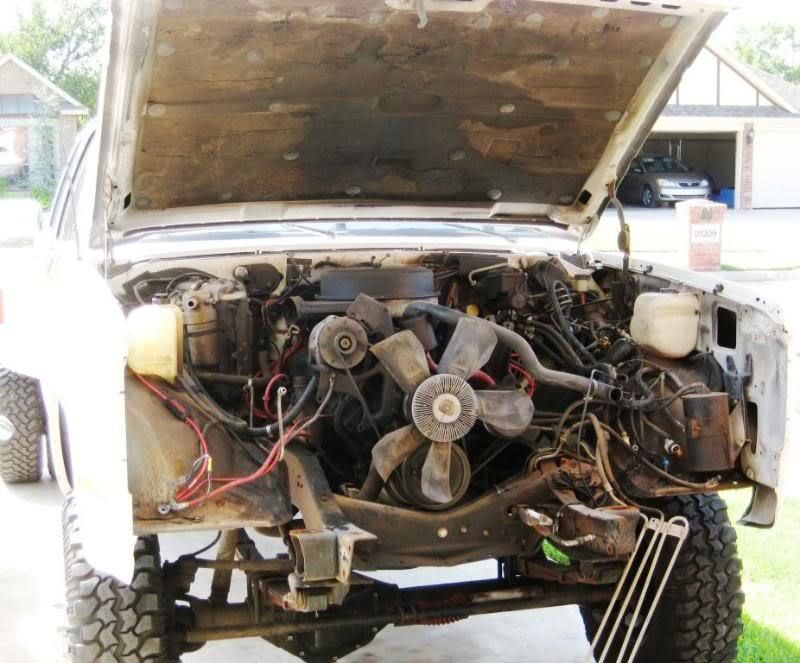

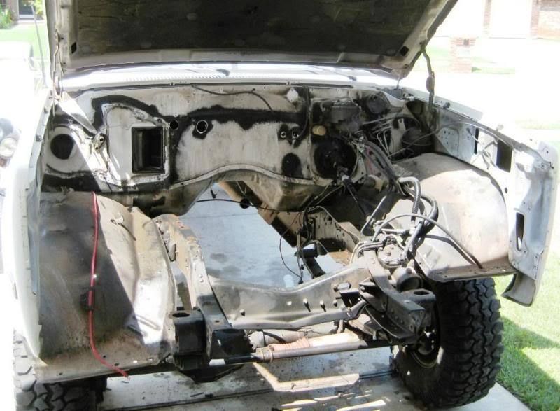

Here's the initial teardown.

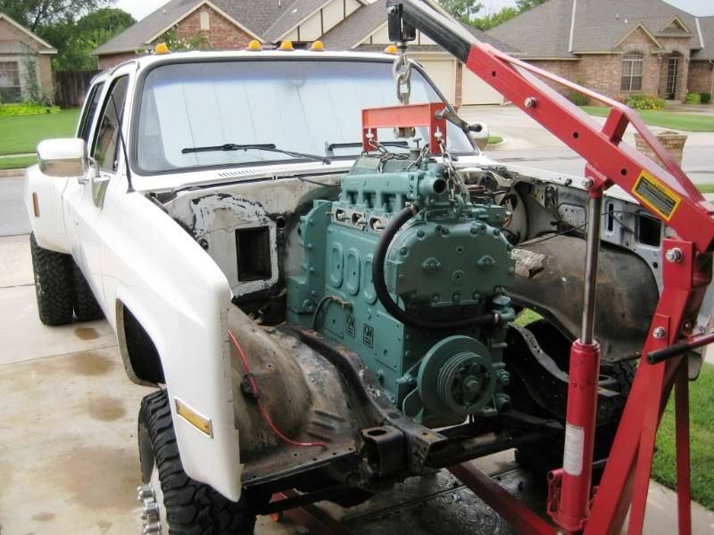

Here's a pic of the first fitment to get an idea of how the motor mounts will be setup and what I'll need to hammer/cut from the firewall. The engine will sit about 5-6 inches rearward and 1-2 inches down.

Looks good. Is a cowl hood going to be necessary? How much does the new engine/trans weigh compared to the average 454/TH400?

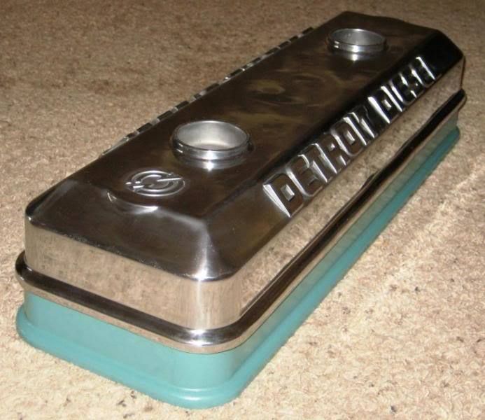

Thanks. I don't think it'll fit under a standard cowl hood and I don't want to do one of those 5-6" ones, so I think I'm just going to cut the hood around the valve cover. I've got a nice polished one that I'm putting on after the install is all done.
Anyway, the standard cast iron 4-71 weighs in at just over a ton. I found an aluminum block and built it up from there using mostly aluminum parts. I'm guessing it weighs only 100-200 more than a Cummins 6BT or about twice the weight of the 454 that I pulled out.

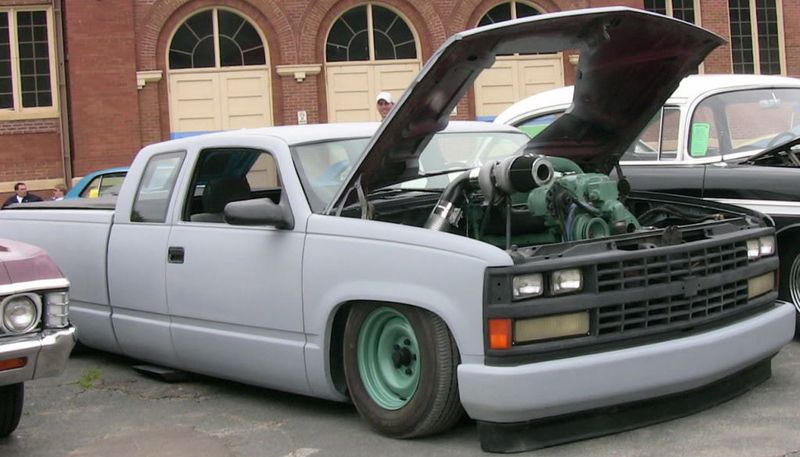

Or you could cut a really big hole like this guy did on his OBS
Something just incredibly sick about that ride, I love it.
