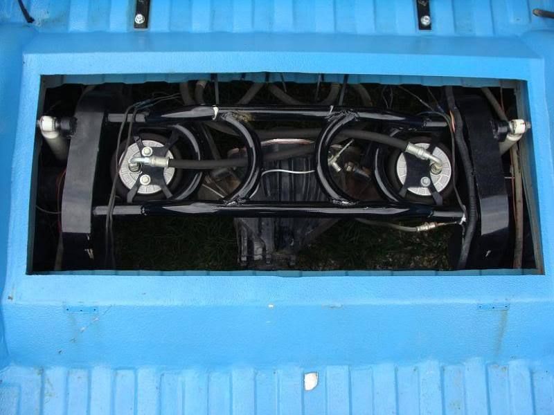

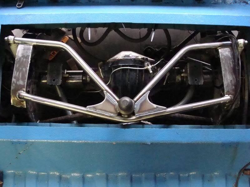

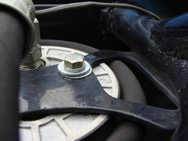

all but one dually ive worked on has been some shade of blue.... that uninteresting fact out of the way heres my good buddy daves dually. Dave said the truck swayed from side to side and the upper bag brackets are bending, the truck has been bagged for about 10 years so its just time to replace some things. The truck currently has a 50/50 link and tubular BOA bridge. Ill be doing a foward wishbone and redoing the bridge to incorperate a gooseneck mount.

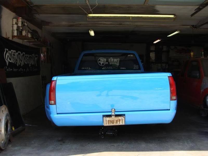

And the bed may be a lil crooked...

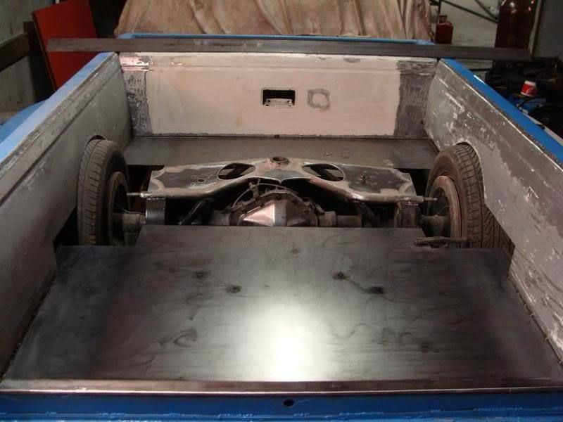

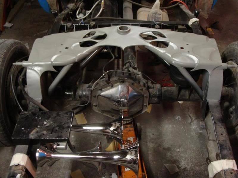

Gonna grab some 1/4'' plate at the yard tomorrow and finish it up. The bag mounts and gusseting should look interesting. Dave also gave me the go ahead to take it to Slamily this weekend so swing by the booth and see it.
huskerdually

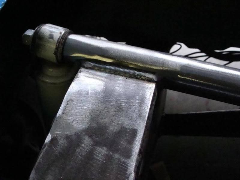

You're not to bad of a welder.

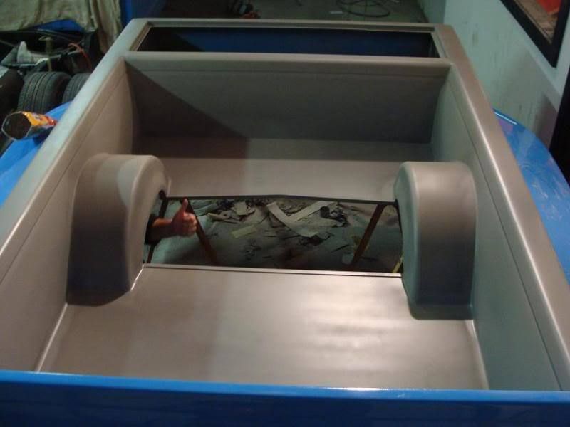

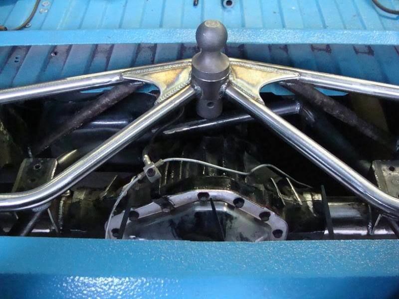

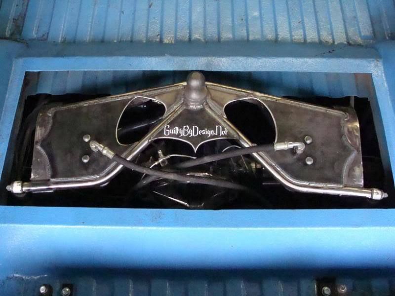

After 2 years of school and 5 building shit i had better be able to lay beads like that or i need to find something else to do. Heres more tho
Done

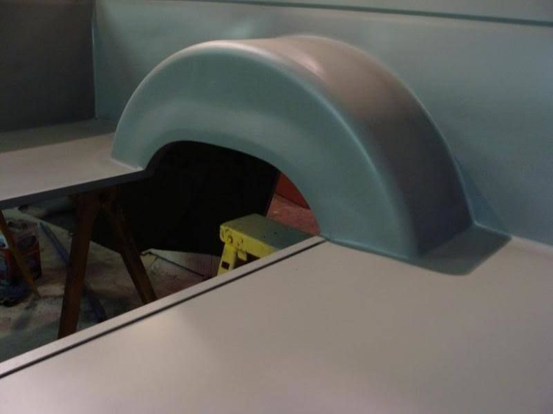

And since i had a wedge sitting there i just had to.
huskerdually
Don't we all.

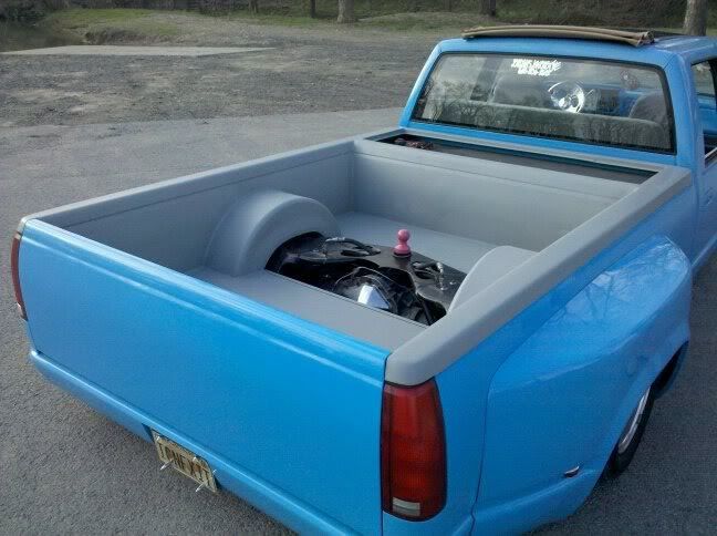

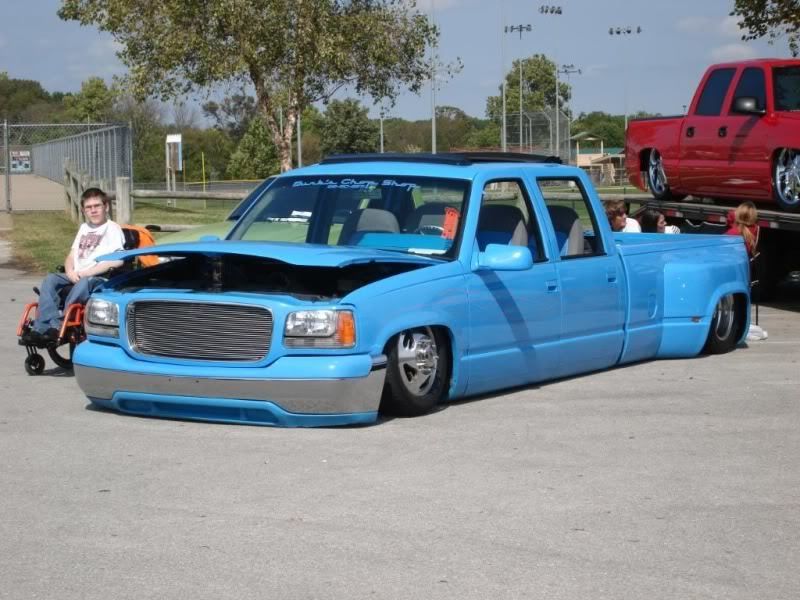

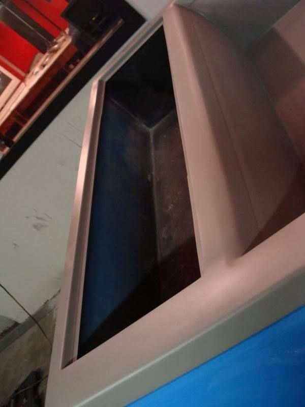

So its back, ive been holding off on updates since we will be taking it to tex mex. This pic is from tuesday....

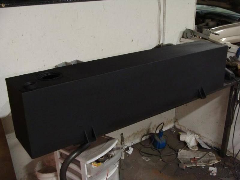

Ontop of all the bed sheetmetal we ditched the nitrogen for an 8gal and dual 480s. Were also relocating the front valves, replacing the bags with newer ones, adding trainhorns, building a 50gal fuel cell that will go in the "toolbox" alonng with a relocated battery. Also on the list is replacing the bottom of the frame from all the dragging damage, upgraded wiring for the valves, rebuilt throttle body with 90lb injectors, smoothed gooseneck bridge w/something special planned, and mabey some interior work too.

I like the body line inside the bed. Looks good.
tuckin22's avatar
tuckin22
looks good man cant wait to see it at texmex
